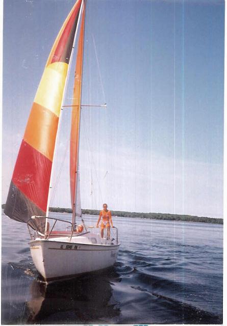

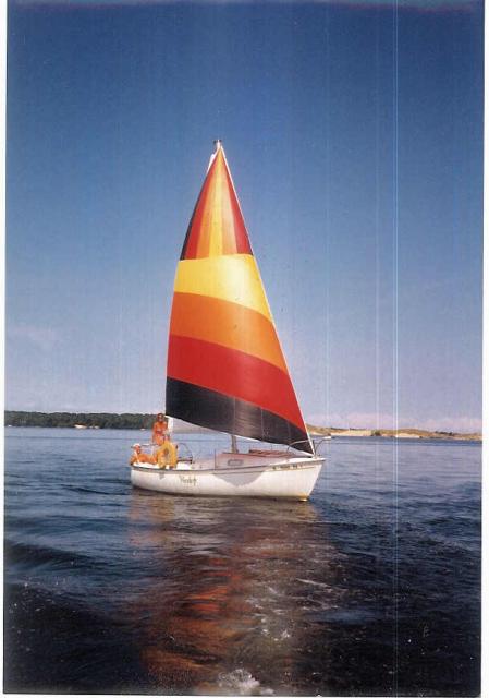

Don,I have a 3/4 oz hanked on drifter from previous daysailor{Chrysler 20] i would like to use on my 23.5 hunter with CDI furler.What I did was removed hanks,added double grommets along luff.I ran 3/16 coated stainless wire threaded thru grommets loop at tack and head,attached tack to eye pad behind furled jib,use jib halyard to raise sail using wire as forestay.Works great on those light wind day.?Wing it out with whisker.. Should I install halyard restrainer to protect jib halyard? Couldn,t see letting the sail just sit in bag.Maybe my terminology is wrong,but thats what they called it 20 yrs ago when I bought it from Sails USA at Annapolis boat show.I do not plan onfurling but raising behind jib.
