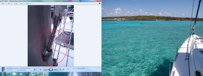

I've attached a pic of the piece that i need to replace and I'm guessing its resting at the base of my mast. Hopefully I dont have to remove the mast to put the replacement piece in?! Man am I kicking myself for not going up the mast when I saw it was loose! +1 for getting a system in place where Im not relient on having another person there to get up in those higher places.
Cheers,
-Jared
