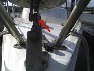

The adventures of Nice N Easy were well discussed. How does one lose a cotter pin on the forestay of furler? After the thread I took a closer look at my set up. What I noticed is the clevis pin movement on both my forestay and my furler were pulling against the actual cotter pin. Additional movement can easily snap the cotter pin and allow the clevis pin fall away. I will replace the cotters before the next sail. But, without reading the adventures of NnE, I may have never noticed. Excuse the photos, they were from camera phone. I'll post two images. Thanks Phil.

Randy, a clevis pin is supposed to resist load in double shear.
There are no loads intended to be transmitted along the axis of that pin or to the cotter pin that secures it. If the clevis is too wide for the pin installed (if for instance if you have to squeeze the clevis to get the cotter pin in the hole), then the clevis pin is too short and should be replaced with a longer one. The cotter pin should slip in relatively easy if the clevis pin is long enough. The cotter pin is a retainer only, not a load resisting part of the assembly. It is hard to see but, it looks like your clevis pin is just a pinch short. Oh Frank, those ring retainers catch on almost anything and they do rip out without your knowing it. I believe in cotter pins, properly bent, and taped. Have fun Joe S
