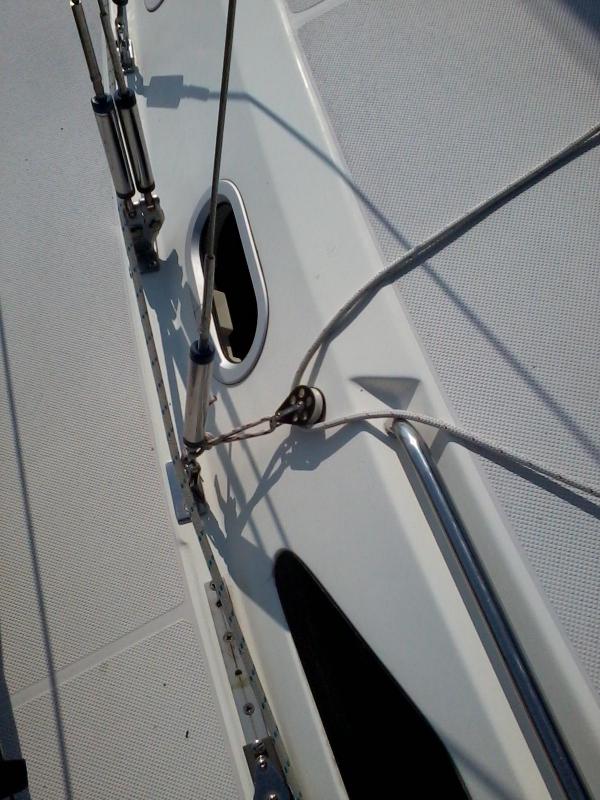

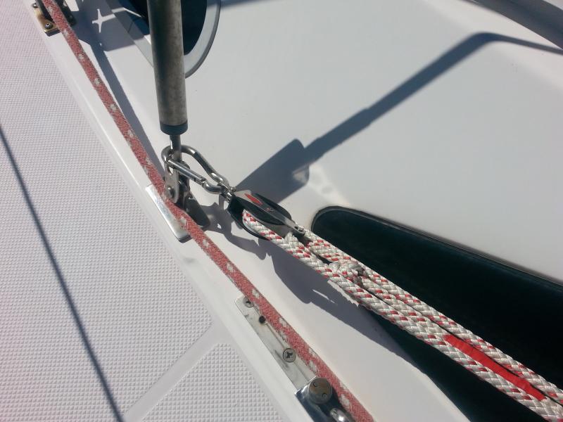

So I am sitting on the boat while we motor in no wind thinking. On one forum they mentioned using your shroud connections and tying the blocks off with line. While this does not get you forward of the mast, it does get the line far enough forward and it is solid. Then I thought that it would be nice to have both lines come to the same side so it would be easy to use. On Te-Keel-La, we modified our traveler after seeing how the 309’s have both of their lines led to the port side and we did the same. This has worked out great and it presented a new possibility as the original cam cleat for the starboard line was still there as I knew some day it would come in useful.

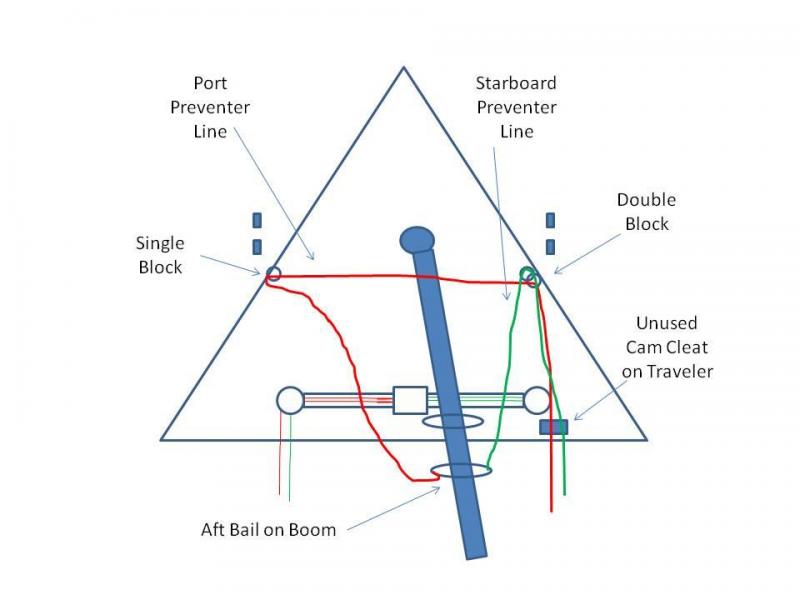

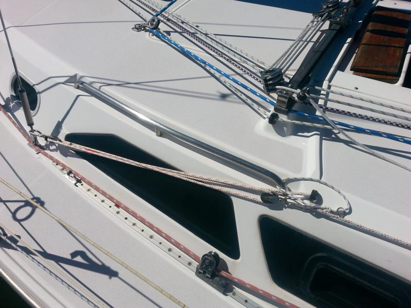

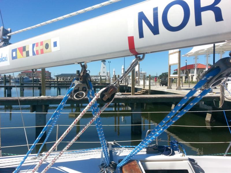

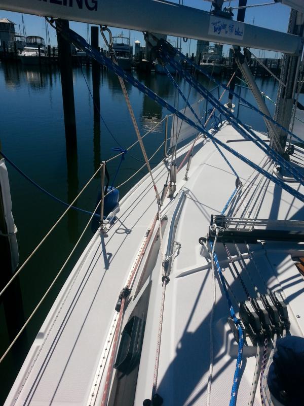

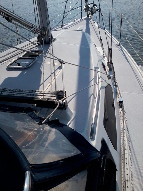

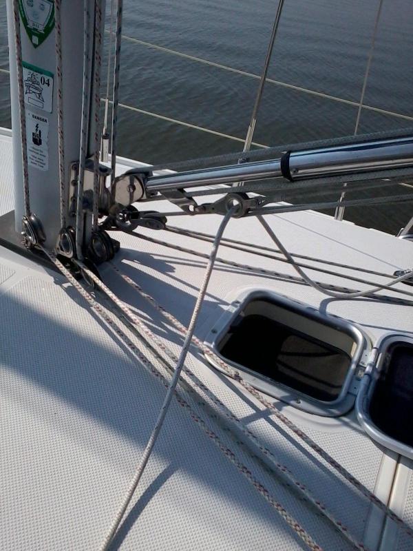

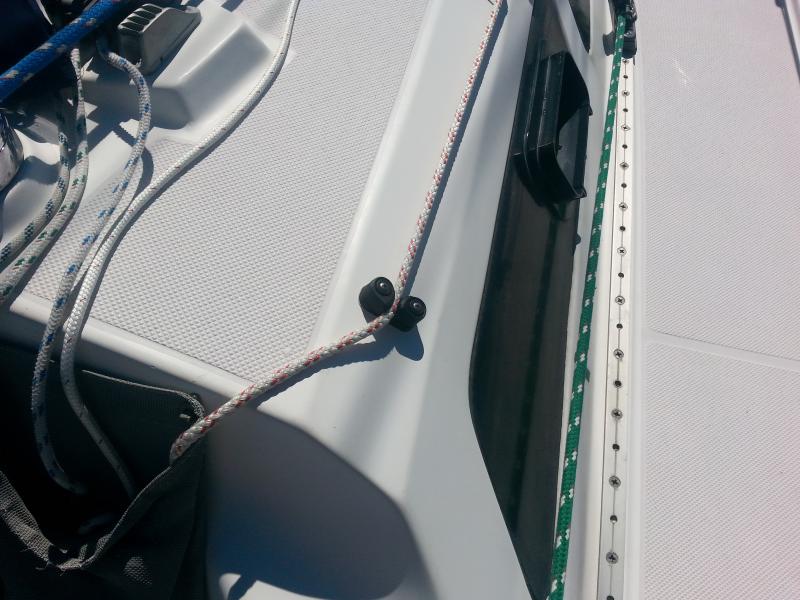

So this is what I am thinking. I use my aft lower shroud attachments on the port and starboard side. I use my cam cleat on the starboard side of my traveler as the way to secure the traveler from the cockpit. This also puts the line in close proximity to my main sheet so the person operating that can also work the preventer. I use the existing aft bail on the boom to get the preventer as far back to the end of the boom as possible. For routing lines I need to take the port side line and run it to a single block and feed it to the starboard side and a double block so that it and the starboard side line can be fed back to the cam cleat.
Attached to this article are some pictures that show the deck layout on Te-Keel-La and a drawing that shows the entire configuration. Thoughts?
