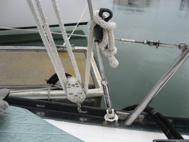

Update to Previous Post and More General Info
Malyea:
I visited my boat yesterday to make sure everything was closed up prior to the expected heavy rains last night.
When there I looked at my aft-stay tensioner fiddle block attach point and saw that I didn't quite do it as I described yesterday.
Attached is a starboard side pic of the small fiddle block and the shroud cleat:
1) The block is attached to the toe rail, not the U-bolt. (But I did use the u-bolt on the other side.)
2) The shroud cleat is mounted only about 1 foot up. From the picture, you can probably visualize that it's a good "in-line" pull up and cleat off by the helmsman in the cockpit. Also since the bottom side of the cleat rests against the top of the fitting into the turnbuckle, it won't ever slip down any further.
Here's a link to the Garhauer (block manufacturer) website showing pre-made assemblies for backstay cincher type tensioners:
http://garhauermarine.com/catalog_process.cfm?cid=70
The first of the two appears to be for using rope into the subsequent block purchase system. The second is for wire rope.
