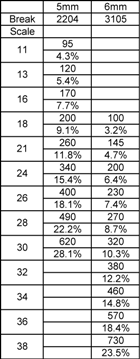

I have never come across any documentation or suggestion for optimal tuning for racing. I just ended up tightening the uppers to a fraction of the wire capacity. The uppers are 5mm and the lowers are 6mm. I went with less tension with the lowers, because being bigger than the uppers, if I went to the same fraction of the wire capacity, I may be taking out all of the pre-bend in the mast. Check out Selden Tuning for more information. I bought a metric tension gauge, which has the tables for metric wires. I target around 25 on the gauge for the uppers. Below are numbers I found somewhere, which do not exactly match the table on the gauge but are close (it's been a while, but I think this is more accurate as I have it taped on the backside of the gauge (numbers are metric)).
I think I take the lowers to a reading of 26 to 28 on the gauge. I do get some sag on the leeward lowers when sailing in reasonable wind so maybe I should notch it up a bit. It would completely eliminate any mast pre-bend when at dock, but it might not be quite as bad while sailing. As I'm not really racing the C275, I haven't gone hog wild on perfecting the tensioning so maybe someone will chime in with better numbers.

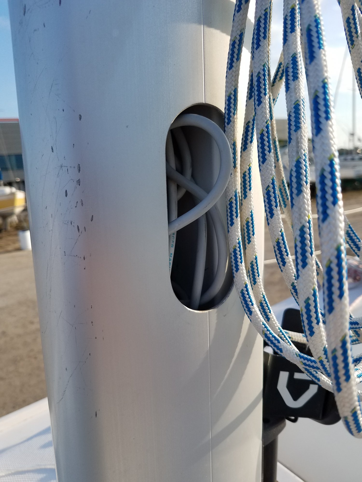

No, there is a plastic cover that belongs there. Can't give you a picture as boat is in storage. Not sure if this was a Catalina install or a Selden install. I'd check with Catalina first and Selden second, or if you feel lucky, reverse it.

Ok, did some research for you and came up with Selden part No. 540-026. Google Selden "540-026" and you will find places that sell it. Toad has a picture as well. Got the part number from page 111.
You can thank me by buying me a beer next time you are in Chicago. It's only $3 at our club.
