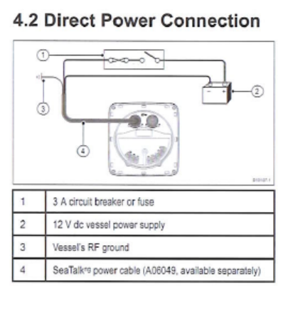

I am finishing the installing of a new depth finder. The power cable has a red, black, and a non shielded silver wire.
The installation guide (below) tells me to connect it to the vessel's RF ground.
I am not sure what it is? Sorry for the poor image. My scanner has decided to hate me......
