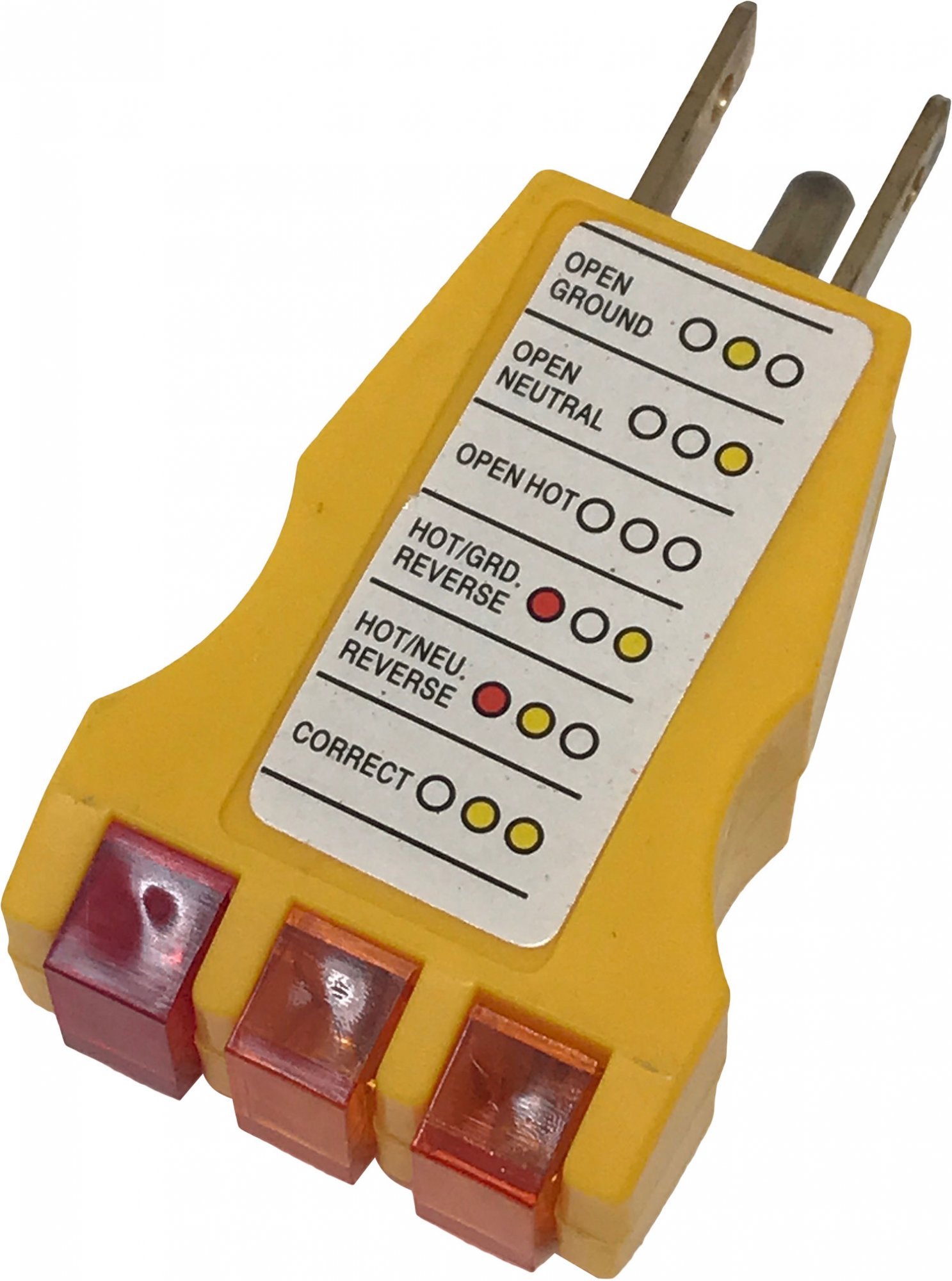

Check that the prongs on the plug of your shore power cable are not fitting loosely on the outlet at the Marina power pedestal. A loose contact can trigger the "reverse polarity" warning. I usually carry a plug in tester to check the polarity of the power at Marinas before I plug in the boat. (nothing more that a regular household 15A outlet tester plugged in to a 30A to 15A adapter). The problem with reversed polarity is the danger for electrical shock from an ungrounded wire becoming hot. Alternate Current switches direction and it should not affect the operation of the appliances. Now some smart battery chargers may sense the reverse polarity on the supply side and turn themselves off as a safety feature. There are now too many smart fixtures in electrical systems that bring up faults that in years past would go unnoticed. There is no way we can tell whether the fault lies at the Marina or at the boat's end without testing both ends. Reverse polarity should not turn everything off, have you installed any GFCI outlets that could be tripping?

Inside the boat, if you have a DVM (Digital Volt Meter) or even an analog meter, you can test any outlet to determine which side is hot and which side is neutral. You can do this also outside, but inside the boat is where you really are concerned about.
As you are looking that any outlet there are three plugins. If the ground plugin is on the bottom then the (might be) long plugin on the upper left is neutral. The hot plugin is on the upper right. With your volt meter, check between the hot and ground. You should get 120VAC. Checking between the neutral and ground will result in 0VAC. Checking between neutral and hot will result in 120VAC.
You can also check to see if your neutral and ground are connected together. Check with an ohm meter. Between neutral and ground you should read 0Ω. If you get something like OL, or no movement of the meter then there is no connection.
