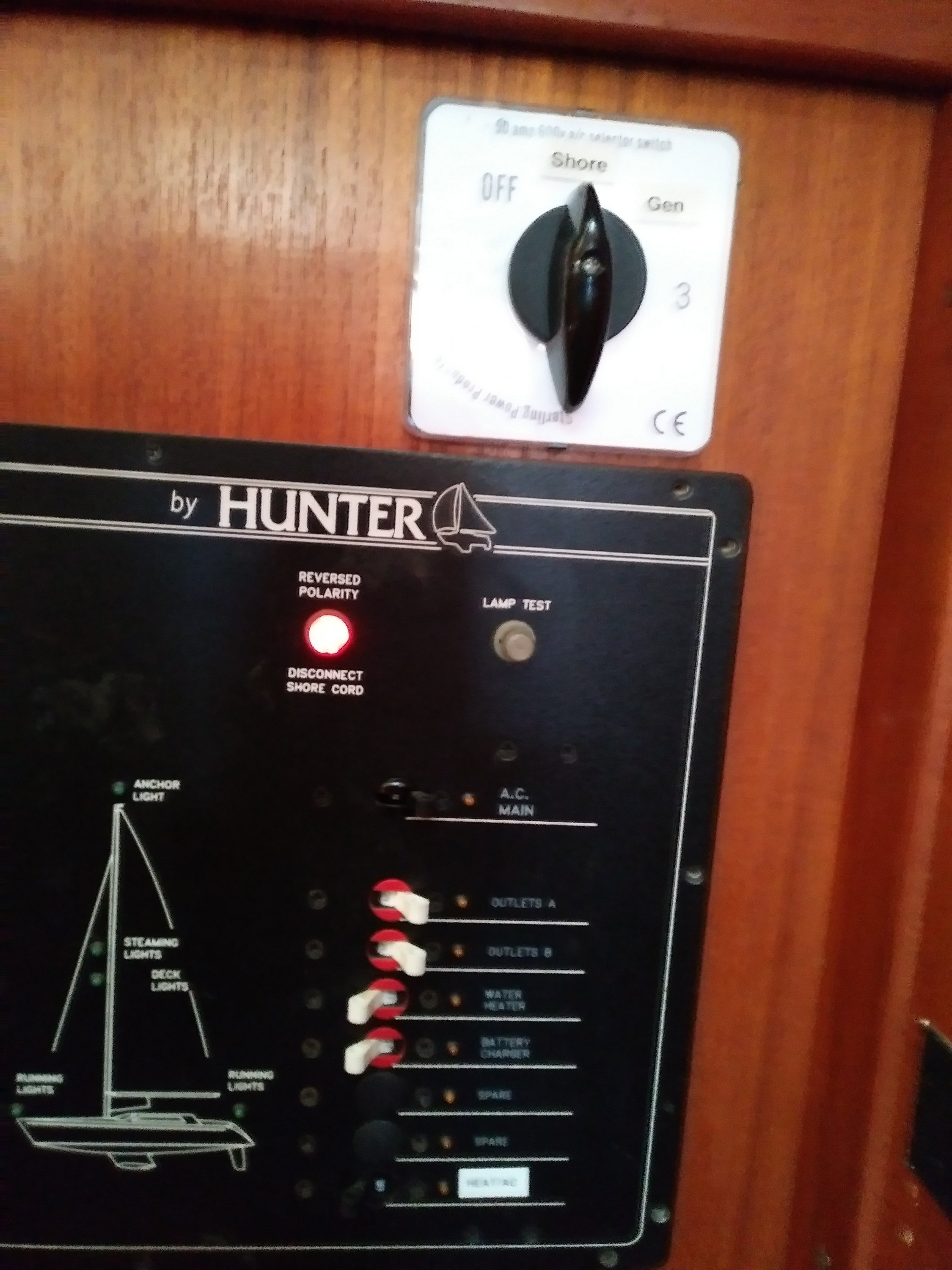

Working on boat yesterday (no electrical work) hooked up to shore power at yacht club. Checked polarity before hooking up (pushed test button with no beakers closed on boat - light comes on) - everything fine - turned on A/C heat (reverse cycle heat pump), battery charger and AC outlet (plug in) breakers. Still everything fine. Plugged in a household vacuum (Dyson) and began cleaning up and vacuumed for about 5 minutes, everything fine - after awhile vacuum stopped and I noticed Reverse Polarity Light on. Immediately tripped AC Main breaker, and switched AC Power Surce rotary switch to OFF. Turned all AC breakers off and rotary switch back to Shore Power. Pushed Reverse Polarity test switch and light came on "dimly". Closed AC main, no light. Then closed various AC load breakers. Each time I closed a load breaker the Reverse Polarity light came on brightly. Tripped Main AC breaker off and AC source switch to OFF.
Then I started the Generator and switched the AC Power Switch to Generator Power. Pushed Reverse Polarity Switch and light came on brightly. Closed AC main breaker, no light. Closed Battery Charger, A/C heat, AC plug breakers. No Reverse Polarity Light, everything worked fine, including the vacuum - no problems noted. This would seem to indicate to me that everything on the boat was okay and the problem was probably at the Yacht Club power source? Does that sound right?

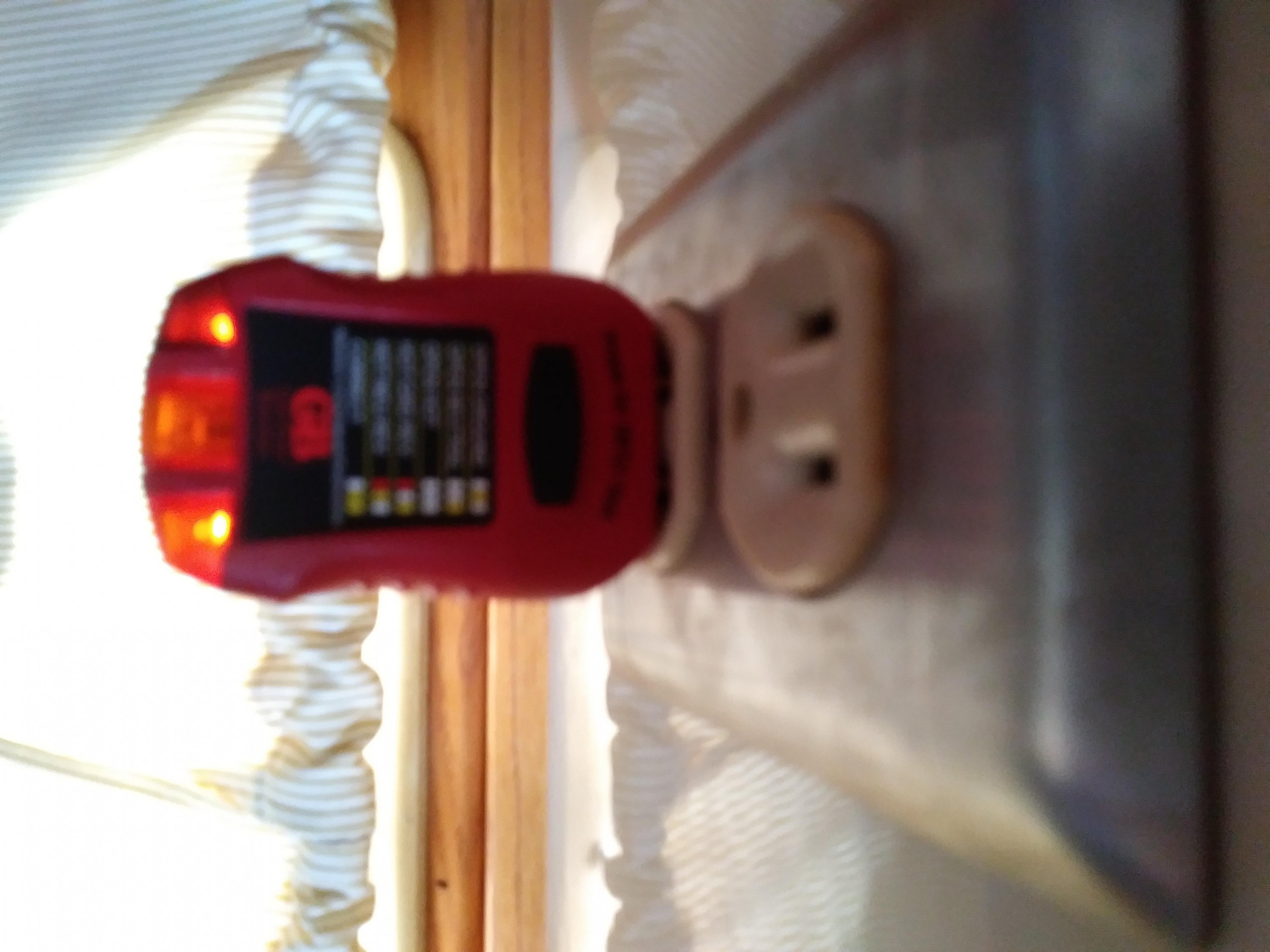

I have a new (2 year old) Smart Plug on the boat and a "Factory" Smart Plug shore power cable. (Marina end is an old style plug though). I checked the voltage and resistance at the shore side pedestal. I'll have to figure out which of the plugs prongs is supposed to be hot and which is neutral and which is ground. I'll make some sketches this evening and post my results. I plugged in a tester to an AC outlet on the boat with shore power connected. It showed "Hot and Neutral reversed". When I started the generator and used the the same plug it showed "all normal". I'll post some more info this evening with pics, etc.

Thanks all. I used a Volt Ohm Meter on the shore side AC plug. I found the diagram from SG and checked it against the shore side AC plug On the diagram from SG, going clockwise from the Ground (G) it is supposed to be Ground (G) - Neutral (W) - Hot. What I measure indicates it is actually wired clockwise from Ground (G) - Hot - Neutral. So it would seem that the Hot and Neutral are reversed. This is consistent with what I showed on my handy-dandy plug tester. The pic of the tester is blurry but the two lights corresponds to Hot - Neutral reversed. I notified the Yacht Club manager this evening. Not sure how it got that way though since it was working properly earlier in the day?
