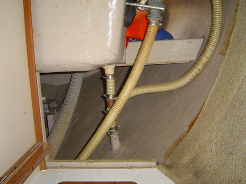

you can pull the rear bulkhead in the quarter birth assuming you have a 9.2a ...and change out the manual pump there...the pump is a guzzler brand that you may be able to get here on SBO.....good luck....

The rear bulkhead is removable, You start by removing the outboard panel in the quarter berth to allow the rear panel to come out. It is not complicated, but it seems to be more involved than it should be. Lots of screws and the panel may have wires through it so you either slot the panel to remove them or work around the loose panel. I cut the panel and took it out of the boat so I could work.
I have two manual pumps for the aft bilge and an electric pump for the forward bilge. Does yours have two bilges? The manual pumps can be rebuilt, most marine stores should have kits to do it.
When I replace my YSE12 with a larger engine I cut the side bulkhead and removed it to get better access, then I spliced it back in.

here is a pic of the bulkhead removed ....this was copied from the yahoo s2 site and pasted here to give you a visual of the bulk head removed.....
