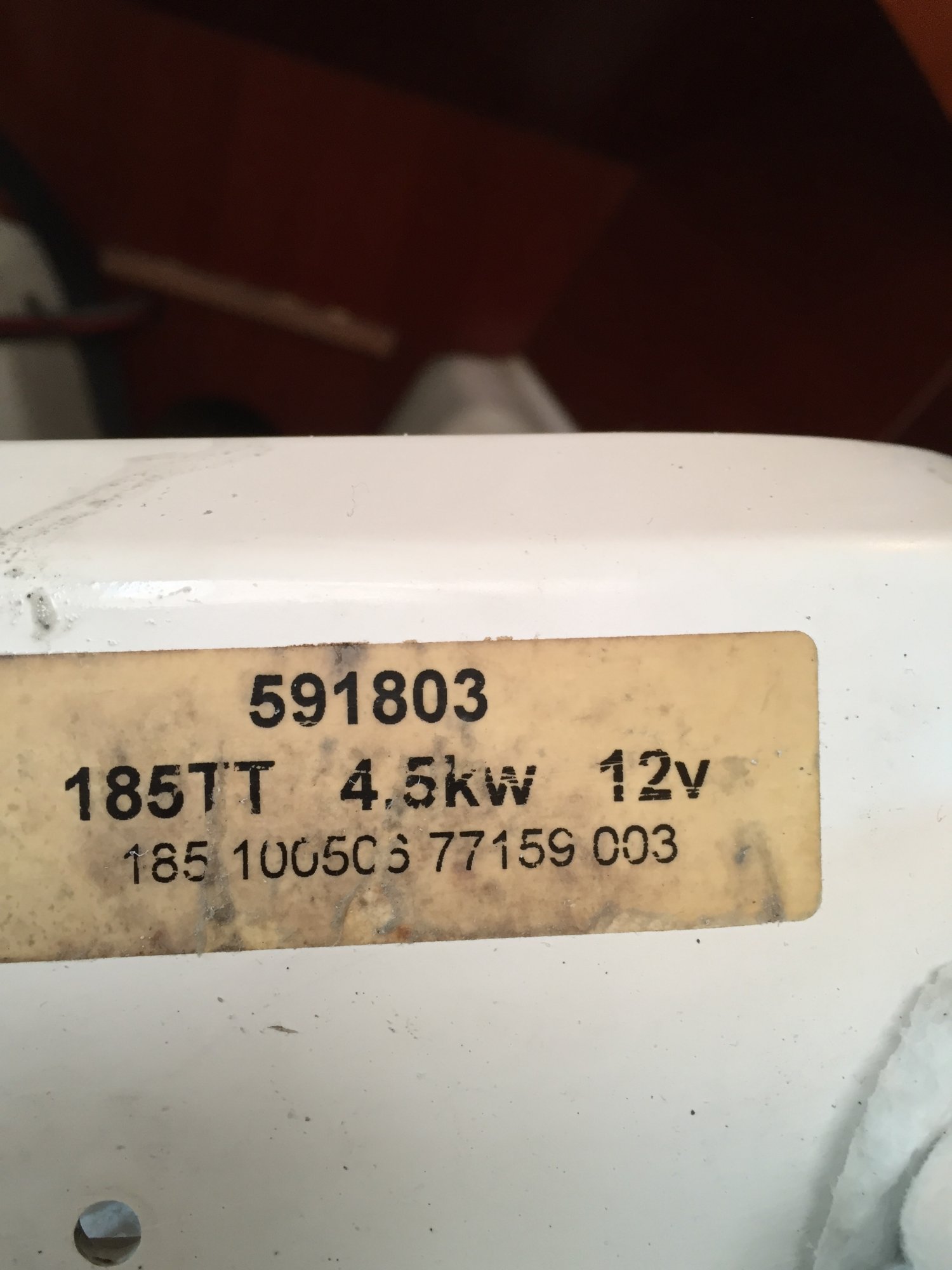

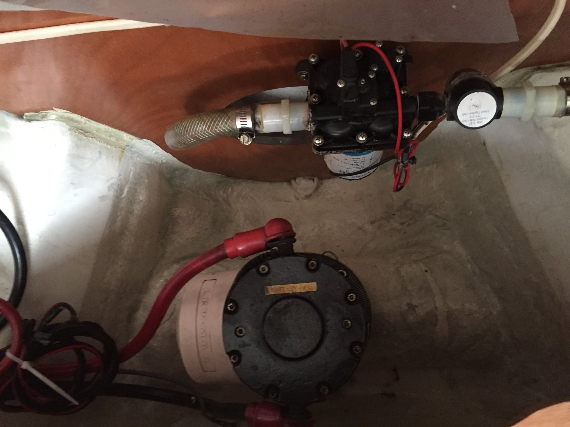

On my 423 the thruster is forward of the water tank….. in the next compartment. It’s a lewmar. It came with the boat and is wired to the house bank. So large wire leading forward along the port side of the boat. Works fine.

You may find the installation easier and less expensive if a battery is installed near the thruster and it is charged with a battery to battery charger. The big savings will be in the cable and the labor require to install large cables.
