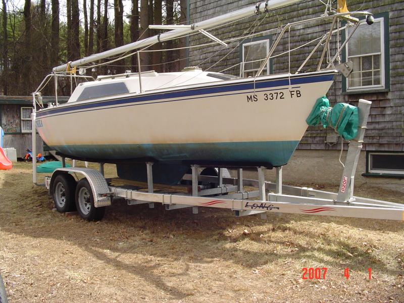

First Steve, I'd buy a two speed Fulton Winch. Then I would buy two guides like the ones on my trailer. With these, you wouldn't need keel guide boards unless you want them. I've never had a need for them.

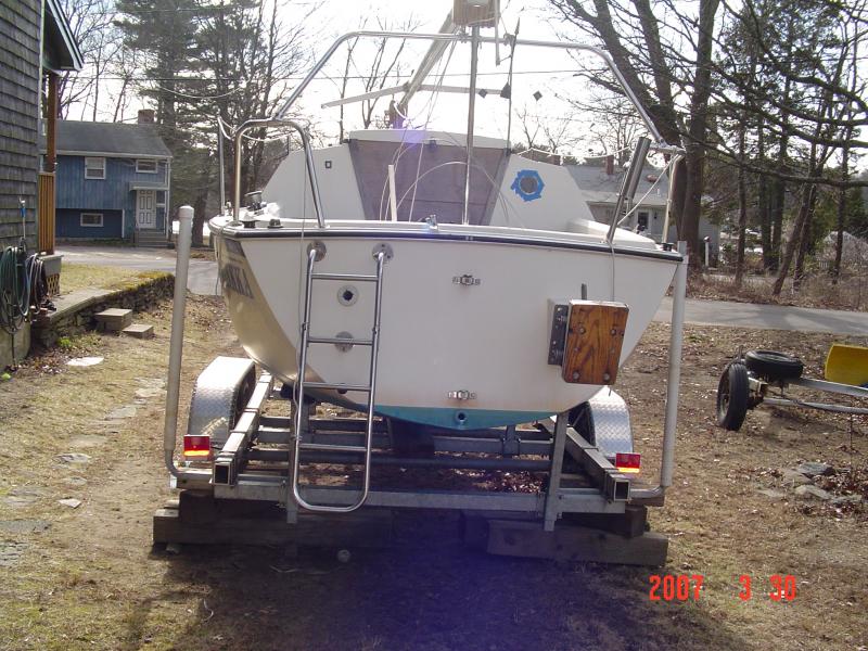

My boat is approximately 22' long but my trailer was made for a 23' boat. Luckily I've been able to launch the boat and retrieve it without swamping my truck. The winch stanchion on my Long Trailer is located inside the trailer's A frame. If you buy these galvanized guides, they come with 2" PVC pipes with caps on the ends and they are designed to roll on the square stock tubes and prevent the boat's hull from being marred. The guides need to be set up for the widest beam of your boat. When trailering the boat too and from the ramp, you should remove the PVC pipes so that the caps don't get broken when going over bumps with the trailer. That's about it.
