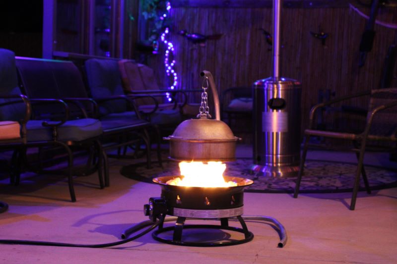

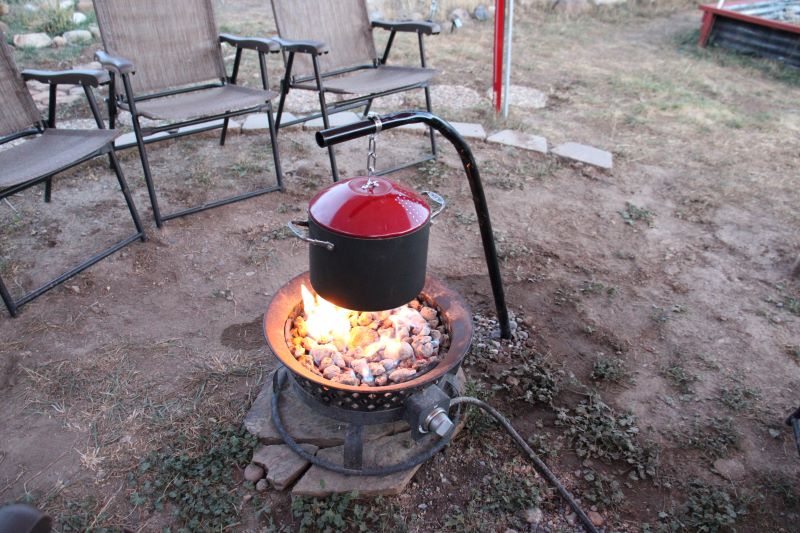

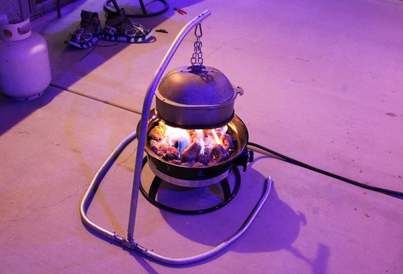

We use propane fire pits which radiate heat from the flames to people sitting around the pit but a lot of heat just goes straight up with convection. So.. for not really a good reason, Ive been playing around with a couple "contraptions" of pots I bought at thrift shops and placed above the fire pit. The idea is that the pot above the fire pit gets very hot and then radiates some of the energy that would have just escaped back at folks sitting around the fire pit. Why the different pots.. just what I found at thrift stores.

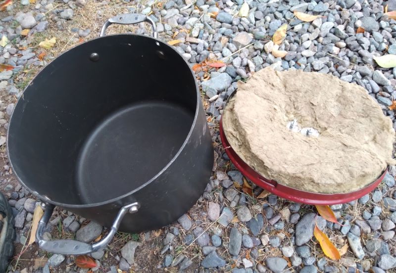

Blackbody radiation just depends on some emissivity coefficient, temperature and surface area. So the pot above the fire pit just has air inside (not trying to store any energy, just get the pot as hot as possible) and since I really dont want radiation off the top, put in high temperature insulation under the lid. Holes are also drilled in the lid to make the dang thing doesnt explode from pressure and the pots dont get hot enough to glow so stay under melting temp and way under where metal burns. Does it work.. maybe a little, maybe its mostly just some funky experiment LOL.

It looks like you have a perfectly good patio heater in the background. Those are designed to radiate the heat downward…
Just use the fire pit for ambiance (or roasting marshmallow).
I have the same problem though…my nice fire table does not really push heat outwards. You have to hold your hands over the flame to get heat.

Without a doubt, the most high tech campfire I've ever seen. You might want to photograph it with a an infrared camera to see what your high temperature surfaces are like.

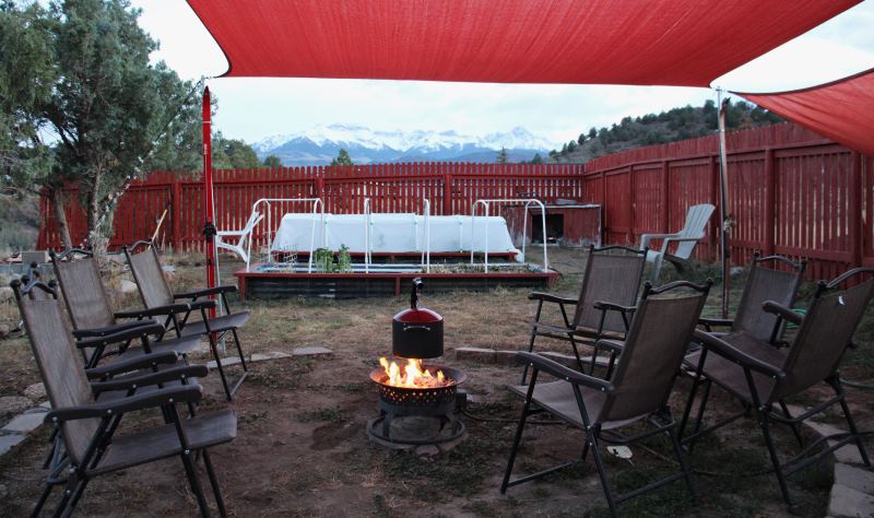

Looking at the photos, I would likely feel perfectly warm with the fire out.
There is no snow in those photos. Here, in the land of actual cold... we just build a bigger fire, with wood, and while staying in one spot, rotate ourselves like marshmallows.
Using wood, and rotation, solves the heating problem.

I have a hand held IR thermometer that only goes to 100C and it quickly pegs the limit so the pot gets hotter than 100C. Recently I ran the fire pit hot, shut the fire pit off and turned off the lights to see if the pot was glowing, it was not. So I think pot temperature is under 500C. Aluminum melts at 660C so that isnt an issue. When the propane fire is extinguished you can still feel significant radiation from the pot..
The only test I sort of plan to do is sometime when the pot is hot and some folks are sitting around it, somewhat quickly move the pot away (only can be done with the version using the free standing stand) and see if the people around the pit notice any difference. All the heat is radiation to the results will be felt immediately but of course still subjective. Will this mean much.. Hmm.. and those testers likely will have been drinking...
Used the medieval looking pot last night (in Arizona) and someone asked what's in the pot?
Tally Ho, your guest seem to be pleased with the heat!
That's what I meant when I said to measure..
Objects spaced away from fire/pot at consistant distances.
Unbiased, identical stand-ins for humans. Something similar in mass to humans.
Use your thermometer to measure them, not the pot over the flames.
If you want to be really fun, get some sensors on sticks in the ground at chair height. and log the data.
Worst case the thermometer would work by just testing the surface of the humans, but that would lower accuracy. Likely more accurate than subjective opinions though.
That tarp is a huge help in trapping the heat. If you had a bigger one in a dome shape, it would trap the heat more. Propane avoids the smoke issue that we have to adjust for when having a wood fire under a tarp roof in the cold.

The comment about the high temp insulation is good and something Im a little concerned about. I have used both pots in the pictures a fair amount with some type of "high temperature wool" insulation rated to 1200F (650C) and so far, there doesnt seem to be any strange outgassing or burning issue. The medieval looking pot is getting used now and I will open it later and inspect the insulation.
Neither pots get hot enough to glow so I think they are staying under the 1200F temp. There likely is a better choice for the high temperature insulation which is ceramic fiber blanket rated to 2400 F.
