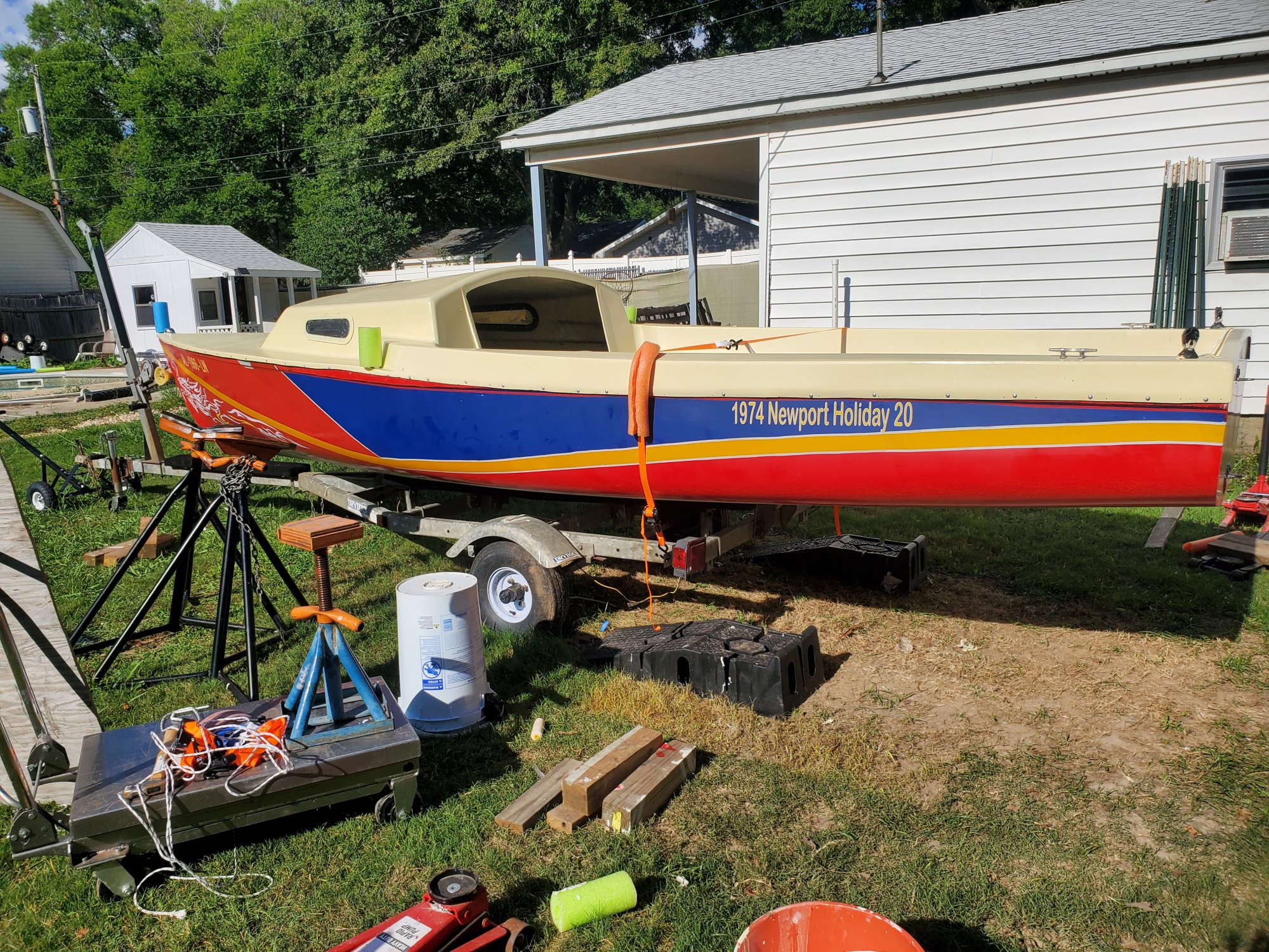

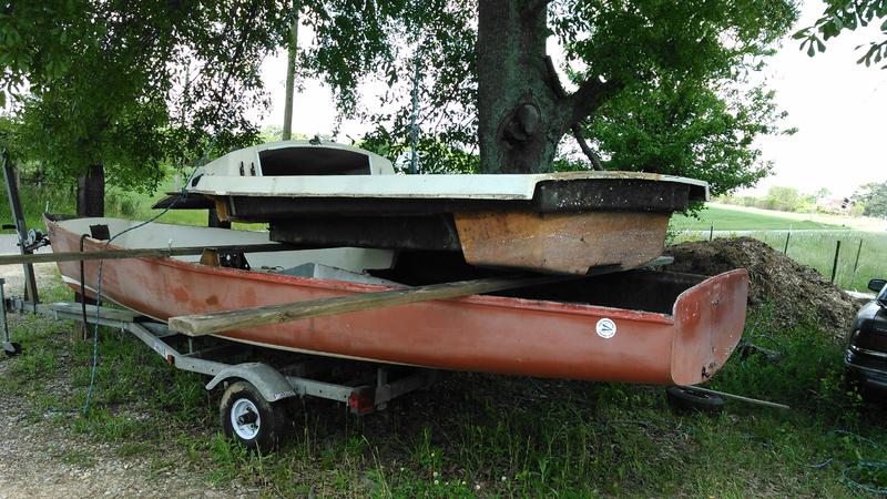

well after three years of buying new parts and paint we are restoring sonictide, our Newport holiday 19/20. I thought I would post pics of the teardown to show others and post pics during restoration. any suggestions are welcomed. this will be my first restoration. my husband has helped his father his whole life with a 52' Atkins ketch and a few other sailboats so this is my son,13, and my first restore. .this will be a complete refit. all screws, turnbuckle bodies and cleats will be replaced with bronze( my hubby is very salty....) I'm using 1/8 swageless fittings and currently working on rudder since its too hot to paint.

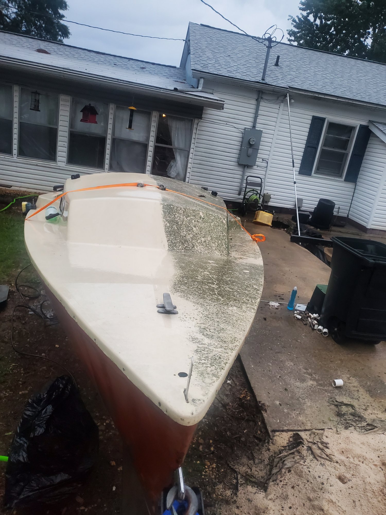

Other pics are the "new" boat, post first power-wash.
The 19 appears quite similar, other than "port hole" shape.
1. How are the top and bottom parts put together?
2. How did you get it apart? Don't know as I will go that far, but, it's tempting... I can see the pieces of foam down inside mine through a small deck plate - looks like quite a bit... Good!

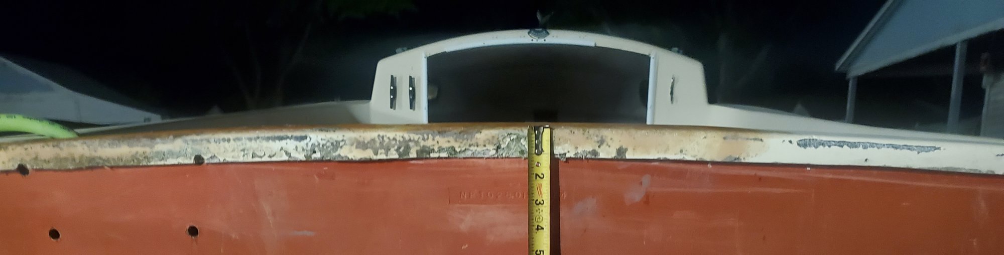

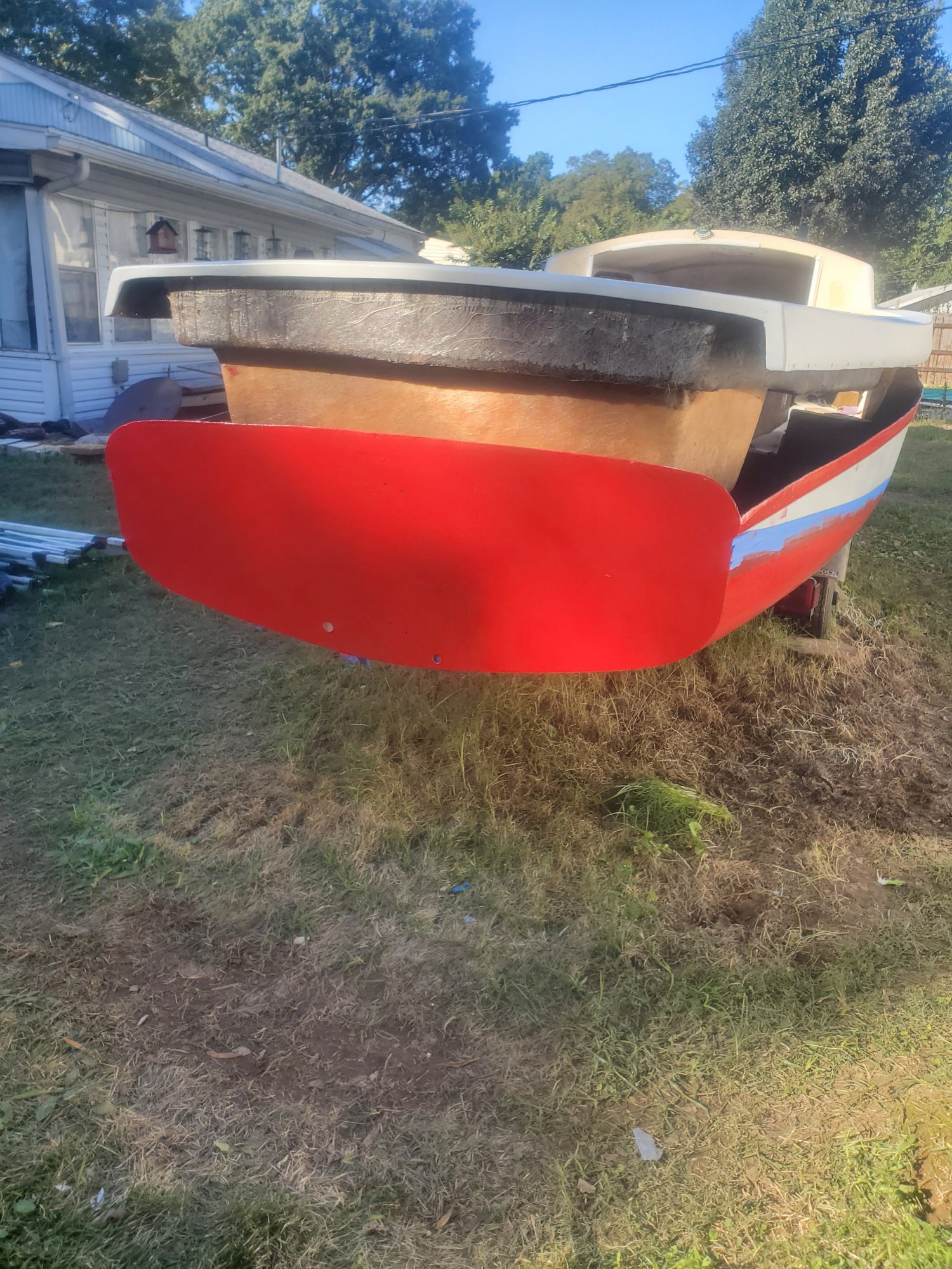

taking apart is simple. There is a rub rail you gently pry it off and under it is rivets. Take drill with small bit and drill rivets out. Then we hoisted top off with block and tackle using big tree limb as hoist. There is a second layer under it held by 3/4 flat machine bolts I just took drill with screwdriver head and took them out. It was light enough that it came right up with help of my son and husband. You will have to unscrew and take off the keel hoist in order to get it to separate and four fiberglass tack points. I used utility knife to cut those since there was little rosin. Remember to mark those are so if you paint the inner hull with bilgekote not to do those areas because you will need to reattach the lower hull to the middle deck. May end-up doing - don't know, yet?

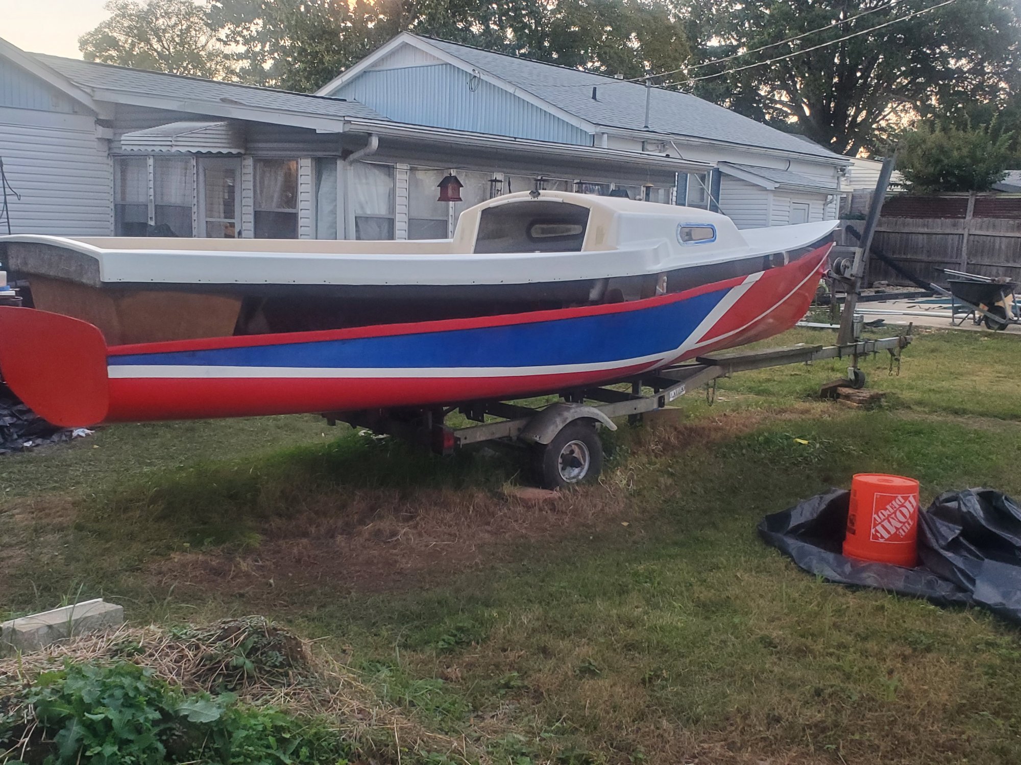

hello sorry it took so long for me to repost. i had a major accident last year and just now getting back to restoring my holiday 20.
I will be using interlux perfection paint on top and vc performance on bottom. i have already put the first coat of grey bilgecoat inside the bottom inside hull because i realized while sailing water acculated in there. I am replacing cleats with bronze herreshoff 6" from hamilton marine and have spent the year collecting various bronze fitting for the boat.

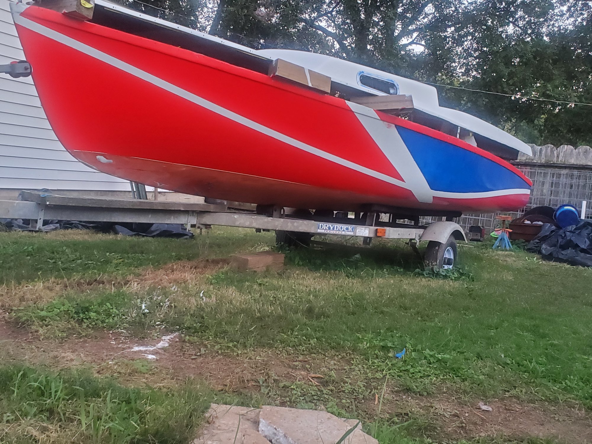

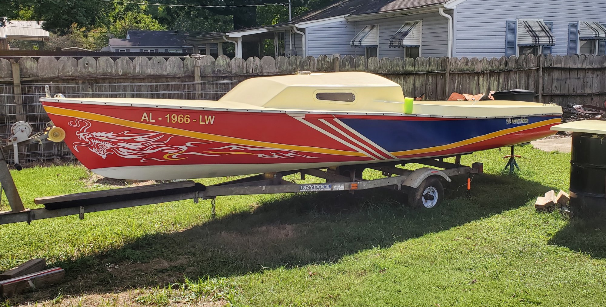

Better late than never right even if it took five years! Finally got back to refitting Sonic Tide. Just started the new paint job and waiting on the material to make new sails. I ordered a new rudder from ruddercraft.com back in July for a end of Sept ship date but its delayed 5-8 weeks due to waiting on stainless. Any questions I will try to answer
