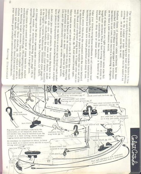

Patrick Royce's excellent book, Sailing Illustrated, is wonderful book for you. We got it when we bought our 1981 C22 in 1983, before the internet. Covers the C22 in great detail as well as everything else you need to know about sailing. It is a wonderful introduction as well as a true "keeper." Fair winds.

Stu, thanks!!! I looked on ebay and there are many editions of that book. Can you tell me what edition you have or recommend?
23,501
I bought it in 1983, so you could work from that. I don't think the text has changed very much, but I am aware that for some unknown reason they changed ALL of the text to BLUE in later editions; most likely to reduced xerox copies (my guess). It's much easier to read in black & white! :)
