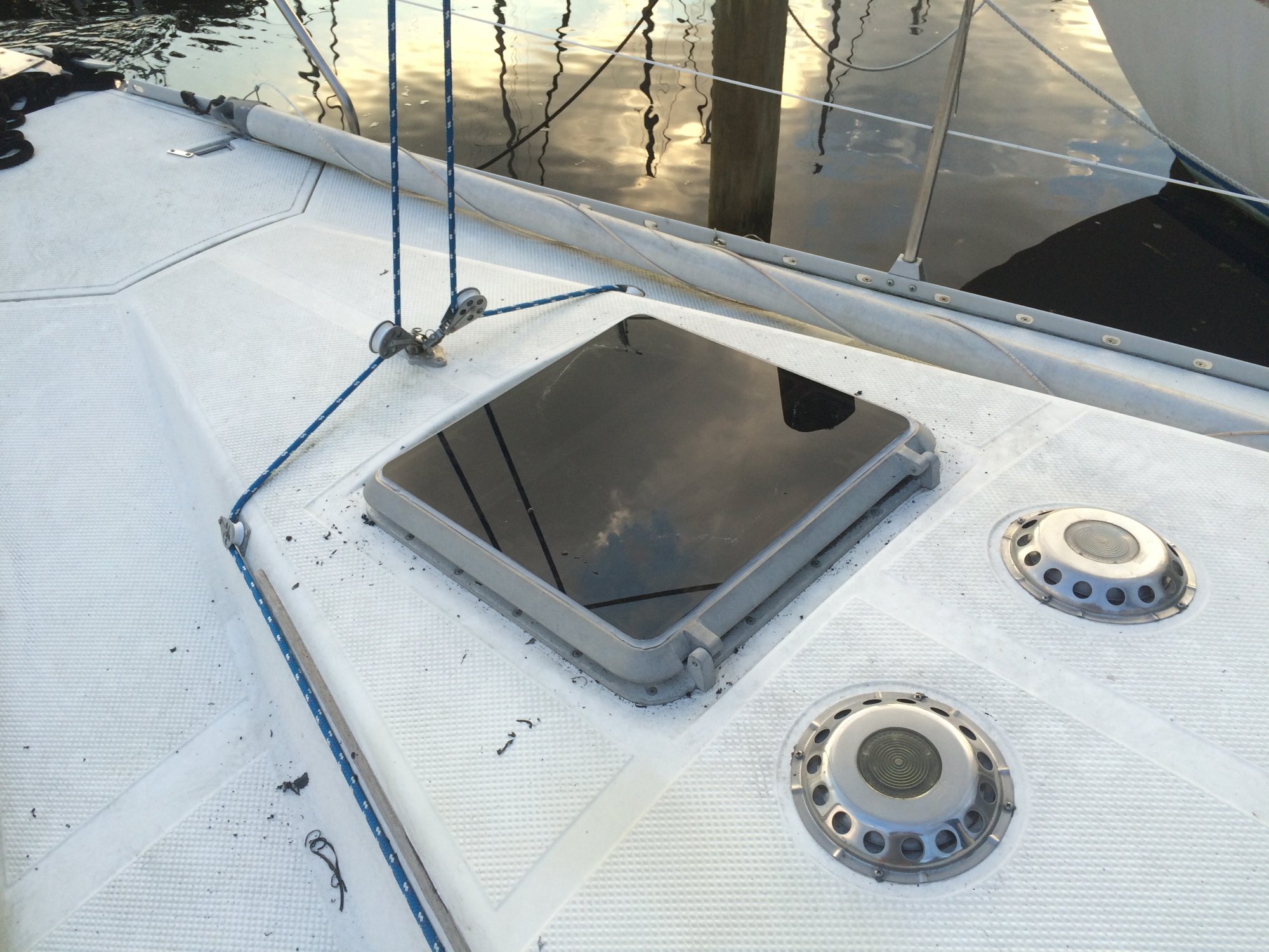

10,255
Interesting note:
The Bowmar hatches on my 1985 do not have gaskets, the lenses are bedded in the frame with sealant. I replaced the lenses 9 years ago and rebedded them with 795. All good.IMG_0527.jpeg
