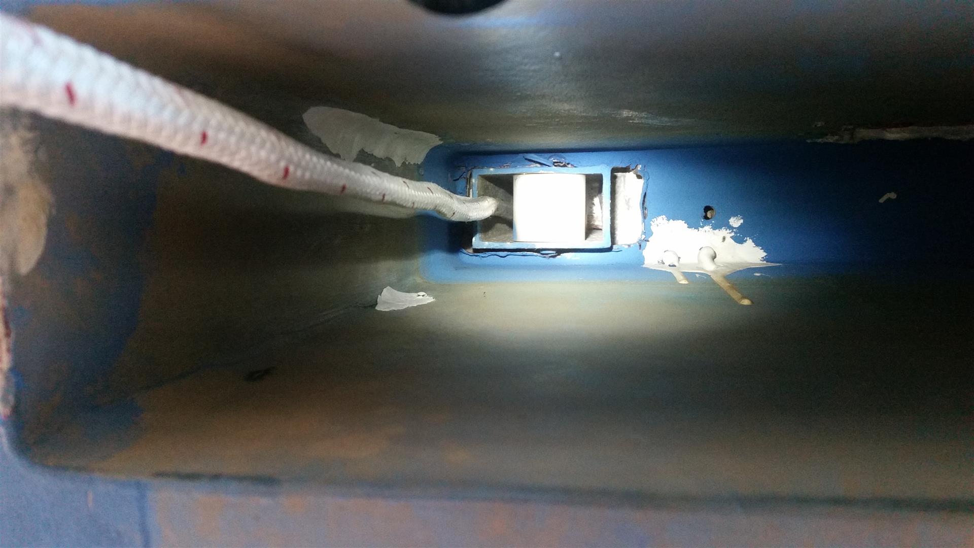

With the keel removed I looked up in the keel trunk at the underside of the winch box and this is what I saw
The white stuff in the corners is a water activated epoxy we put on anything we thought might be the leak when we had it in the lift for the second time. We were close to the problem but no way we could have fixed it from below. The bigger issue I now know is where the winch box attaches to the trunk. The hole around the winch is larger than it needs to be for and aft and there is a hole drilled in the top of the trunk that is just open. I can really tell much so I have to get the winch box out.

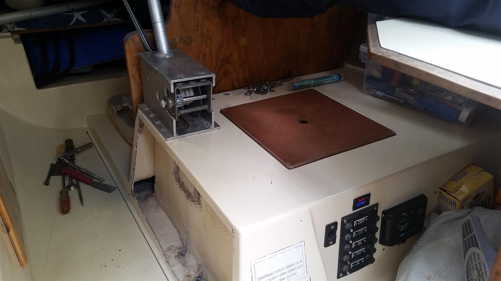

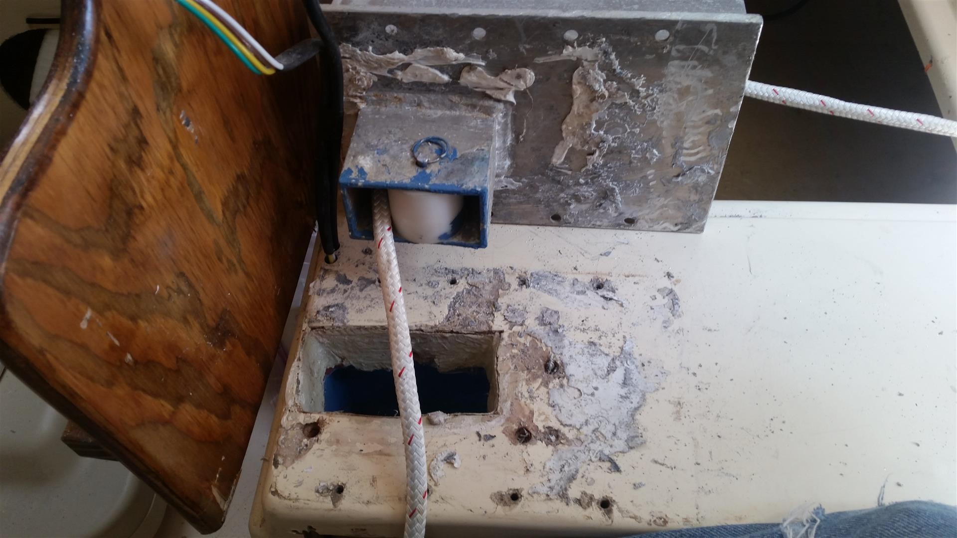

Now I have to deal with the reason that we had removed all but one piece of hardware from the boat. The mast compression strut is welded to the top of the winch box. I never removed the winch box for two reasons, one, did not think I needed to, and second, I did not think I could get it out. Well I was right, it would not come out no matter what I tried as either the strut was welded to the box after the pieces were installed or it was installed prior to attaching the cabin top to the hull. It had to come out so it was time to get serious. I used a micrometer to measure the outside diameter of the compression strut then looked online till I found an aircraft structural aluminum tube that was just a few thousandths larger ID than the tube's OD. Once I had that tube in my hands I cut the compression strut about 6" above the winch box. Now I could remove both pieces from the boat.
This is what I discovered.
A mess would be the quick description of it. There were several serious issues going on here. Not sure where to start. There were multiple unused holes, easy fix. Whoever cut the hole for the winch box cut it too long fore and aft and the front edge on the left side of the hole in the pic is so think it is like a knife edge. Then to top it off whoever did it used one thin layer of fiberglass cloth and some sort of resin to seal the edges. The fiberglass was no longer attached to the edge of the hole. In short it was just a flipping mess.
I already felt horrible about how the honeymoon sail went to begin with but once I saw this I was almost sick at my stomach. Not that I could not fix it but that I did not fix it sooner. But how the heck was I to know what I could not see was going to shoot me in the foot? Time to wipe up the tears and get busy fixing this mess.
I started out by cleaning the area and removing what little sealant there was. Then I ground out what little fiberglass was stuck to the edges of the hole. The front edge of hole needed to be wider than a knifes edge so after determining how much wider I could make it I used thickened epoxy to build that lip back out and sealed all the edges of the hole. I filled all the unused holes and the mystery hole on the underside of the keel trunk.

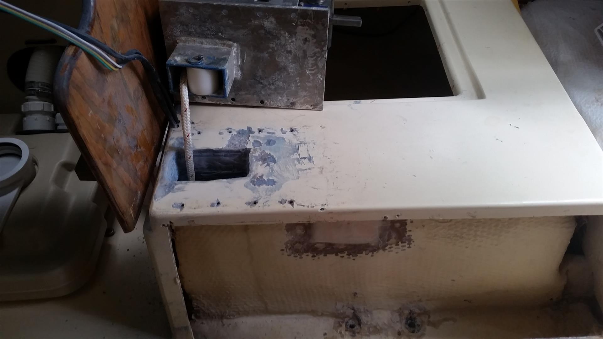

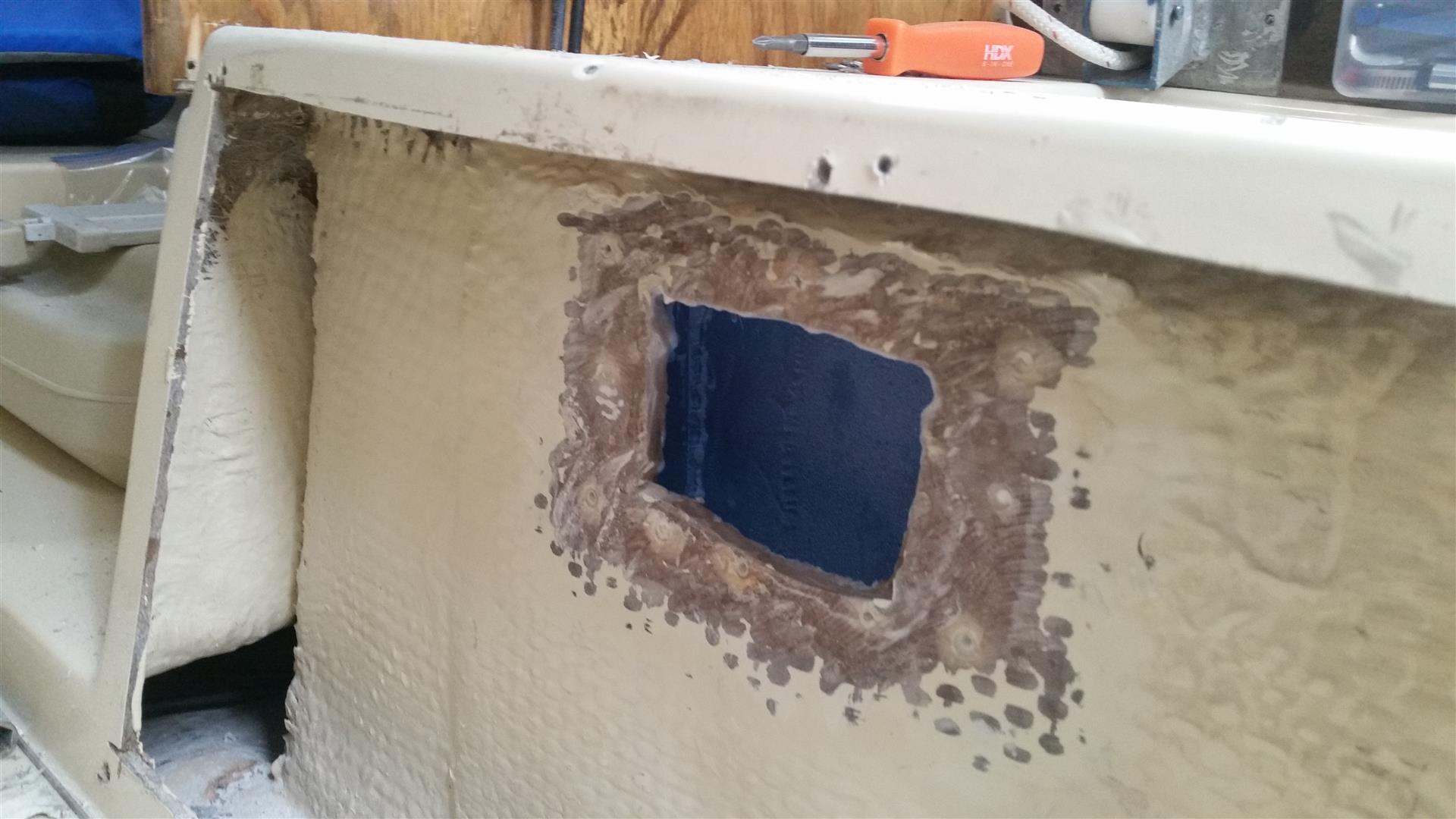

Then there was the access hole. A genius PO at some point cut a 3x4 inch access hole into the port side of the keel trunk that allowed them to replace the keel pennant line with the boat on the trailer. It works but that hole is under the water line. 2 years ago when I removed the thin metal plate covering that hole I discovered they just cut a hole and did not seal the edges. Knowing we were going to be putting it on a slip that was not going to work so I sealed the edges. I used a piece of 1/4 plexiglass to cover the hole so I could at least see in to the trunk thinking that might be handy at some point. Once on the water I discovered that the water line was about half way up the window. I never felt good about this setup so I decided to go ahead and remove it and fix the keel trunk wall while I had everything apart. Here it is ground out and ready to repair
I got really lazy about taking pictures at this point. Probably because it was 95 plus degrees and 100% humidity outside everyday while I was working on this and I was just miserable in the boat. No body lives in Southern Indiana in the summer because they want to...
Anyway I did take this pic showing the hole after I rebuilt the front edge and filled all the holes.
I cored the access hole and used thickened epoxy from both inside and out then used two layers of cloth and multiple coats of epoxy inside and out to repair it. Lets just say it is real fun trying to work epoxy in a 2 1/2" wide keel trunk above your head in 100 degree heat.
With repairs made I applied a very liberal coating of 4200 around the opening and to the underside of the winch box then reinstalled the winch box. Sealer oozed out from all four side and down into the keel trunk around the opening so I feel much better about it being water tight now.

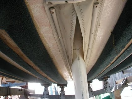

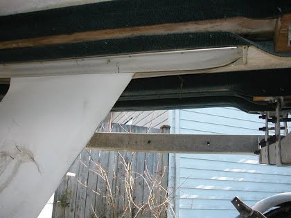

A common fix for leaks through the keel trunk is the installation of a keel gasket. They prevent water from gushing and splashing into the keel trunk. They also reduce some drag associated with water flow around the opening.
