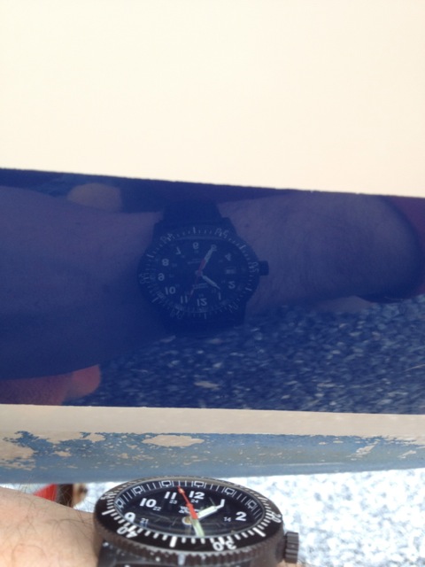

I put in a whole bunch of work on the boat this weekend. My main focus was polishing. I used Main Sail's tutorial, and Presta Gel Coat Compound and Ultra Cutting Creme, finished off with Collinite 885 paste wax. The sides are looking really good. I hope I can get the cabin sides, cockpit, and coaming to look half as good as the sides.

Thanks, RBone and Ward! That's the original gel coat boot stripe. I'm guessing that always being a freshwater boat helped, and perhaps the previous owner kept wax on every year. At least it wasn't excessively compounded and polished over the years. The topsides certainly were in decent shape, but I wish the cabin top sides and cockpit were as nice. Still, they are coming up decently...
This kind of job doesn't take elbow grease - it's my shoulders that are complaining! But that Makita 9227c is a nice piece of equipment.
