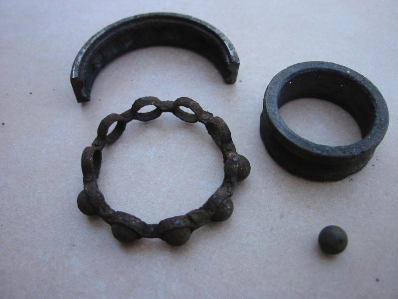

Okay so now on to the main ball bearing directly under this seal. The photo shows it all. Rusted to death and the outer race broke into pieces as I gently tapped it out of its housing. Not made of stainless? Well though stainless bearings were not available at least rustless ones were.
So why did the seal above this bearing fail. Well it was a FACE type and relied on the collar above to press gently down on it. This it did not do reliably because there was end float in the shaft assembly. Accordingly I replaced it with a lip seal that runs on the shaft itself. Easily obtained from the supplier who also sold me a 'rustless' ball race.

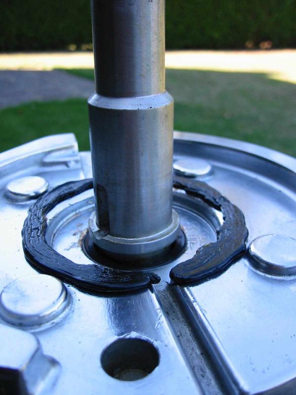

On replacing the windlass I realised that, mounted in the anchor locker, waves could keep it constantly doused with seawater and worst of all the design of the windlass baseplate is such that it actually directs water into the well that the seal sits in and there is no proper drainage.
A sure recipe for disaster.
What I did when rebuilding the thing was to squirt silicone rubber in a ring round the seal on to the base plate and then apply grease to the underside of the gypsy and bolt it down. The idea being to compress the silicone rubber until it set but not have it stick to the gypsy. Then I took the gypsy off again and noted a horseshoe seal facing forwards.
I left the grease in place and haven't looked at it since.
You can see the black top of the new lip shaft seal in the photo.
