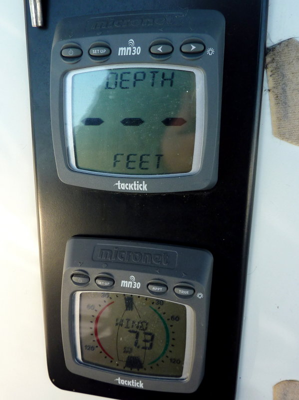

We have a tacktick the came with the boat. The PO must not have investigated thoroughly as the mast is beyond the recommended distance of ~35 feet to the instruments. Last year it stopped working, there was an issue with the bearings they used. We sent the mast head unit to Raymarine for repair. They offered a new unit at a good discount. This year it worked for a few weeks but since we haven't been able to get the units to speak to each other. Re-syncing has not worked. We will be switching to wired system next year. I was hoping that they would come out with a signal booster but nothing yet. It's a great concept, but, go wired.

I have had good luck with my tack tick system. I would never go back to wired again. I have it on my Catalina 34. I have the complete system.
