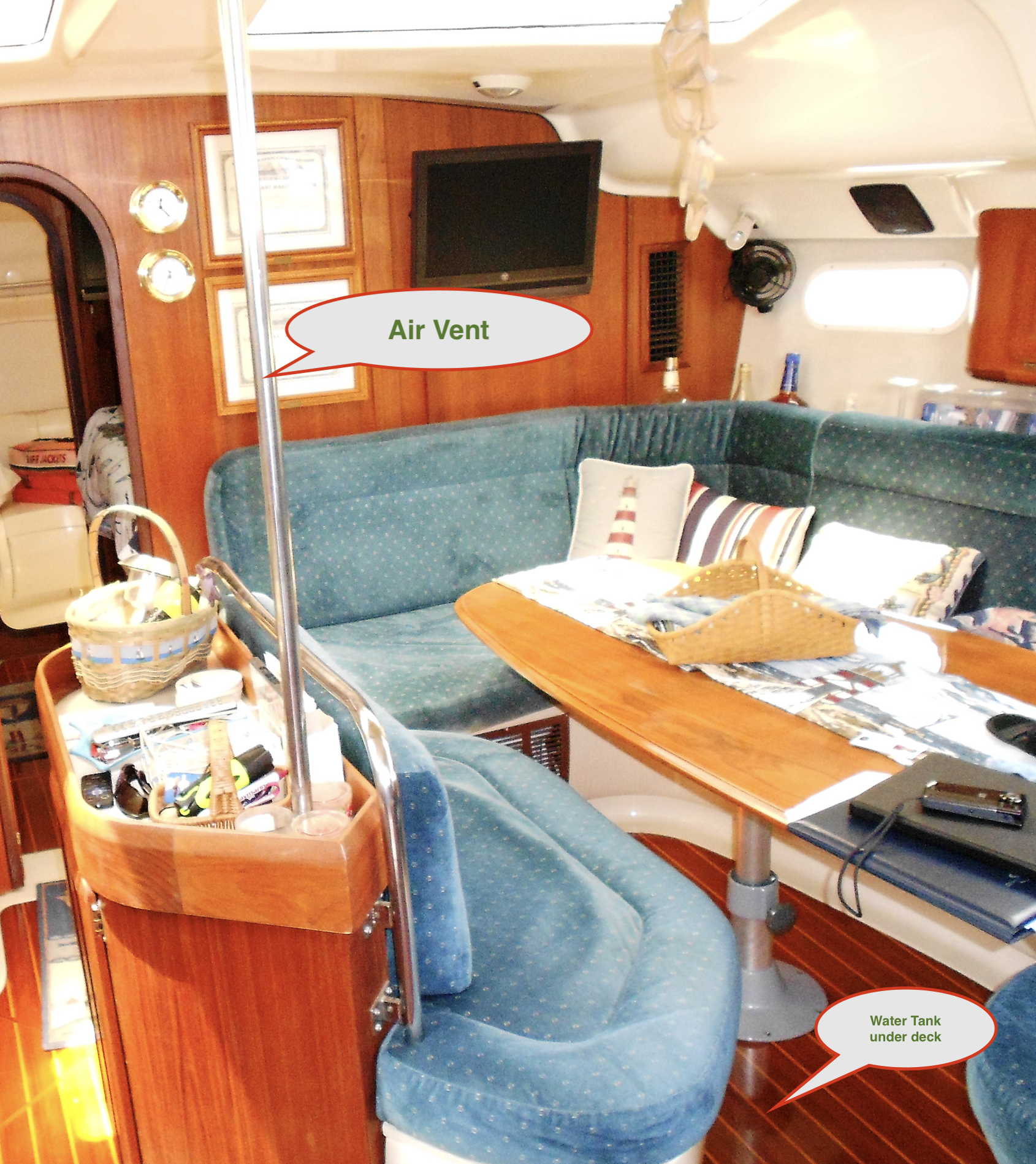

This a picture from our H430
Yes, the Air Vent is that Stainless Pipe that vents under a removable deck Cover.
No venting will cause you plastic water tank to Bulge.
Jim...

Our 47-gallon water tank has started to bulge and pushed up the floor boards. How do you replace this tank,
It really helps to provide all the information at you hands for us to solve this problem. Such as year of the boat and what the tank is made of.
Fortunately, it's a simple problem with a most likely simple answer and all indications point towards a plugged vent. Time to get in there and get your hands dirty and locate the blockage. Also time to inspect the tank to see if the pressurization has started any cracks.
See where information like the age of the boat and tank composition now come into the enquiry ? Aluminum is more likely to crack at edges than polyethylene. If it's an OLD boat, it's more likely to be an aluminum tank.
