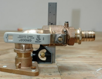

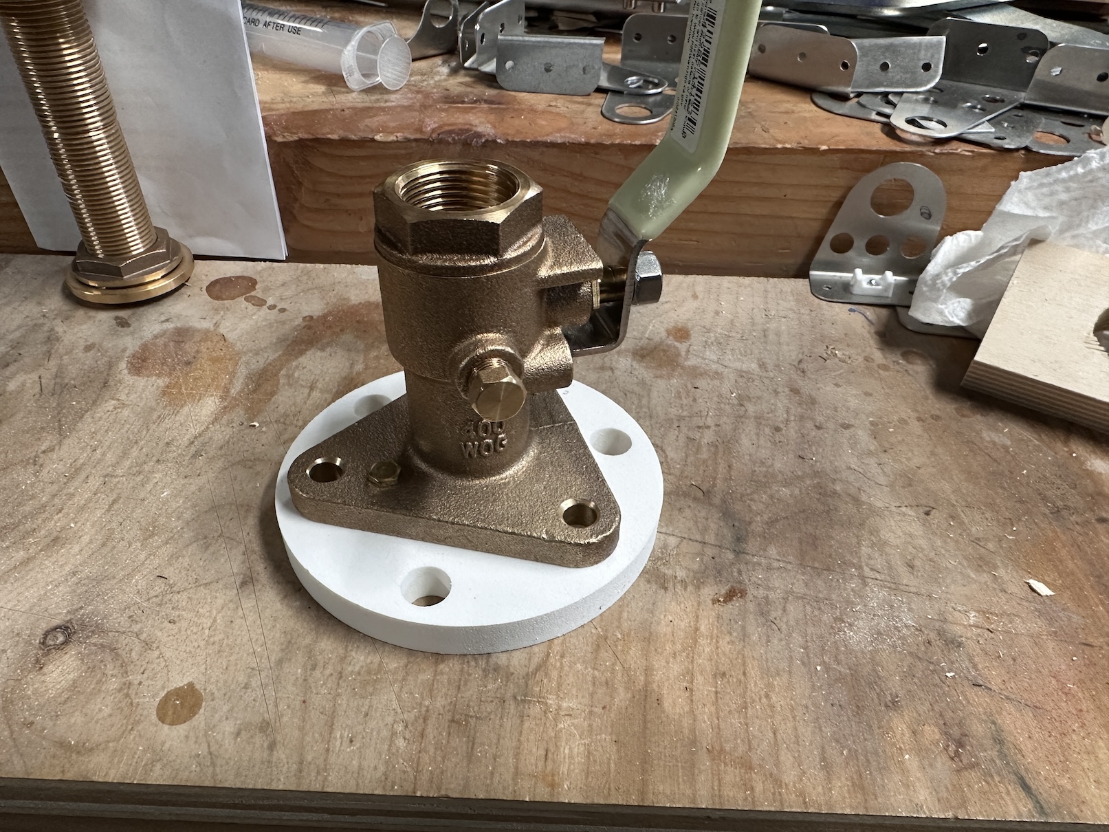

I am struggling to replace the thru-hull and seacock for the marine toilet. Not only is the space pretty tight, a replacement using parts from Groco cannot be installed because there is not enough space. The elbow cannot be screwed into the valve. :banghead: I called Groco to see what they would suggest, and they recommended a flanged valve. I told them this might be difficult because of the location and sent them some pictures. With the pictures, they recommended this.
That will certainly fit, but I do not feel comfortable with this. I am sure it's doable, but two screw connections before the seacock, not sure if I like that. I guess in the end I will go with a flanged valve. I will have to fill the recess around the hole, using a small disc from G10 and glue this into the recess, redrill the hole, and level the backing plate with thickened epoxy, which will be necessary because of the stupid rim in this area.
Any other thoughts?
Thanks Christoph

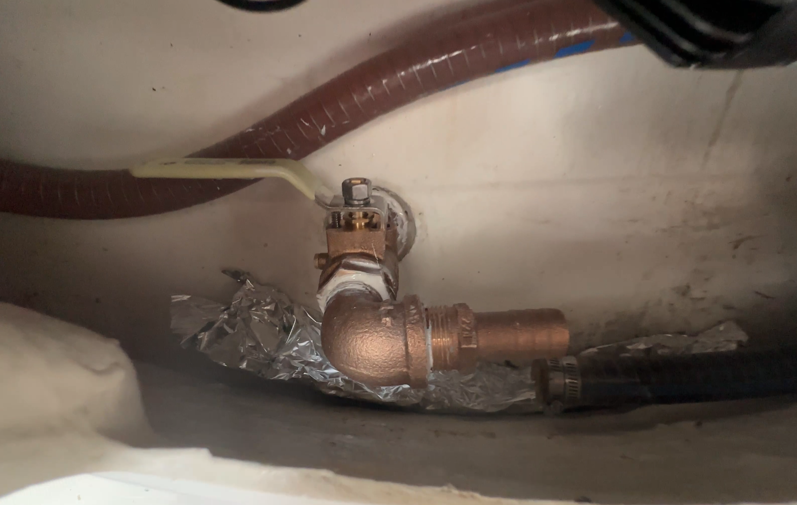

Why not replace it with the same factory configuration, using Groco thru hull fitting, ball valve, & tailpiece?
That was my plan. Check out the attached picture.
Unfortunately, as you can see in the video, it did not work out. There was no way to screw the elbow into the valve, not enough space and you cannot shorten the thru-hull fitting. Groco thru-hull fittings for this valve have a combination thread NPT/NPSM. The first inch or so is NPT and then transitions into NPSM. How do I know this :rolleyes: ? Just cut the fitting to make it shorter, then you will find out. :banghead:
I also thought about a fitting with a BSPP thread, and the corresponding valve may be a solution, but Groco advised against that, stating I would have problems sealing it.

I may go with this solution
That would probably be the best.

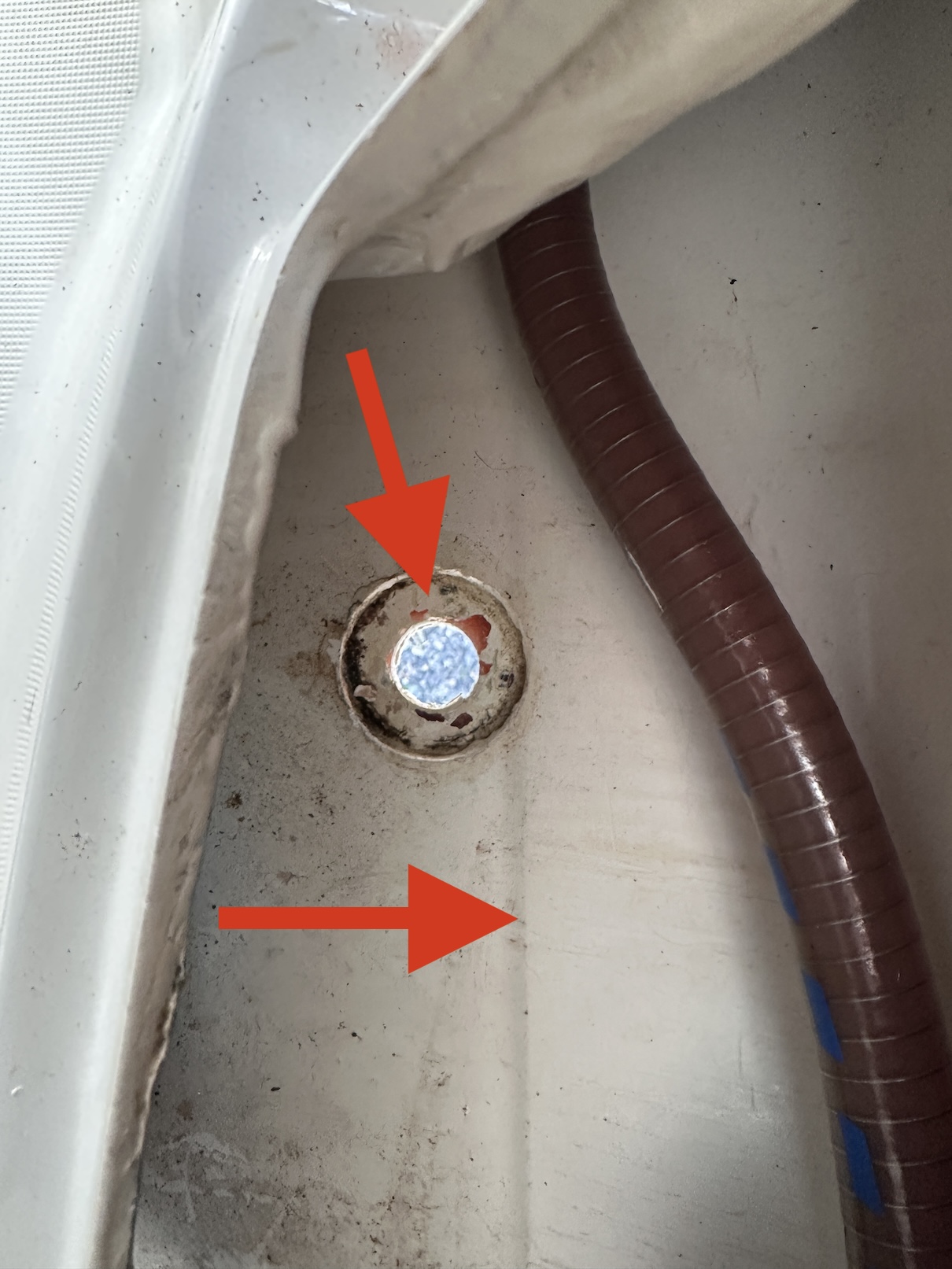

But ... I would have to deal with the stupid recess around the hole and this rim above the hole.
Both require some epoxy work, not a problem, but time consuming

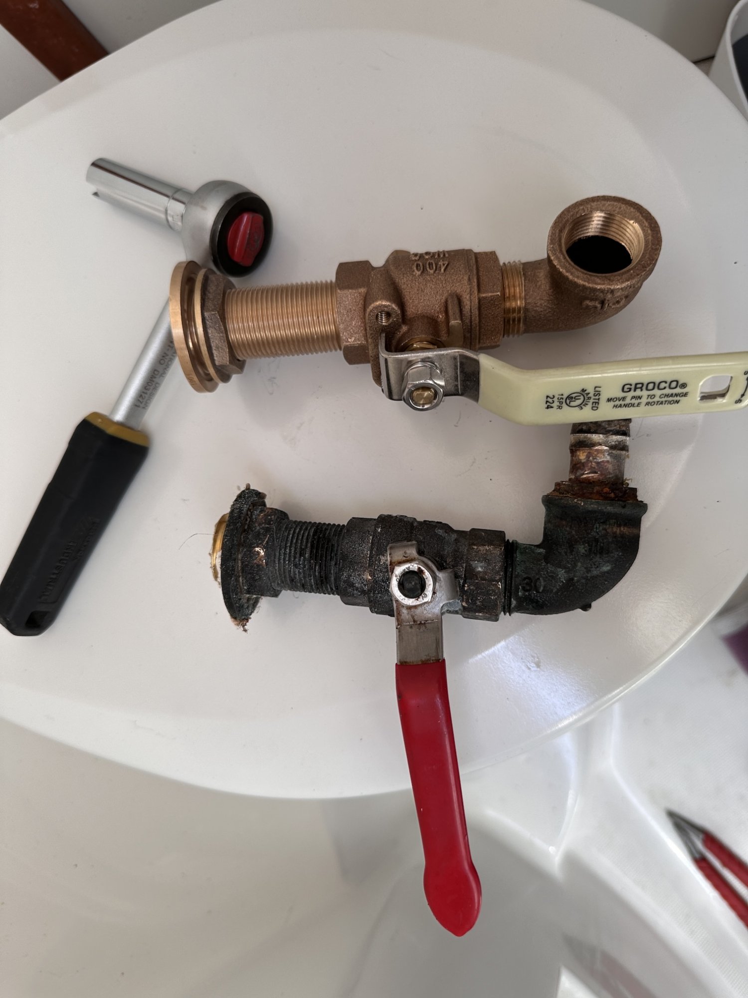

Very frustrating indeed, especially working under the lavatory cabinet. You will have to change the assembly order and get a helping hand. First, assemble the elbow and ball valve such that the elbow is oriented in the proper direction as well as the valve to enable operation of the handle. Once it is dry fitted & is verified, coat the threads with your favorite adhesive / sealer & reassemble. I use 3M 4200 & Teflon tape; however, I don’t want to start the forever debate on what’s the best sealant/adhesive for thru hull fittings! Suffice to say, I have never had a thru hull assembly leak using 4200, including the BSPP fittings & the assemblies can be broken down if necessary. Then, hold the assembly in position & have someone outside the boat thread the thru hull fitting that has been liberally coated with 4200 into the other end of the valve & tighten (Thread your backing nut onto the thru hull, inside the boat, before screwing into the valve). Will probably need a pipe wrench to hold the valve assembly & a step wrench to tighten the thru hull fitting. Finally, tighten the backing nut onto the thru hull fitting to the interior surface of the hull without changing the orientation of the valve & elbow. Let the entire assembly set for a couple of days to allow the adhesive/sealer to cure before attaching hoses & splashing. Going to have to buy another thru hull fitting since you cut yours or may have to resort to all BSPP threads. Let us know how it all works out. Good that you decided to replace the old fitting. If Beneteau can do it, you can too! :)

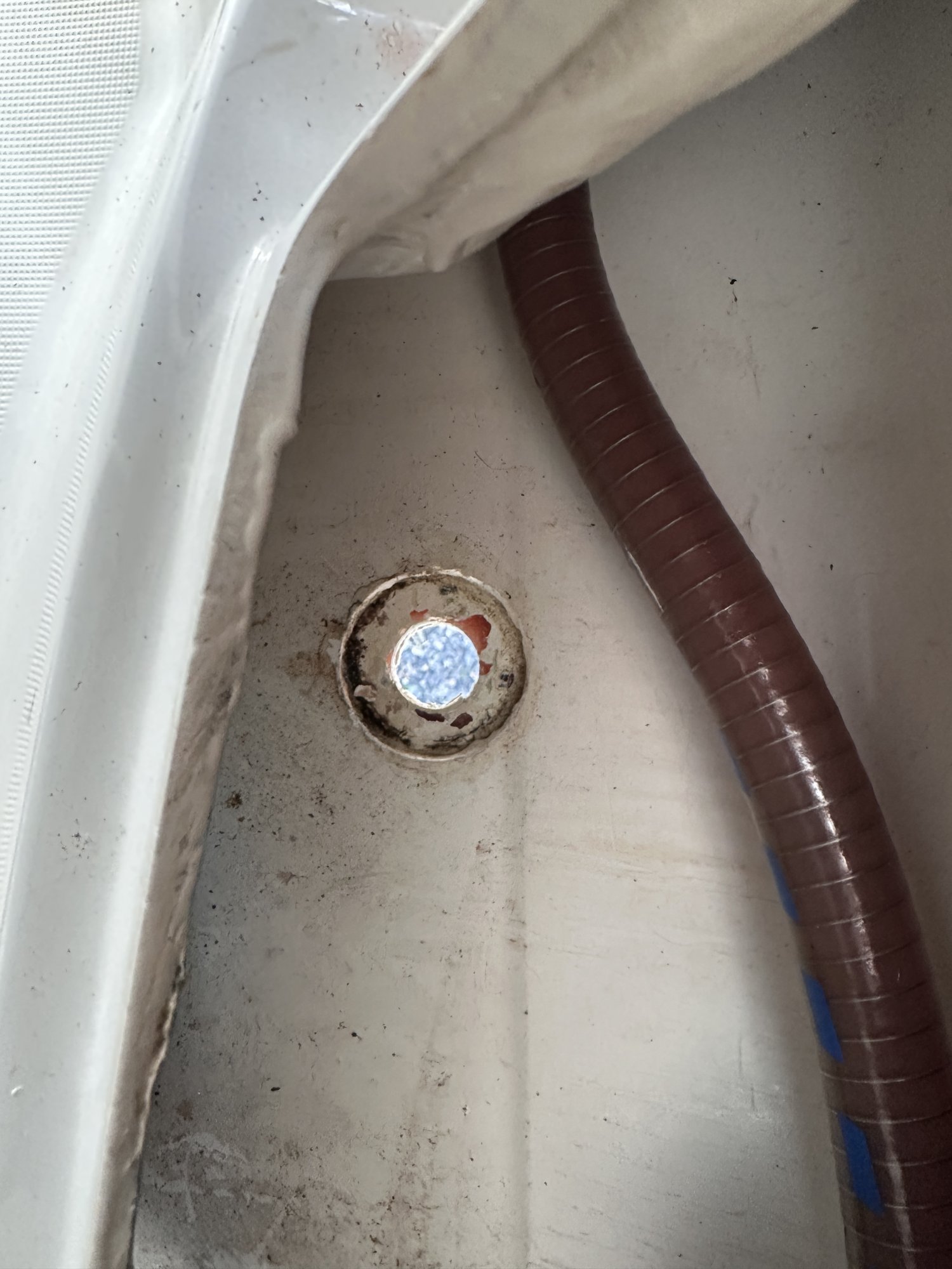

@BigEasy The way of mounting you describe is for sure causing the least hassle and would restore everything the way it was. The problem is you need two people, one on the outside, but that should not be a problem. The problem I figured is to tighten down the nut since the nut is sitting in this useless recess. It’s almost impossible to reach it with a wrench. I can hold it with pipe pliers and then turn the thru-hull like in the video, but I am not sure if I will be able to put enough torque on the nut to tighten it down appropriately. I will find out.
Thanks for the encouragement. I am fairly certain Beneteau installed this thru-hull and valve before lifting the complete interior in one piece into the empty hull. I guess the function of the round recess is to create a flat surface for the nut to sit on since the hull is slightly curved in that area and has that rim.

Can you loosen the through-hull nut, then tilt the through-hull away from the wall and finish assembling the seacock and the corner piece, then tighten the nut on the through-hull. This will require the help of a second person from outside.
All of my thru hull fitting locations had the recessed areas, so this wont be the last time you deal with that. I did not have a dedicated wrench to fit the backing nut, so I used vise grip pliers and/or “channel lock” water pump pliers. Also used a pipe wrench (Stilson wrench / “monkey” wrench on the valve body. A thru hull step wrench was used to tighten & hold the fitting from outside the hull. I use only one wrap of teflon tape and 4200 sealer / adhesive. Many use 5200; however, I think that is over doing it.

M3 4200 and tape.
For consideration when you replace the other fittings. I disconnect the hose & grind away the mushroom on the external surface of hull, then pull the remaining thru hull fitting, valve, & tail from inside. Takes all of 5 minutes with no busted knuckles, swearing, etc! Try It, you’ll like it!:biggrin:
