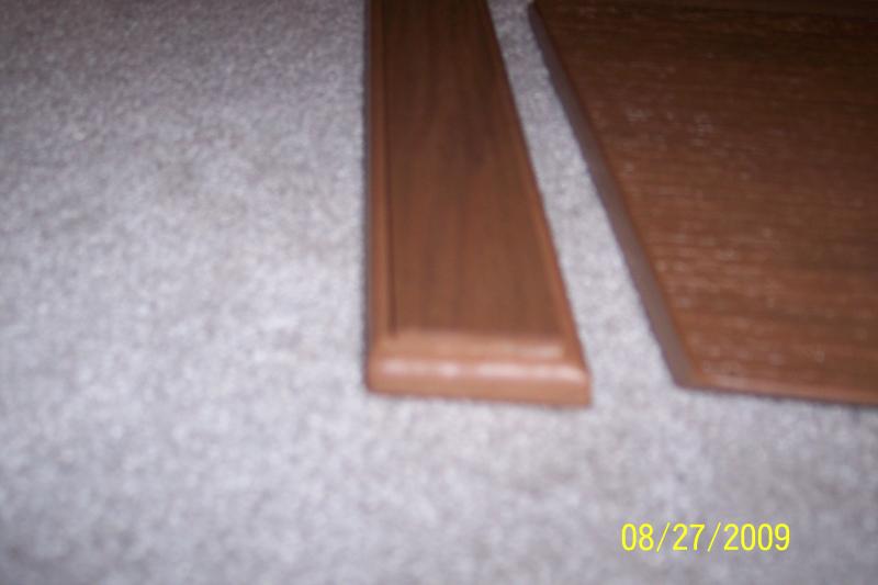

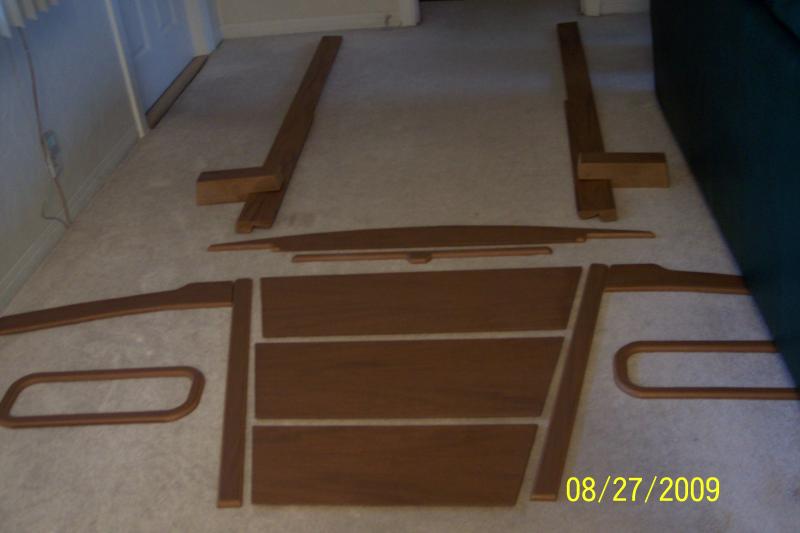

As Merlin said, there are different grades/materials for faux wood. Decking boards & fascia boards worked for me. My deck boards are 6" W x 1" T. The fascia was 16" W x 5/8" T.
I believe I ordered these 12 ft. long.
DON'T BUY ANYTHING MADE FROM RECYCLED PLASTIC BUT LOOK FOR UV PROPERTIES.
I used what was called Sensibuilt now named, but easy to find on the web. I would bet there may be even better products. Some will send you samples. I would check their specs & MSDS sheets. This will tell you alot about the products for comparison.

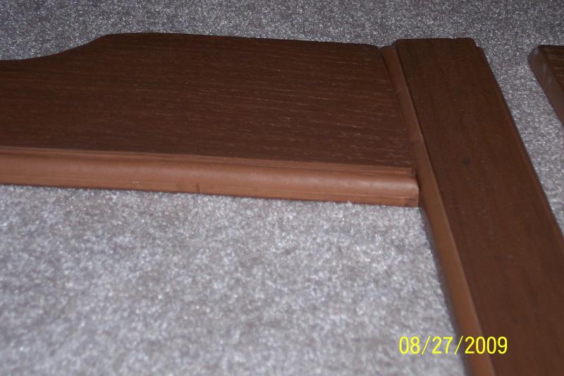

On the companionway slats, I put stiffeners on the back as this stuff can warp over time. No warping since installed.
If you go this route, be careful of using chemicals mainly MEK on your edge cuts. This will cause harm to the finish. Nothing stronger than mineral spirits.
Here's some pics for my 1980 C30 to give you an idea of what to look forward to. It wasn't hard to cut. I did mine mostly on my small table saw, router & saber saw. Practice a couple cuts before cutting the "real" pieces.
You can also find a wood shop to match-cut the pieces for you at hopefully a fair price.
Life's too short to constantly redo your own wood.

When I got my Sensibuilt, they had a brush-on finish that didn't match the color. I used MEK on the cut edges & it looked perfect. The downside was that, after 4 months in the sun, it chalked up. I do know now, that the have a brush-on finish. I would ask them about this.

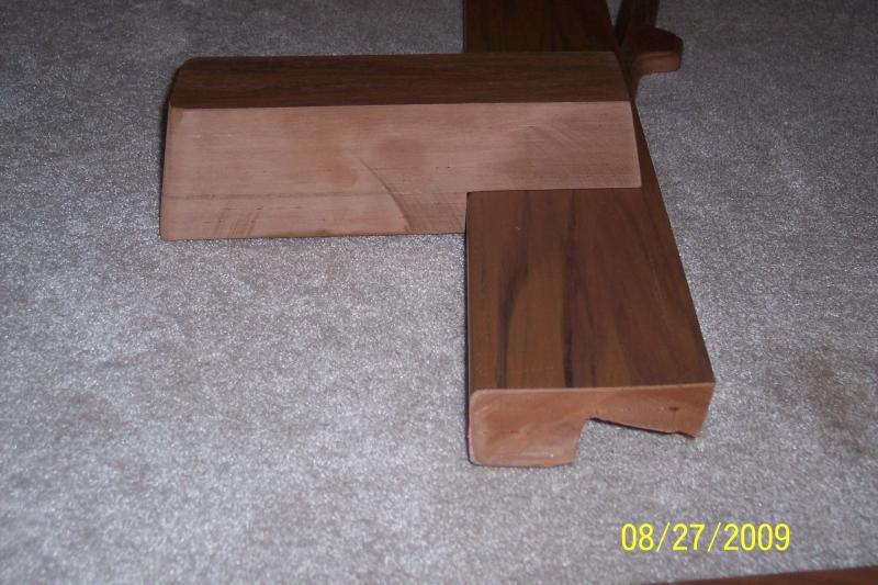

For my traveler, I sandwiched/epoxied 3 deck boards 3 high & then cut them to suit. If you want, I may have the drawings I made, I'll probably have to scan the sketches. Let me know.
The other board I mentioned is called Fascia Board, mention this (16"W x 5/8" THK). I'm waiting a few more weeks but will order this. Here is the email I received awhile back on the coating, you look into this pal:
