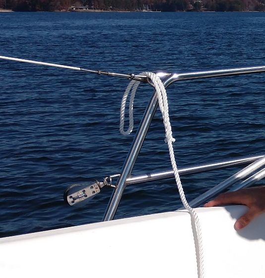

My H240 has spinnaker blocks attached to the railings on the port and starboard quarters. I plan to replace these with blocks with internal cleats unless anyone has a better suggestion. I have found a Spinlock VS 50mm Jamming Spinnaker Block that looks perfect. I am however open to other solutions.

What size (diameter) spin sheets? Where do you position the trimmer? For me, it would depend on how the trimmer activates the cleat or releases it. The Garhaurer is pretty basic, snap up to release, down to engage, but can it oriented for the trimmer's location?. If the Spinlock is a ratchet type, with pull to release action (making it more expensive) then I'd lean towards it.

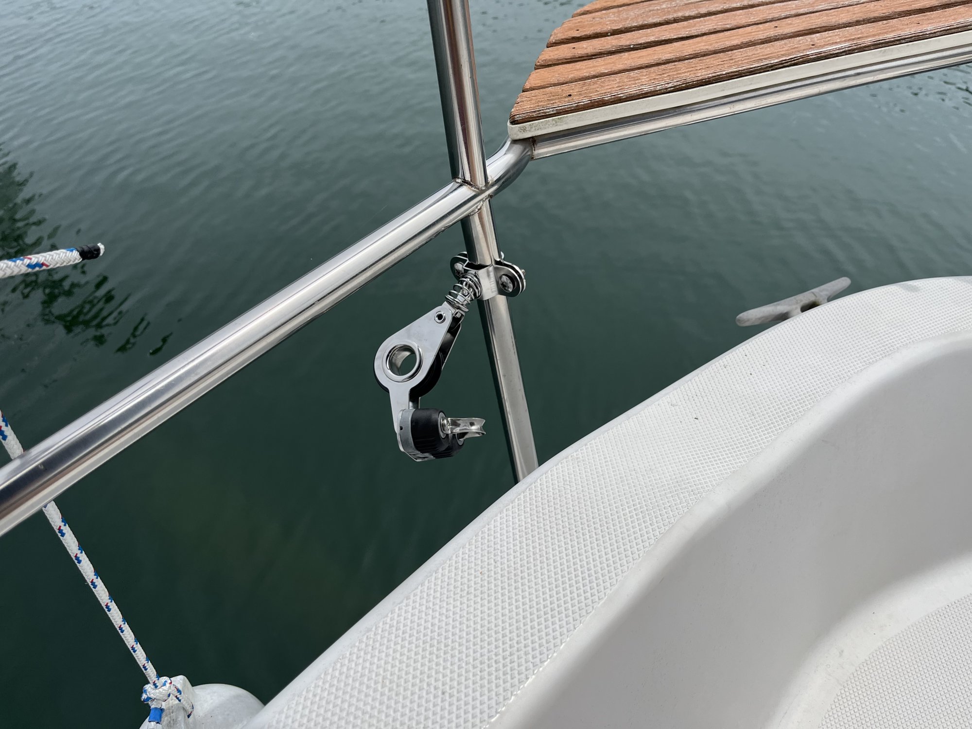

The Garhauer blocks arrived yesterday. I will install them this week end. They look perfect for spinnaker sheets. I bought directly form Garhauer and paid $138.60 for the pair. Report to follow.
Jun 12, 2021
290
Hunter 240 Aqualand Marina, Lake Lanier
I installed the Garhauer blocks further aft than the factory spinnaker blocks. Jessie and I took the boat out and set the spinnaker for the first time. I am going to move the tack block and modify the path for the sock halyard but other than that it was a non event. Winds were four knots and we sailed about a mile across the lake with just the spinnaker. The Garhauer blocks worked great. The angle of the cam was perfect. I have a Precision turtle bag on order which will simplify setting and retrieving the sail.

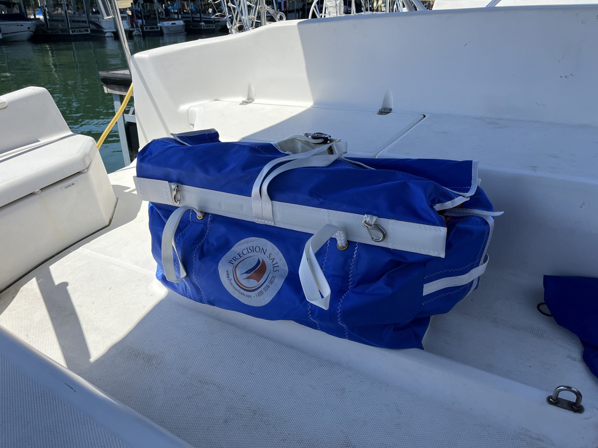

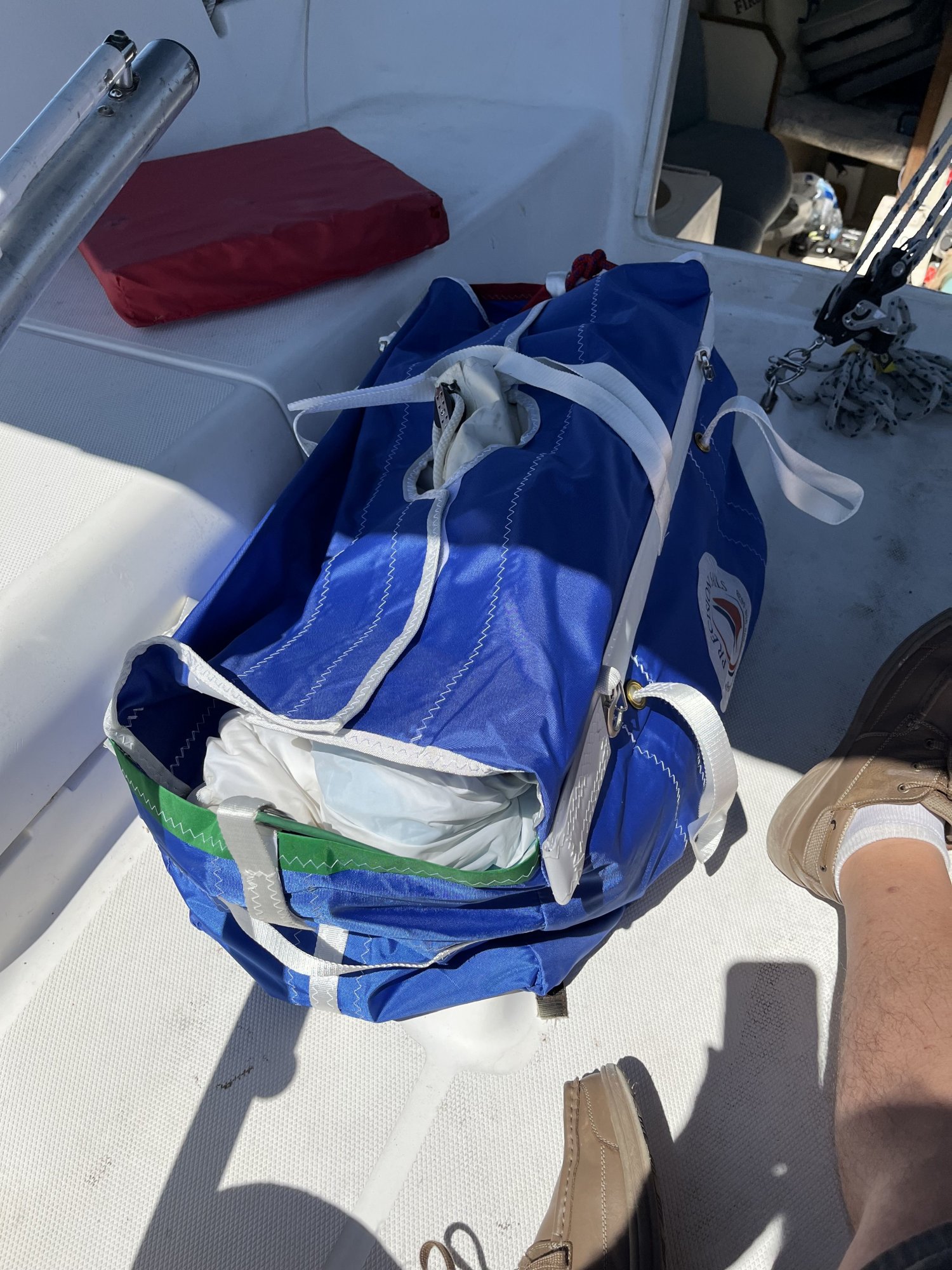

Two weeks ago we set the spinnaker and it pulled us across the lake with no fuss. I had to move a few blocks and repurpose one cleat but I am quite happy with the results. I received my spinnaker bag from Precision Sales. Jessie is very pleased as it snaps to the life lines and allows her an extra hand for herself. We will try it out this Saturday as the winds will be light and the temperature will be under 90. I ordered the extra small size and the spinnaker fits perfect, even with the sock.
