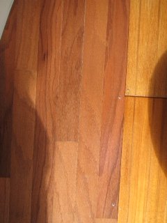

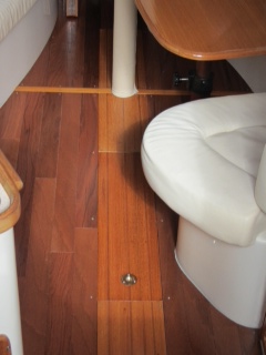

While waiting for a $300 piece of teak and holly veneer to be delivered I made up some "temporary" panels out of pre-finished engineered oak flooring I had on hand. They are tough as nails and I like them enough that the expensive plywood is still languishing in the basement.
The teak and holly ply is:
Expensive -see above, Photosensitive - the teak lightens and the holly goes dark, look under your table pedestal, the wood colors have reversed, and the veneer is thin as paper.
My bilge covers in photos are original teak and holly, you can see the holly is now dark.
