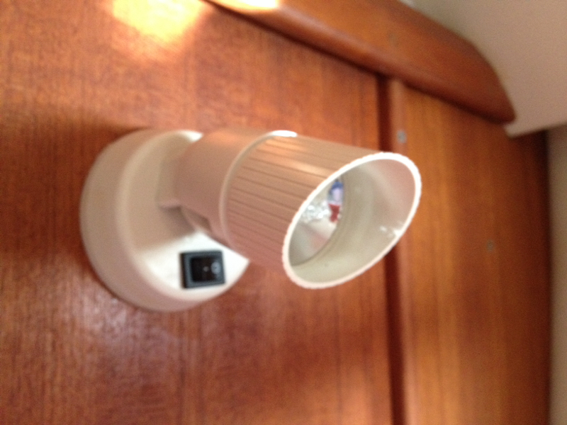

I just did the same thing. The bulb just pulls straight out. You need small fingers and need to wiggle it back and forth while pulling it out.

I found LED replacement bulbs for these lights at Lowes. Less than 10.00 each for warm white.

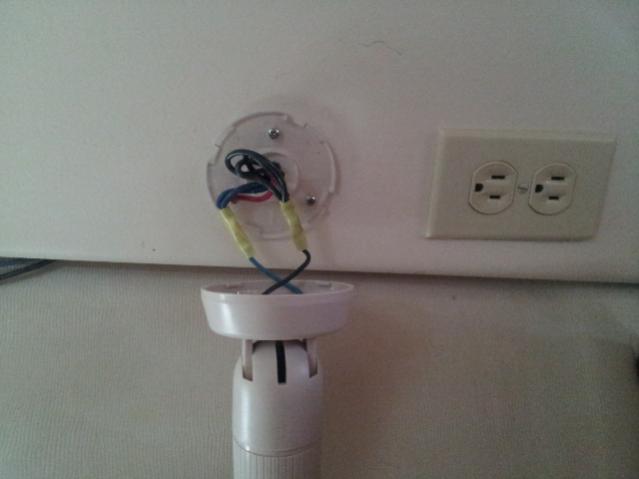

The lamp is not the problem, still works! The fixture broke away from the base. I have not been able to remove the fixture from the bulkhead.

Jeff, did you ever figure out how to remove this fixture?
Figured it out. Grab the base and twist counterclockwise and twist about 20 degrees
Be careful when reinstalling to get the switch where you want it.
