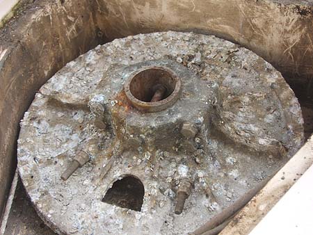

This is something the surveyor missed on our recently purchased 1991 C30 MKII - the steering radial drive wheel is badly corroded. I just discovered this when I pulled the access cover to check on the tension of the steering cables. What a shock! I found the drain to be mostly plugged which, I believe, has allowed the radial drive wheel, and cables, to sit immersed in water much of the time. The drain has been cleared, but the drive wheel and cables need to be replaced. The question is, can this be done without hauling the boat? Just looking at the drive wheel, it would appear that the rudder could drop off if the bolt passing through the wheel, and rudder shaft, were to be removed. Is there something under the radial drive wheel that holds the rudder as well?
