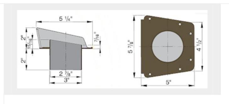

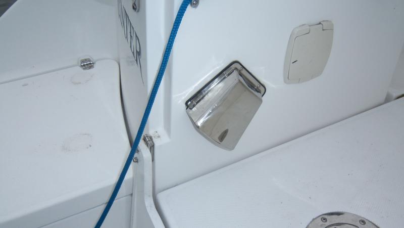

One thing I never see here when butyl is mentioned is that it's is an absolute bear to work with in cold weather. Combine cold weather and weaker plastic flanges as found on a Beckson port and it just ain't gonna work ................. until you bring out the hair dryer ;).
I had to re-install a Vetus vent recently which had a plastic base and a flexible SS vent on top. Outside temperature was cold (as usual for here). Rolled and layered the butyl onto the plastic base with little to no care or accuracy. This was easily done in a warm place. When the vent was loosely installed with the machine screws, it was obvious that not a lot of torque could be applied to the screws without permanently deforming the SS vent. The butyl was good and solid by now . Brought out the hair dryer, warmed the entire assembly and slowly tightened the screws. Cut and pulled the excess a week later and a perfect job.
