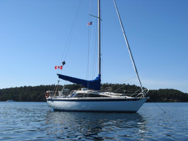

I can do all the cutting/edging/drilling etc myself as they're pretty straightforward shapes, not tight curves. One long section, divided into 3 smaller pieces. (see photo) The actual ports themselves are approx 30" x 9" so I don't think I need to go any thicker than 1/4" plexi.

I just replaced the windows on my Y30 a 6 months ago. After months of research I decided to go with sealant only. Sikaflex 295uv and 2 primers one for each surface. I made a call to my local sika sales rep and he walked me through the process. A good resource for sure. The key to the whole process is proper surface prep and bead thickness of the sealant. The ports are much smaller than the actual plexi so you end up with a good 2" to seal all the way around more than enough. So I used a 3/4"W x 1/4"D double sided foam glazing tape to hold the windows in place while the 1" wide strip of sealant dried. (1 shot to place the window so get help). After I used lots of masking tape and did a finish bead inside and out. This method allows all the expansion the sealant needs by keeping the bead 1/4" thick. No screws means no cracks and the plexi curves beautifully. Also I took the 3 pieces and made it into 2 even sizes blunting the front point to 2.5" high. Looks good and a little stronger. Don't waste time millling it yourself as I took the old windows down to a fabricator and they supplied (cast plexi from left over pieces), cut and altered the shape on a cnc (perfect) for $400 can. Took 2 days to get them back. Call ahead and you can get it done same day. Finally..."cover you decks". Sikaflex is wonderful stuff but what a mess. Process took 16 hours, 8 hours just to get everything clean, and I decided to finish Yamaha's job and glass fill the holes between the cabin inside liner and outside deck. Yamaha only filled about half and I wanted more glue space. Project isn't for the faint hearted but is worth the time. I try to post some pics soon.
