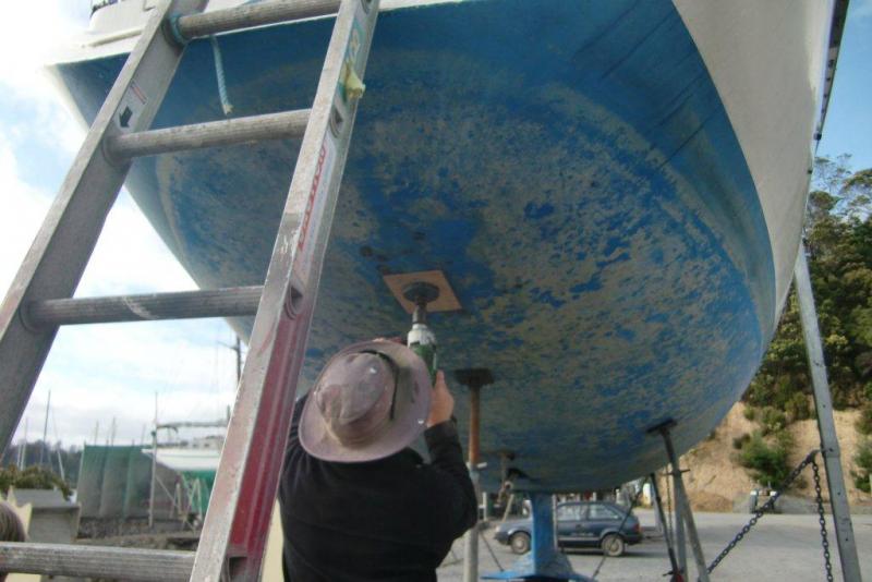

Photos of replacing P42 lower rudder bearing

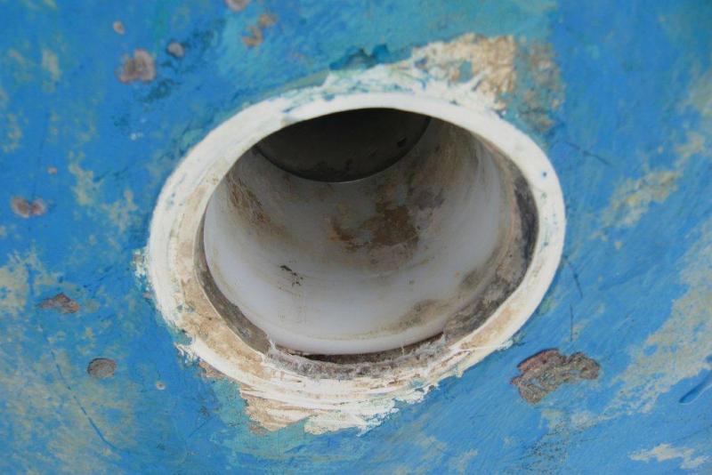

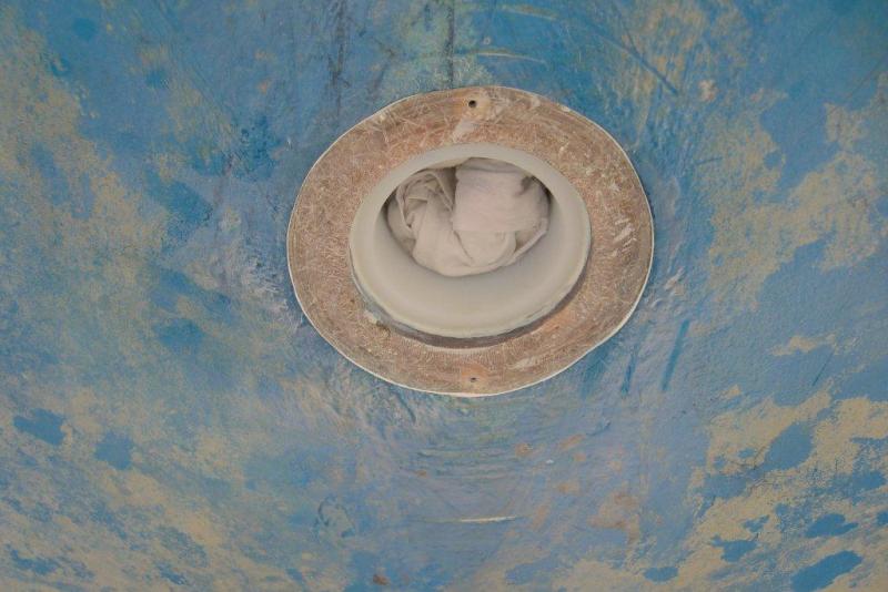

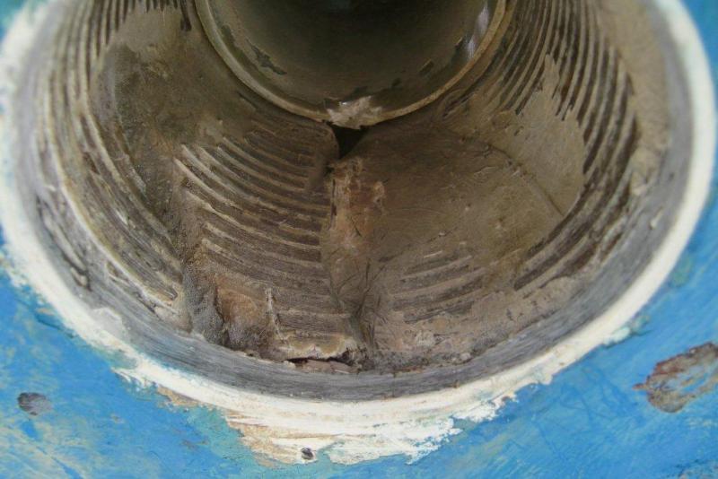

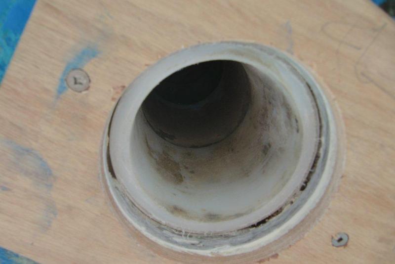

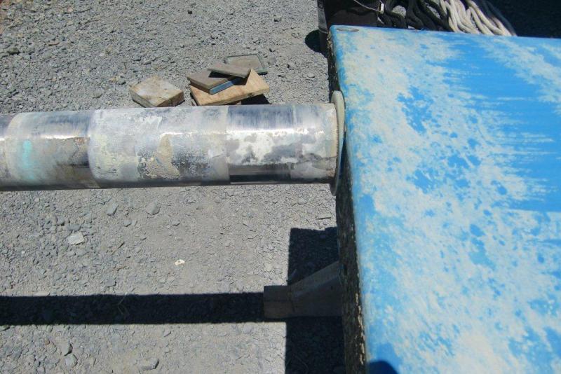

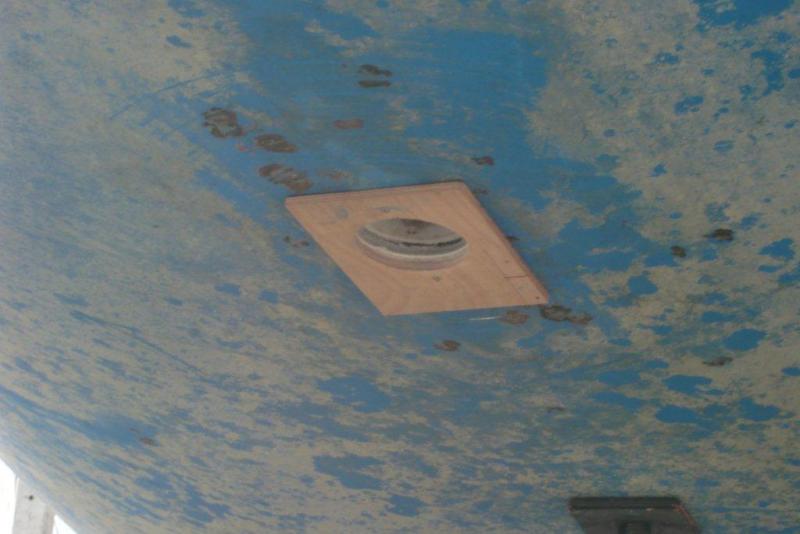

Here are some photos I took of the job. The first ones show the old rudder bearing in place. I chipped away at the fiberglass just a bit to show the overhang over the bearing. The rudder shaft photo shows where the bearing was stuck on the shaft and rotated along with it. The photos of the rudder shaft housing show the parallel lines of the epoxy where it originally affixed the bearing to the housing. The photos also show that the housing is neither round nor well filled with fiberglass; significant voids existed. Two of the photos showed how we screwed a piece of wood over the rudder hole and used a hole saw to drill out the fiberglass from under the bearing. Finally a photo shows the laminate piece we glassed into place under the bearing after the bearing was epoxied into place in the housing. The last task was to glass over the laminate and then paint over it all.

Excellent, Paul. I will file this info away in the event I ever need it.
