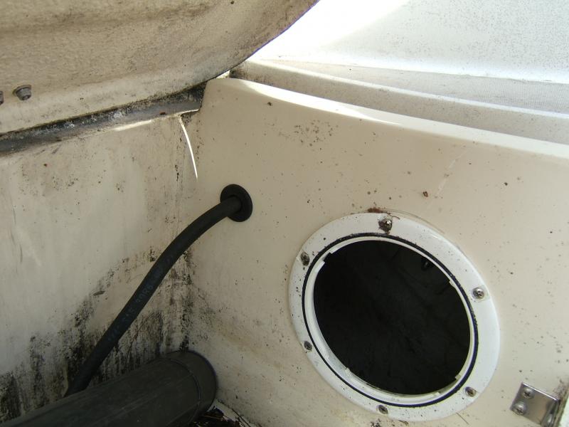

Attached picture is not my Oday 222, but one I looked at prior to purchasing mine. I am hesitant to post the picture because it also shows what not to do. On this boat, the fuel line was routed from the starboard fuel locker through the lazarette and out the transom for the outboard. Problem is Fuel line not rated for this application- of course dangerous because could introduce fumes or fuel into lazarette. This owner also added access port (deck plate) here to change out motor mount. Maybe others could chime in whether or not the fuel locker is a good position for any type of access plate- concern being that fumes may enter lazarette. Perhaps if it were well sealed- BUT it just is a bit concerning to me.

Thanks Everyone! I was first thinking that I was going to install a deck plate in the fuel locker. But the fumes entering the lazarette is bothersome. If I install one in the center transom like Trinkaa did, do you all think I will be able to reach the through bolts of the motor mount? I'm nervous I will cut this hole in my boat and then I won't be able to reach or complete the job.
What do you guys think?
I mounted a 4" Beckson Deck plate in my fuel compartment to gain access to a cleat that I needed to mount on the Starboard combing near my stern rail and it worked out great.
Like you just mentioned, running a gasoline fuel line through the fuel compartment through the bilge, and out the transom is not safe.
The fuel line on the O'Day 222 needs to exit out opening at the bottom of the fuel locker and up over the transom to the outboard.
The old rubber fuel lines were longer than the new ones of today. The new fuel lines which are Alcohol resistant, are only 6' long which is too short. Also, the syphoning bulb isn't in the right place on the line.
To correct this problem, I had to purchase a longer length of fuel line hose at an automotive store, (pricey) and make the necessary changes, using the hardware from the store bought fuel line. My fuel line is now 8.5' long and the syphoning bulb is about 8" from the fuel line connector inside the compartment.
