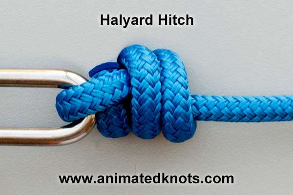

I use a long U shackle with captured pin. I tie the shackle to the halyard. If on inspection if find that chafe/age has degraded the line I simply cut the line back to good line and tie the shackle on again.
Halyard hitch on Shackle.
