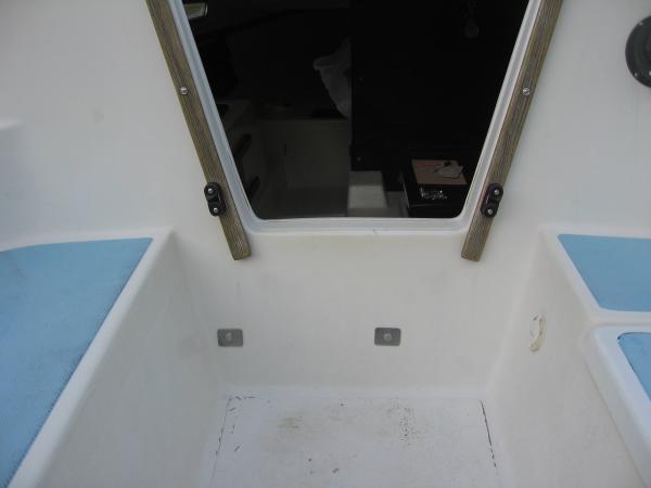

My boat is a Macgregor 25, but is similar . I have cam cleats mounted as seen in the picture. The jib sheet comes off the winch and to the cleat on the opposite side. Works very well, and is easy for the helmsman to reach if single handing (see utube video)
