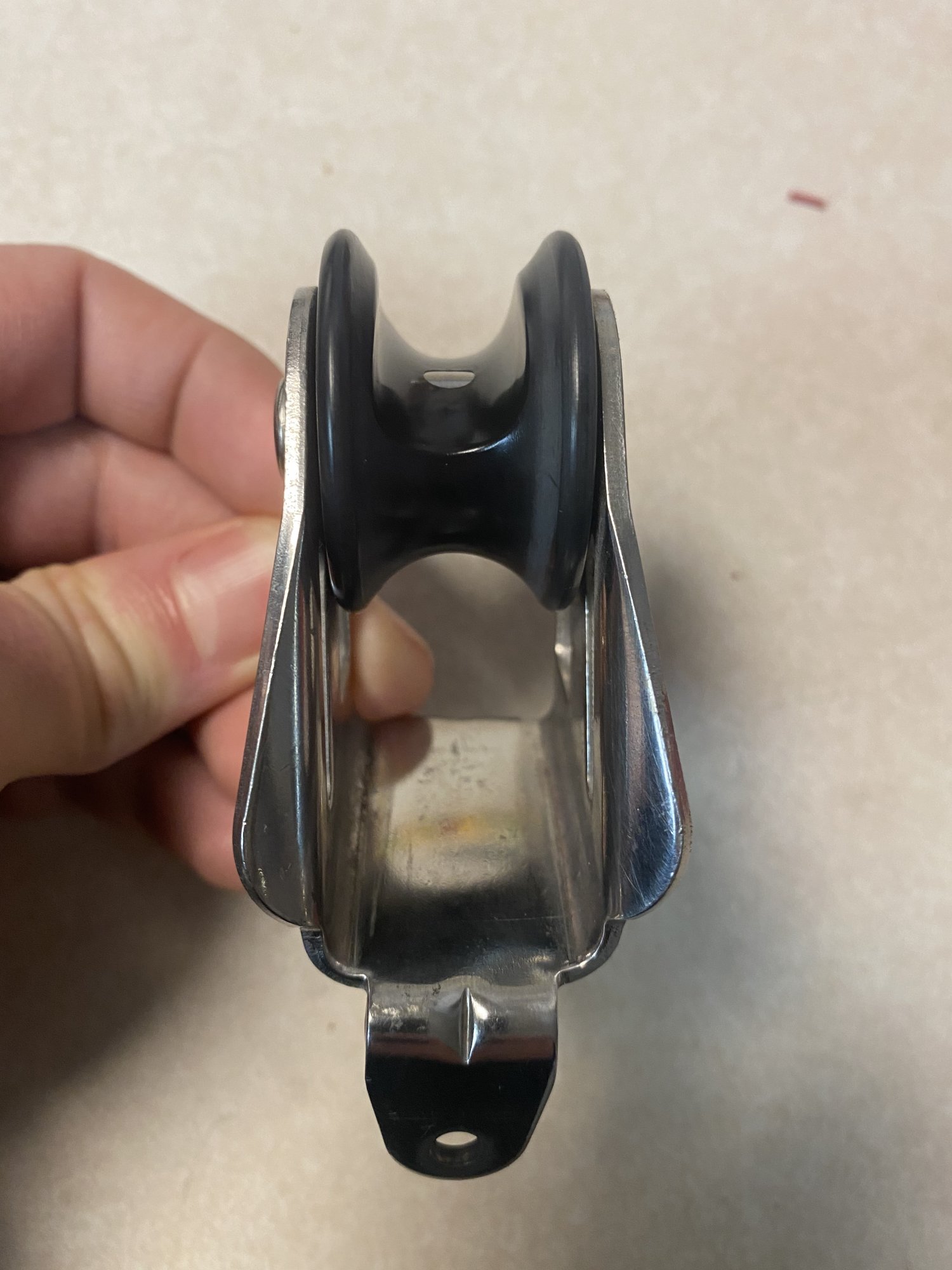

Thanks all for the ideas. To answer some of the follow up questions - the leads are 8 seasons old and spin freely, so I don’t think the flat spots are from having seized at all. I suspect once the flat spots started to develop the line started sliding more than spinning, and things got continually worse from there.
I have no aversion to Harken. I think the root cause is that Beneteau seems to have undersized this part. I’m pretty sure this is a HARG226S - a 22mm Pinstop car. (I need to take a couple more measurements at the boat to confirm, but I’m pretty confident from the measurements I have). Harken markets their 22mm equipment as “small boat” for boats up to 27 feet. We have a relatively small jib, not an overlapping genoa, so there might be some wiggle room there, but the boat is 37% larger than that sizing recommendation. All of the beefier Harken leads require upsized track with the slightly different hole spacing, thus my hope for a strong replacement from another brand with track compatibility. The Lewmar option has a 60% higher working load with the same hole spacing, so that’s an interesting middle ground. If I decide to go all-out and replace the track (or add a second one as Joe said) Garhauer is an interesting option.
Glad to hear Harken is responsive. I’ll definitely check with them. The shop at my yard says they wouldn’t be able to re-rivet a sheave like that, but if Harken would sell just the upper part of the lead and not the car that would be a cost savings I’m sure.
May 17, 2004
5,918
This is how flat the port sheave has gotten by the way -
The starboard lead is flat too, but not worn all the way to the pin yet.

Wow, that is weird, especially if the sheave is not seized. Perhaps with sufficient force perpendicular to the sheave axel axis there's sufficient friction to prevent it from rolling. That would be a sign of an undersized part. But then, it's a ball bearing sheave, so that shouldn't happen, unless some of the balls are missing or crushed. That could happen on an undersized block with Delrin balls. I would be hesitant to replace it with the same size part. But do see what Harken has to say. They helped me with sizing of blocks for my boat, and pointed differences in rating, i.e., strength, of blocks they make that otherwise looked nearly the same.

Who are you asking? :) I looked it up, it is, indeed, a ball bearing sheave. But, as I mentioned, if it is undersized, the Delrin balls could have been crushed.

Based on how it looks where the sheave wore down to the pin I don’t think it’s a ball bearing sheave. It’s not $400 though - I went to the boat today and confirmed the measurements match this 22mm car - 22mm Slider Car — Pinstop. With an MSRP of $214 and it can be found for $170.

The bearings are in the sheaves that adjust the position of the car, not in the sheave that takes the jibsheet.

The worn sheave is what needs replacing, not the entire unit. An aluminum sheave might hold up better if Harken has one that fits. Replacing the track will be a LOT of work, as well as added cost, and you may end up with leaks.

You could put it back together with a nut and bolt, through a tube that serves as the axel.

To give an update on the solution - After a little bit of time I was able to get in touch with Harken. They do sell the sheave and stainless housing as a spare part, separate from the car body. It’s about a third of the cost of the whole car, so that looks like the way to go for now.
