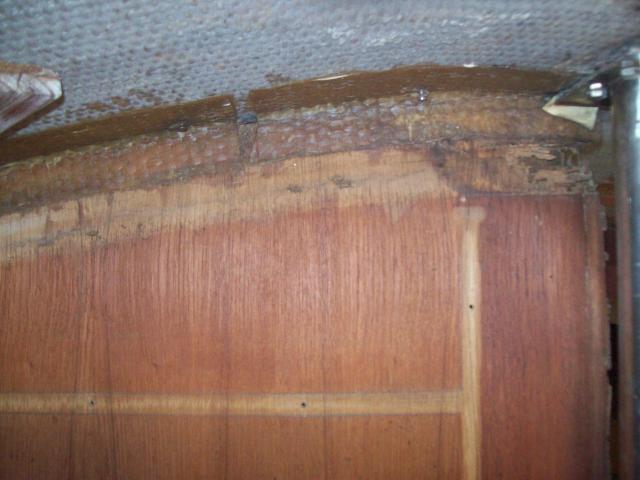

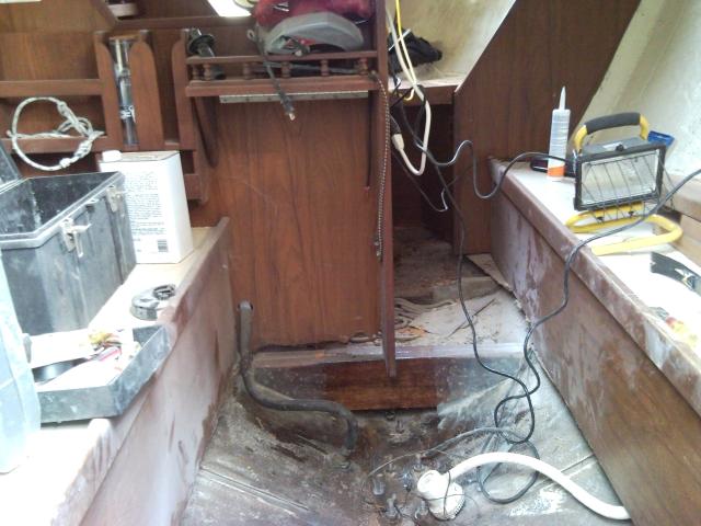

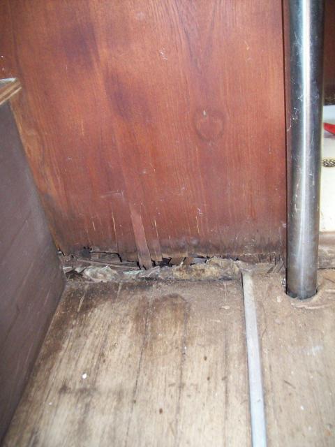

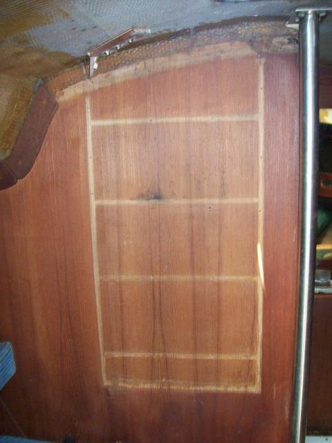

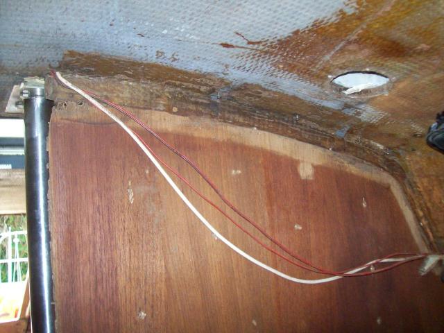

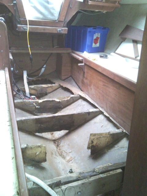

Did you look under your floor to see if the struts are affected by the mold? Cause mine were... I am going thru a complete refurbish of my seidelmann 25s right now.
Here's some pics that I took before and during the reparations... I know there's few air pockets in the fiber glass job :redface:...I have to sand and redo epoxy...
But Anyways you can see on the picture that I have the same problem than you. I don't want to replace the whole bulkhead, so I will trim the rotten part, an glue a new piece of teck. Then hide the reparation with a base board.
