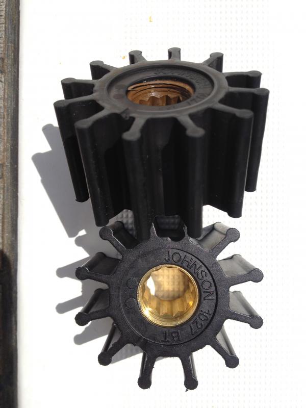

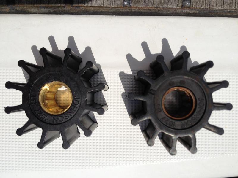

Attached are photos I took spring 2013. On the right (first photo, top second photo) is an impeller that spent two seasons in my Yanmar 4JH3E (and an interim winter, pickled in the pump in anti-freeze). This was an experiment to test wear under a Speedseal Life impeller cover. Other than some deformed impeller blades there was little sign of wear, and no cracking of the blades. I did use the ethanol-free AF.
This boat saw everything from the debris-strewn aftermath of H. Irene to a circumnav of Delmarva. Maybe 300 hours of engine time. Never freshwater flushed.
