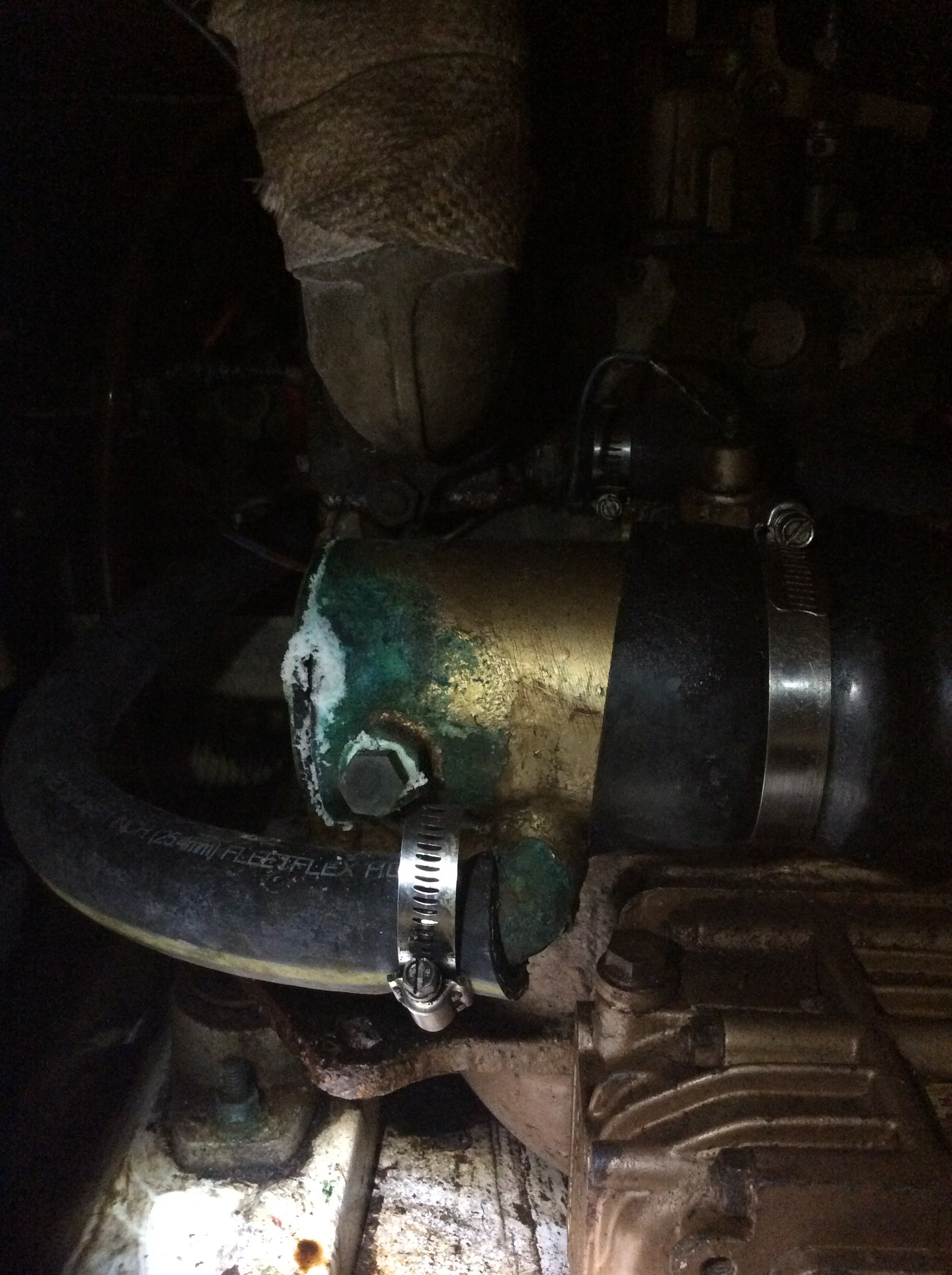

Any suggestions on things to keep an eye out for when doing this?
Close through hull, unscrew bolt and go for it ?
Is there a standard size that I can order and have on hand before opening ? Probably need to replace gasket also, green oxidation covering exchanger.
Any suggestions much appreciated!

Thanks for your reply. Are we talking 2 or 3" diameter? Hmmm.
I am so green that I don't actually even understand the rest of what you said.
The brass hex, I can see.... is that what I am replacing?
It appears there has been leakage based on the green oxidation and that I should replace a gasket too?
Open raw water..... Are we talking thru-hull valve?
Eek. I'm more lost than I thought!

The 3" HX zinc should have an 11/16" hex head. If you still have the 2 inch HX it may be smaller.
Do NOT isolate the threads to the HX. You should check it every 3 months anyway, so it isn't going to get stuck from galvanic corrosion. Check it regularly and get a "feel" for what works for YOU, not what anybody else, including me, tells you. Start with 3 months and go from there. If you take my advice, do it at 2 months!!!:):):)

Wow guys- thanks so much for your help!!
Got it changed - had completely eroded !!!
