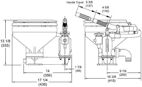

The PHII LBA is described as being 15 3/8" wide. How wide is the smaller PHC LBA? I can't seem to find its dimensions anywhere, and I'd like to use one to replace the WC Headmate in our Pearson 323 which has very limited width available in the head area.

Had to call Raritan to get it 'cuz you're right...it's not published anywhere, only the PHII dimensions are.
Base is 13.75" wide
Total width of compete toilet measured across the top of the smaller "marine" size bowl from outside edge of bowl to outside edge of pump is 17.25."

So, given that the PHII LBA base is 15 3/8", the PHC LBA's width of 13 3/4" should be 1 5/8" smaller.
Yet, the overall width of the PHII (with bowl) is given as 17 3/4", and if the overall width of the PHC is 17 1/4", this is only 1/2" smaller! That's not much. Something's not adding up...
And just to add further confusion, I finally came across this diagram for the PHC, which agrees with your 17 1/4" dimension overall, but has the base width as 14".

Yet, the overall width of the PHII (with bowl) is given as 17 3/4"...
Nope...18.25" See the first drawing on page 4 of the PHII owners manual here:
http://raritaneng.com/pdf_files/ph_II/L04v0505.pdf
You really want to quibble over a 1/4"? :)
Now...measure the base and overall widths of your headmate to see how close they are to the PHC. I'm 99% certain that you'll find the PHC will fit.
