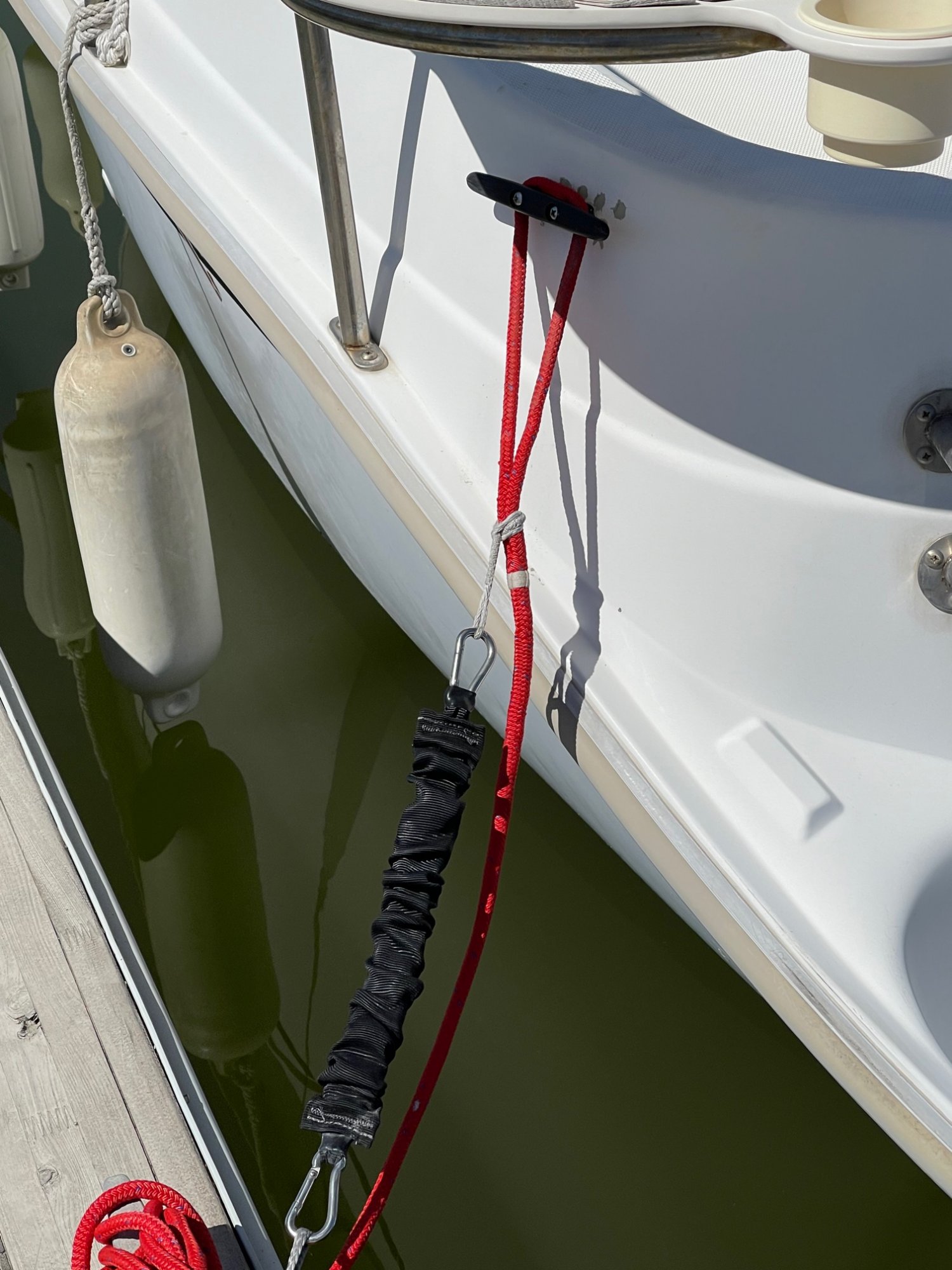

I sail on the Great Salt Lake in Utah and moor at the GSL marina. I now have had to replace the stern portside mooring cleat for the third time.
The steady wind just slowly works the cleat out of the imbedded aluminum panel. I have redrilled and retapped with increading sizes of screws, but they still pull out. Are there any suggestions as to how to fix this short of cutting an access panel from the ceiling of the back storage area?
Any suggestions are appreciated.

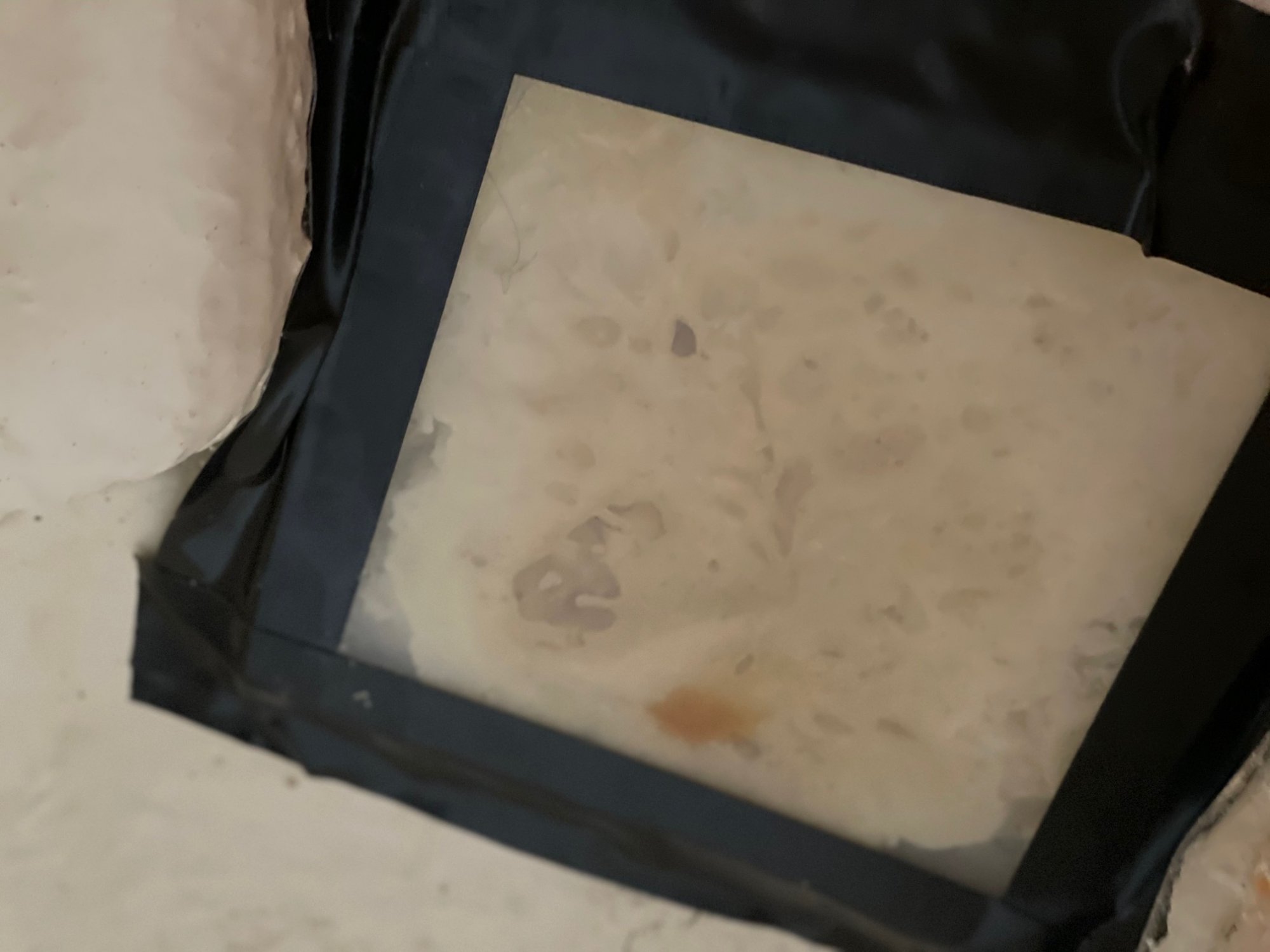

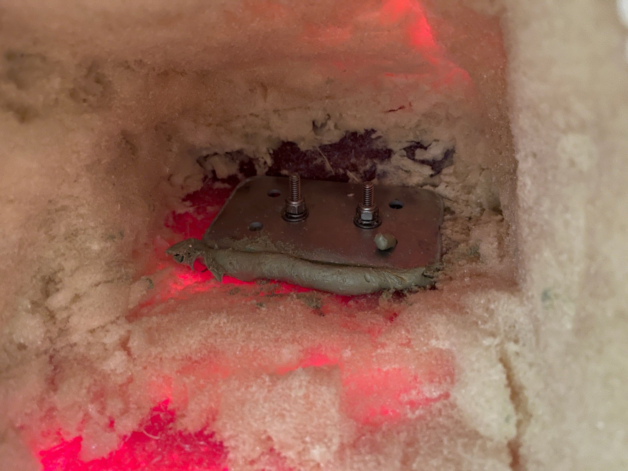

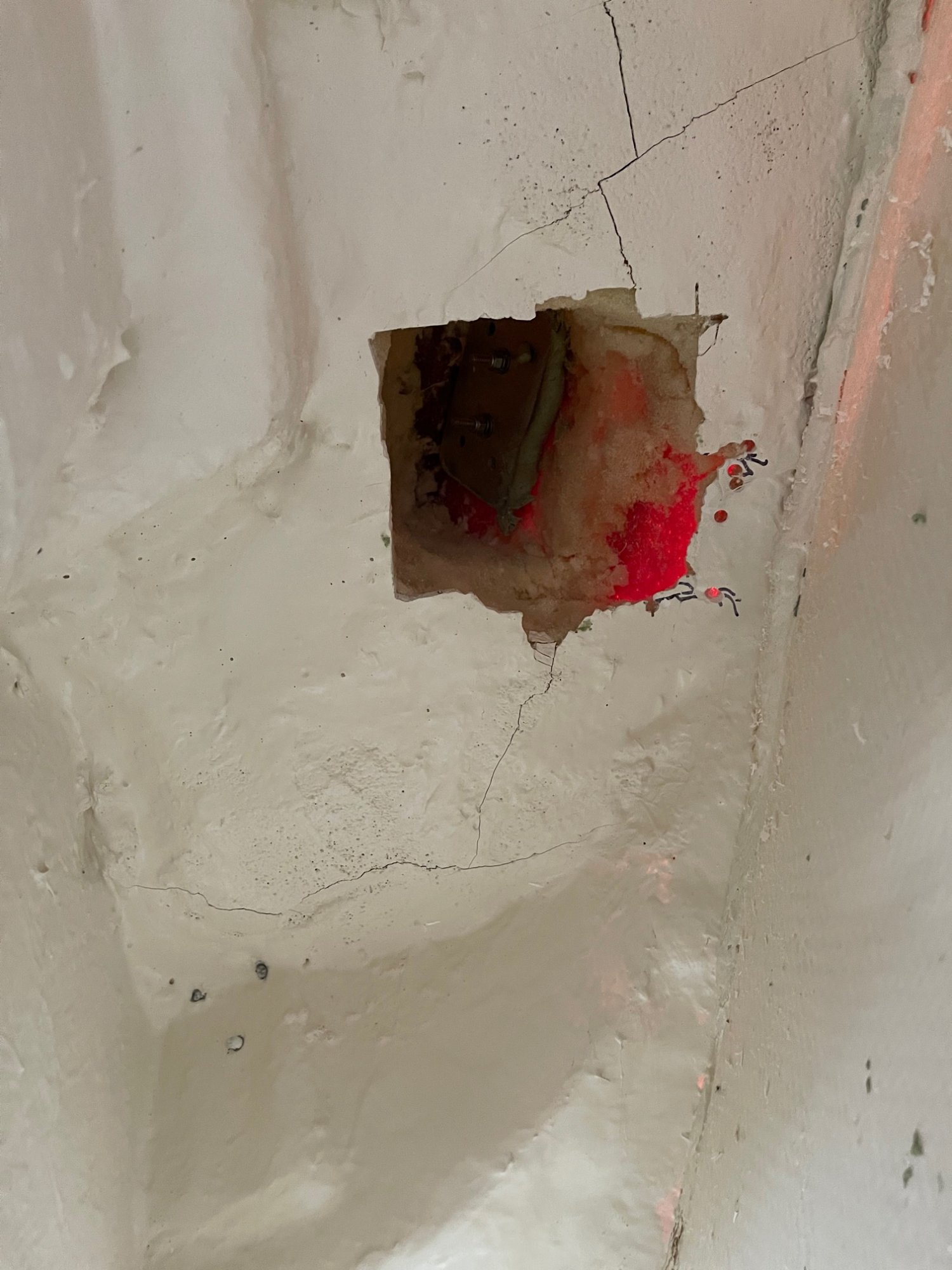

Finally can report that I complete the reinstall of the port stern mooring clean on my H240. Over the winter, I was able to find the location of the cleat, cut an access panel, dig out the foam, and access the area where the cleat had been located. I had to remove the "fence" that defines the storage area in the stern from the berth under the cockpit so that I could get as far back as possible. After doing some measuring from the inside and comparing to measurements from the outside, I found a spot to cut the "ceiling" of the area. I had drilled the cleat holes through from the outside and had inserted long screws to help me find the holes in the midst of the foam. The foam was a nightmare. I cleaned out the holes from all the prior installations and then filled them with epoxy. I drilled new holes for a better location going through the aluminum plate that had been glassed in by Hunter. I had measured and fabricated an aluminum backing plate to match the area and the holes. Since the backing plate did not fit flush against the angle of the bulkhead, I filled the area behind the plate with Total Fair epoxy and then tightened the screws just until the epoxy began to be pushed out. After the epoxy had cured, I tightened the nylon lock nuts against the lock washer and washer. I had made a slight countersink under the cleat and used butyl rubber to seal the holes. After completing the install, I filled the void with spray-in foam and then covered the area with a plastic access panel which I held in place with silicon and gorilla tape while the silicon set.
