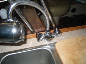

Grohe Brand...
Our 1991 Grohe galley faucet was discontinued long ago (also matching sets for both forward and aft head sinks and shower ensemble), but still works quite well and looks brand new. A few years ago, as I was on my run past this garage sale, a fellow had a sink with the identical galley faucet attached. I offered him $10 for just the faucet and he accepted. Now I have a spare that I will likely never use, but you just never know, eh?
That is a PUR brand water filter attached to the spout that I use for drinking and cooking.

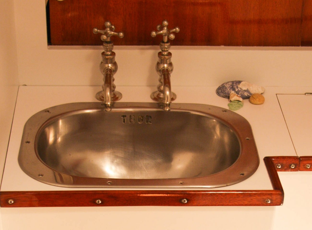

I've use standard (like Delta) household 'bar' fixtures in the galley of a few boats. 4" pattern, high neck, perfect fit, easily serviced. They have flow reducers that help and are easily adaptable to marine plumbing.
I adapted an old bath facet in the head of our boat. Uses easily replaced washers and packing. This fixture is fantastic for low flow. Old screw type handles, you have to really unscrew them to get much flow. That makes then perfect for the boat(and probably why they were taken out of household duty).
Yeah I know, it wouldn't look right in most boats, and they are hard to find.
