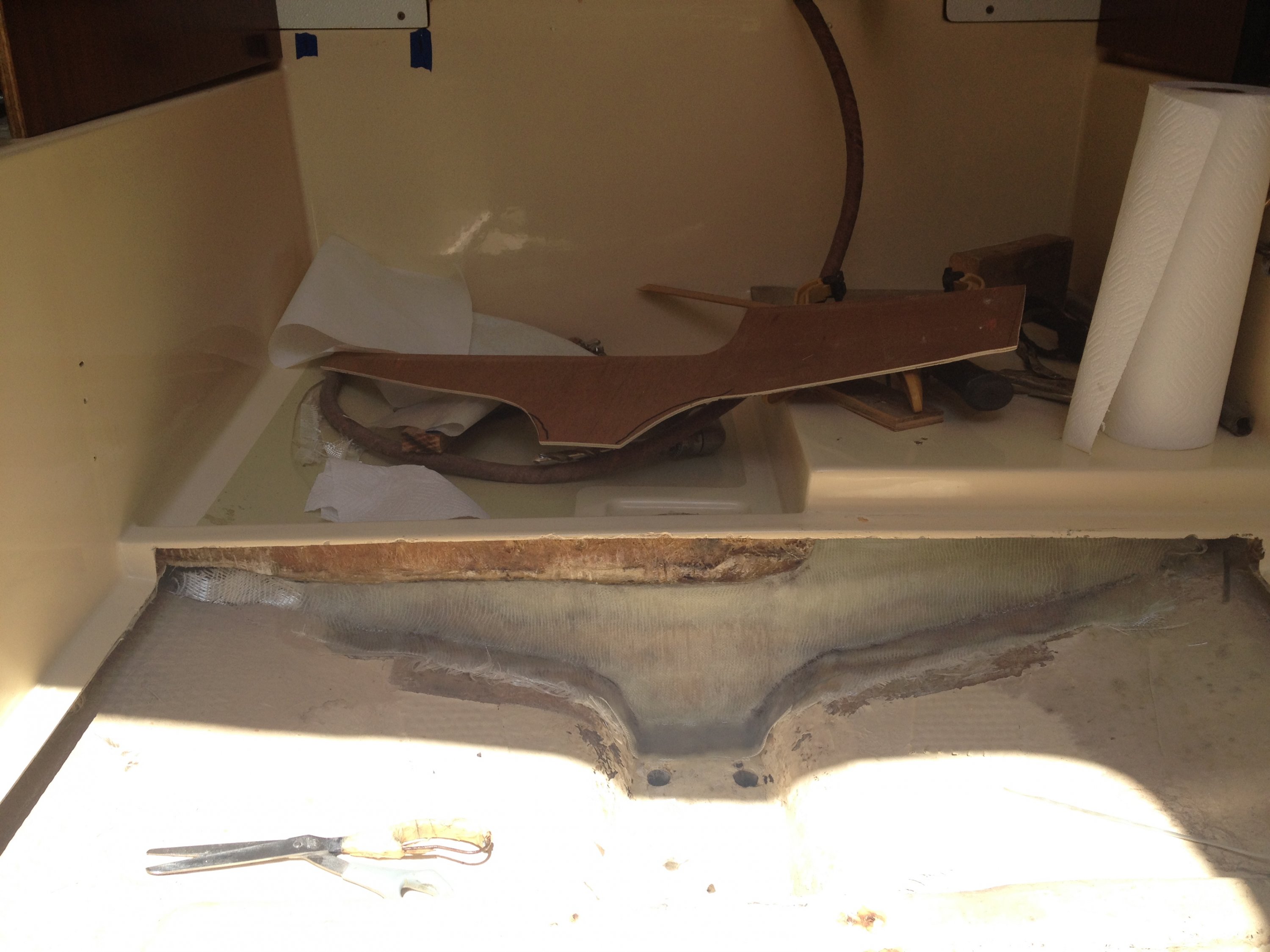

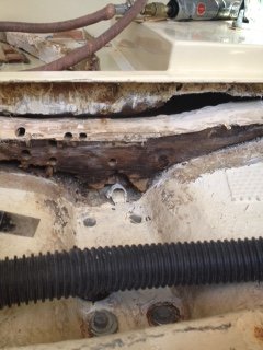

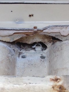

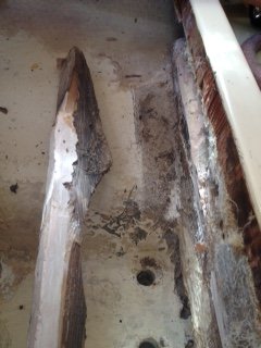

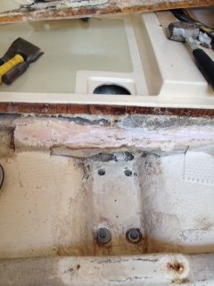

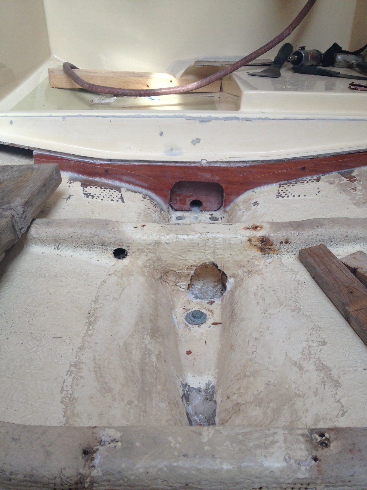

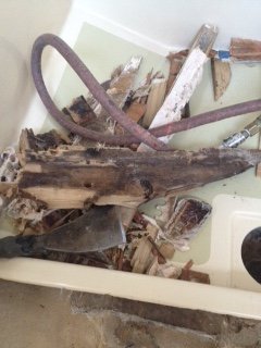

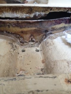

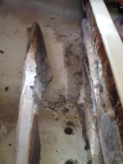

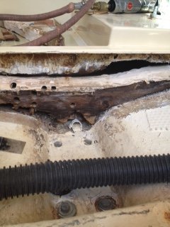

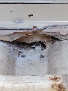

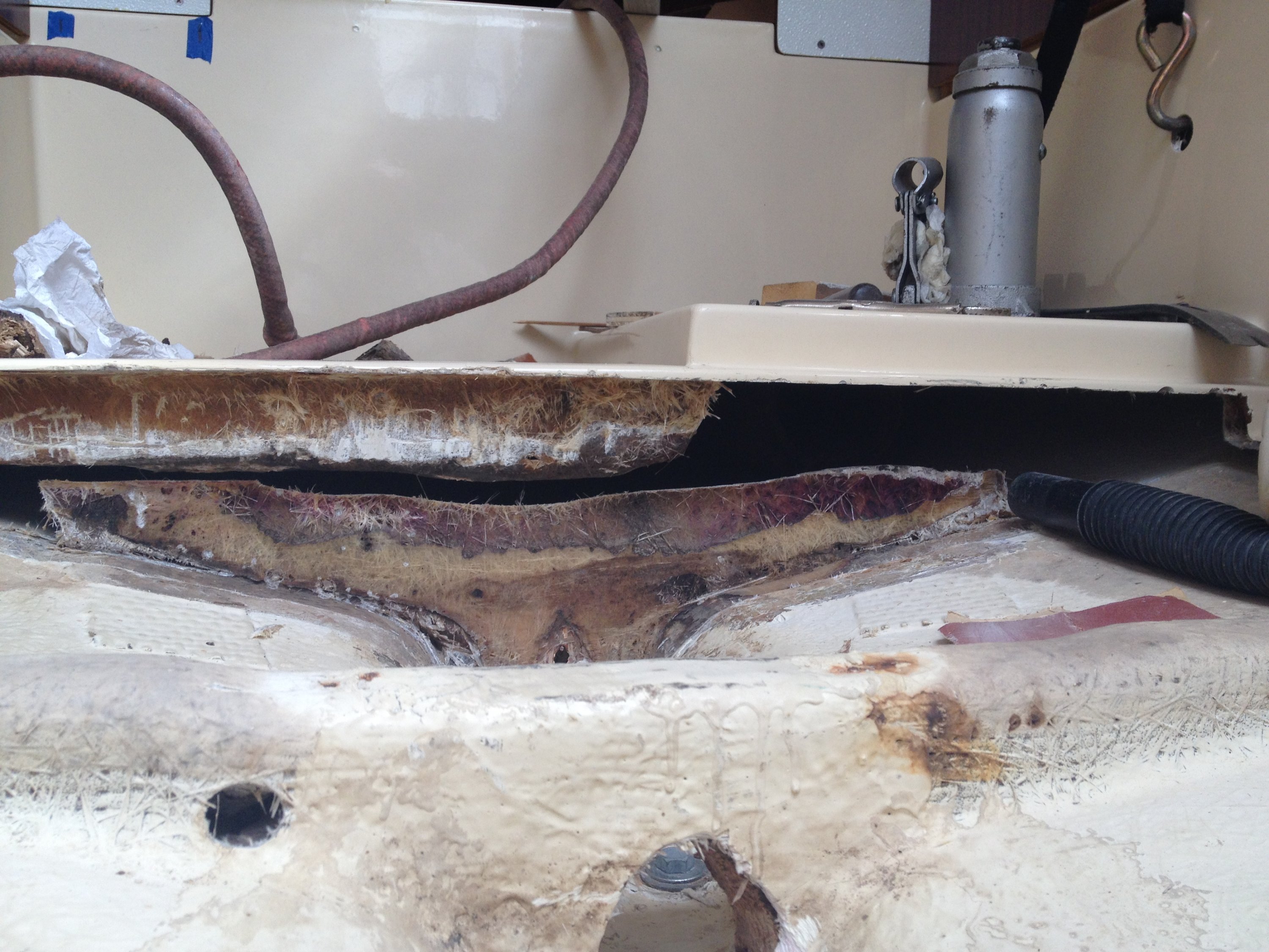

I have progressed in my H25 rebuild to the point of setting the main bulkhead and mast compression post. However; upon close inspection of the bilge area it was apparent that there was rot in the floor timbers around the limber holes and any other holes made for wires, screws, etc. I elected therefore to cut out the floor section and rebuild all the floor timbers.
In the floor at the main bulkhead there were essentially 3 components; 1) the main timber, to which an (2) additional timber was laminated to sit under the bulkhead, and (3) the framing in the floor pan. In assembly it appears the floor timbers were glassed to the hull and then a structural goop was applied to the tops of the timbers and then the floor pan/structural grid placed on top and bedded into the goop. This created many voids that trapped water.
I will build an e-glass web floor to join the hull to the floor pan and epoxy new mahogany beams in place. Everything will be sealed in glass/epoxy for a complete waterproof assembly.
I'll either build a flange all around the cut out and screw the old floor section back to it or build a grate floor of mahogany finished bright.IMG_1517.JPG IMG_1517.JPG IMG_1518.JPG IMG_1519.JPG IMG_1520.JPG IMG_1521.JPG IMG_1523.JPG IMG_1524.JPG

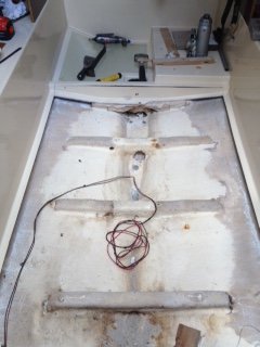

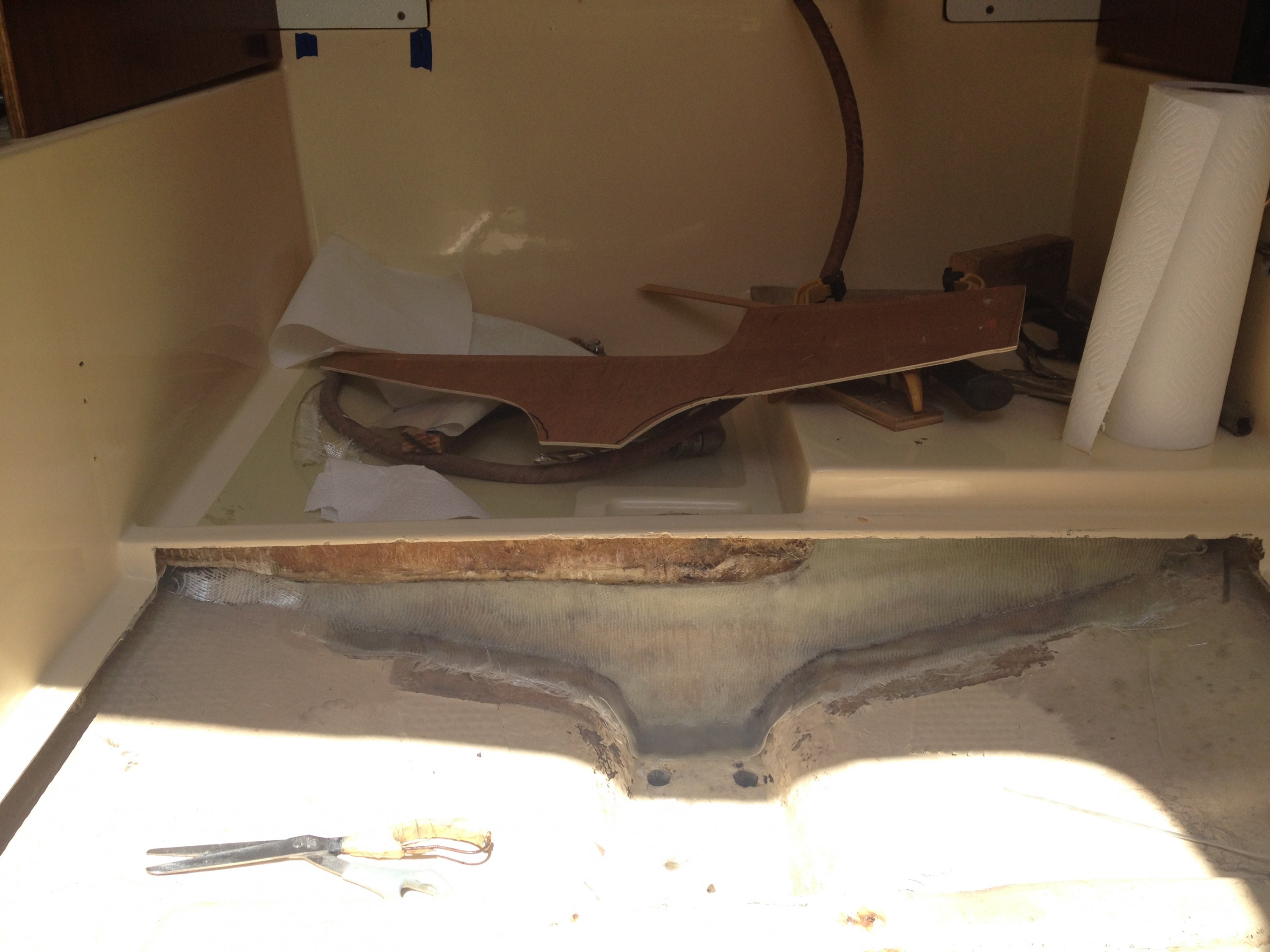

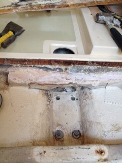

IMG_1525.JPG IMG_1528.JPG Epoxy/fiberglass floor web installed.

Yeah John,

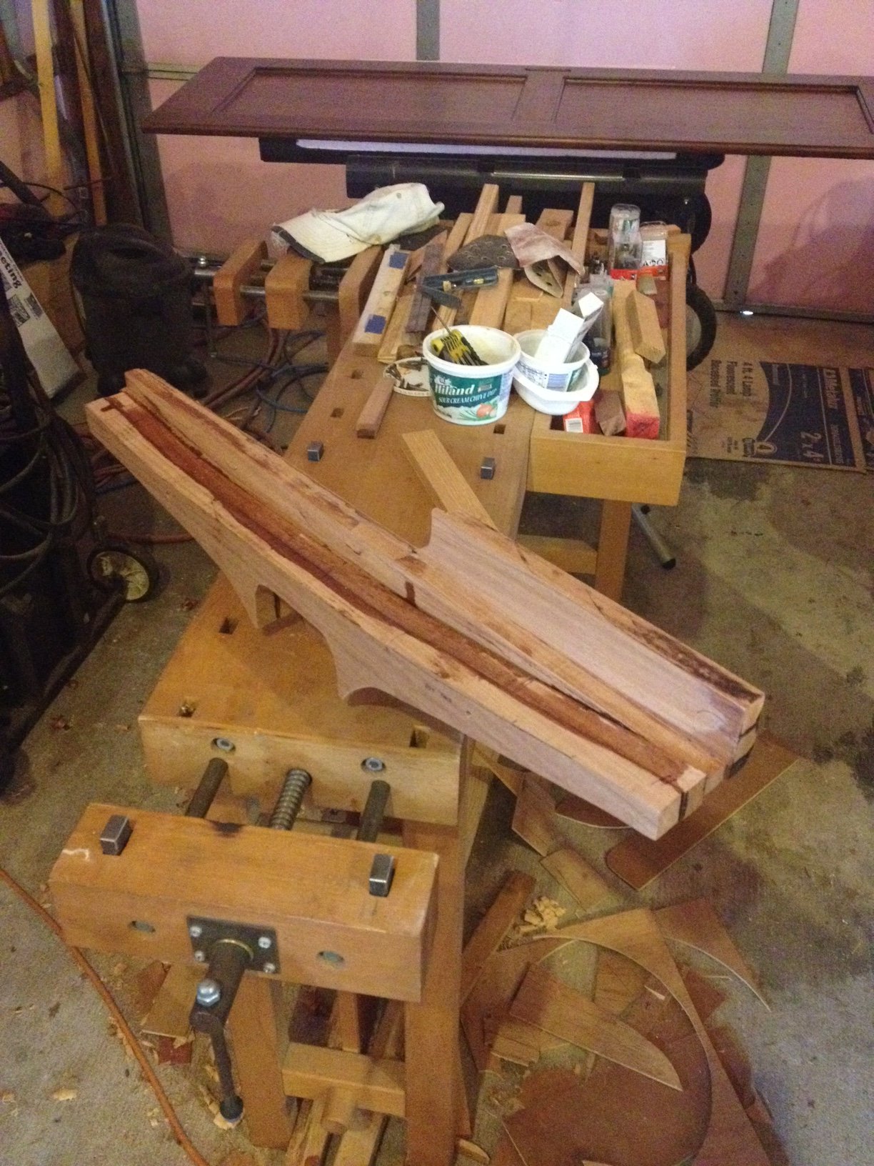

Multiple beams of mahogany will be laminated in against the fiberglass floor web and glassed in all with epoxy. The new assembly will be larger, stiffer, and completely join the floor pan to the hull in the compression post area creating more supporting structure for the main bulkhead and compression post.

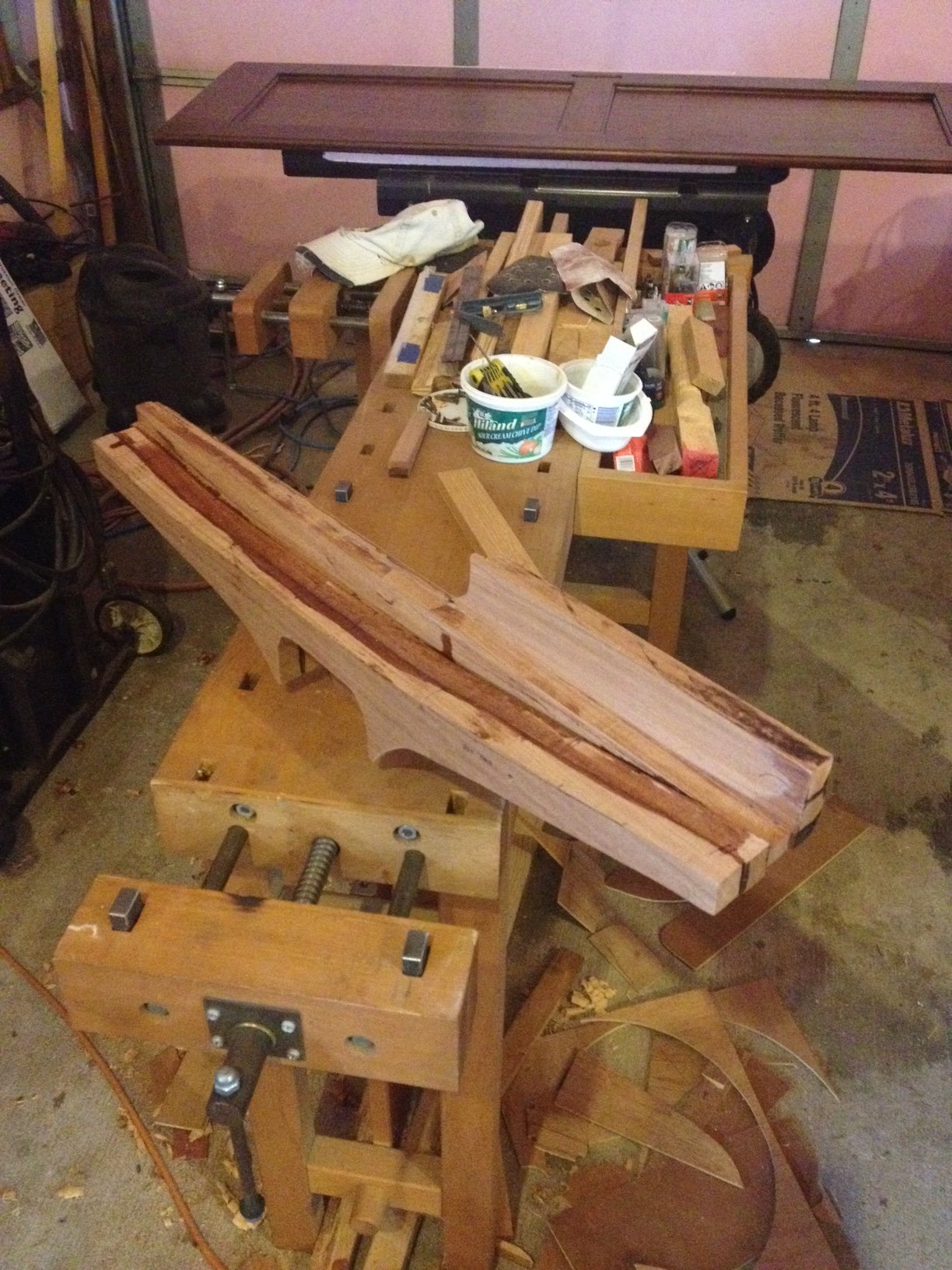

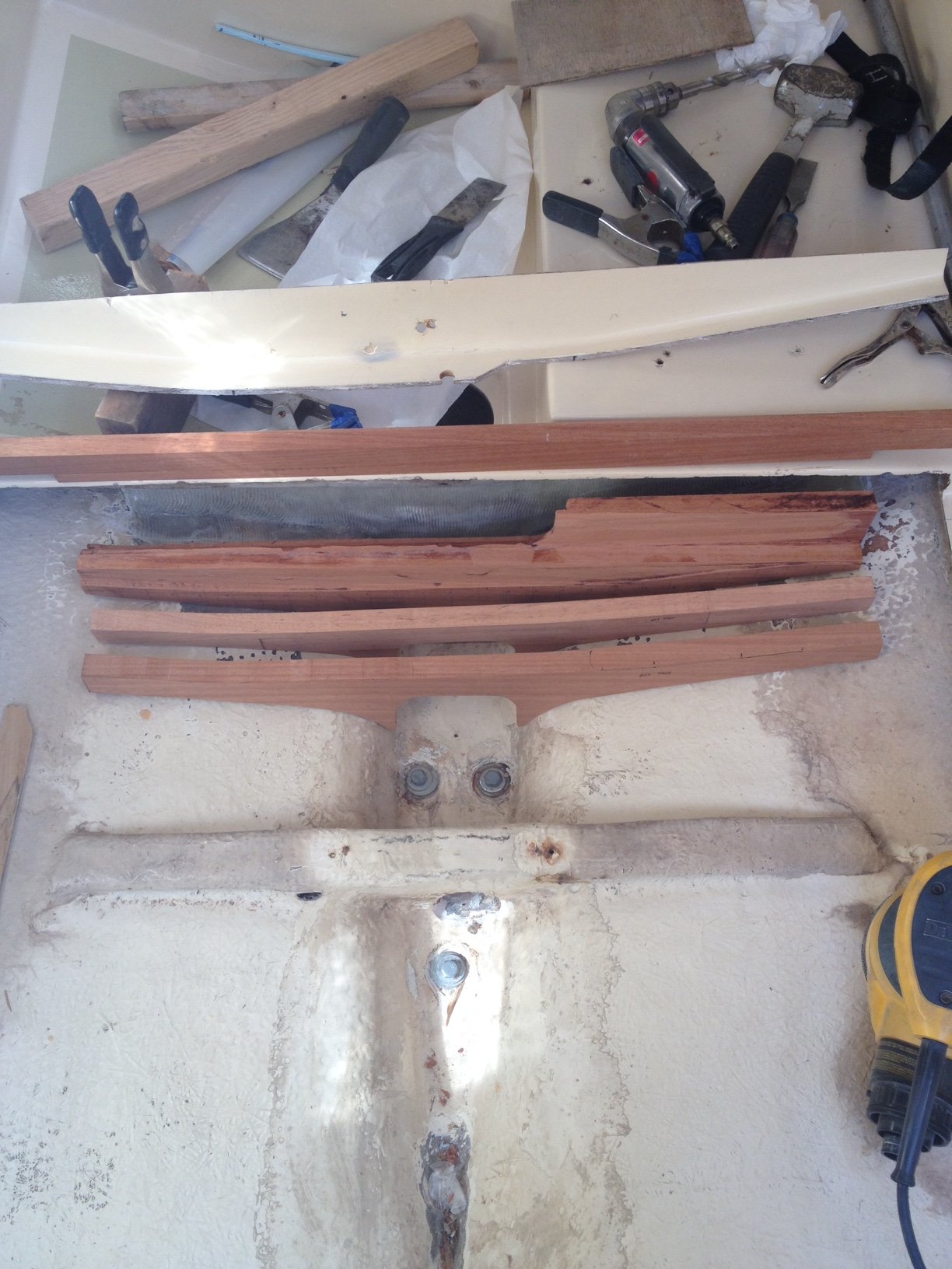

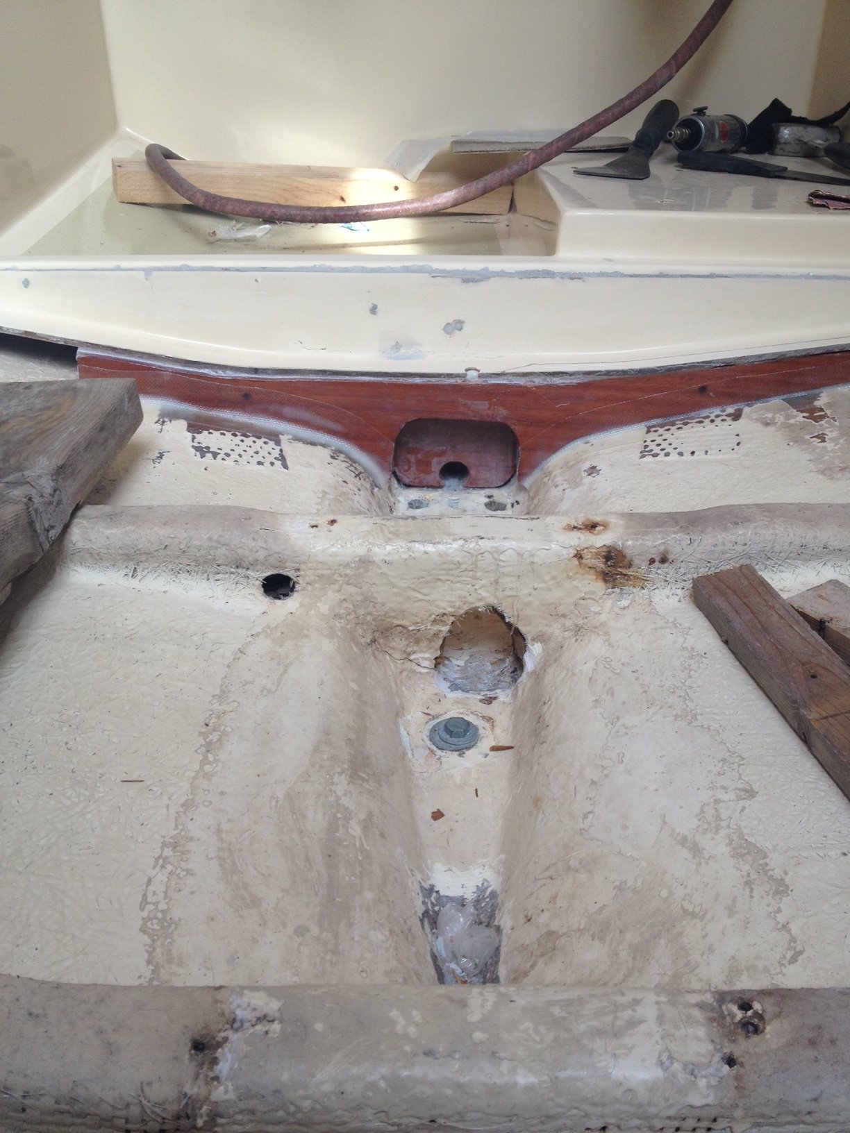

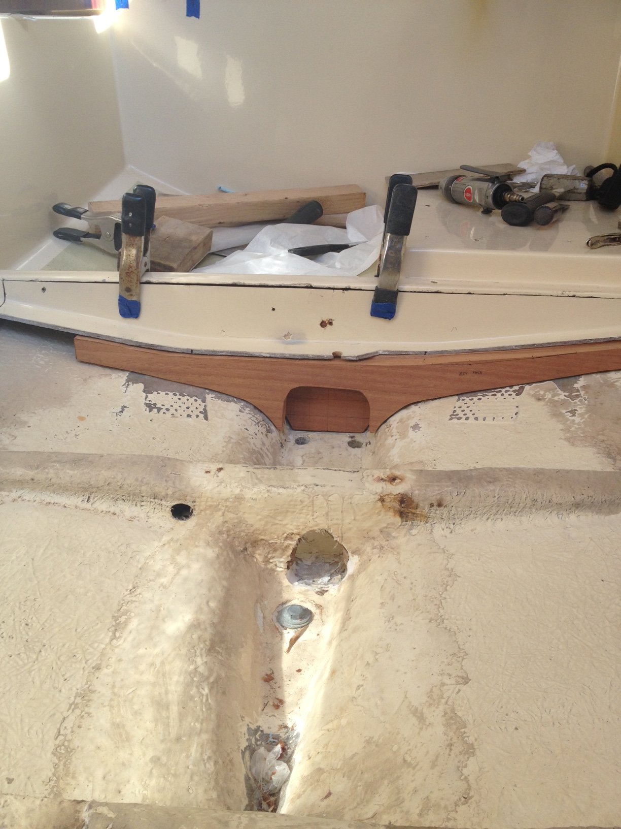

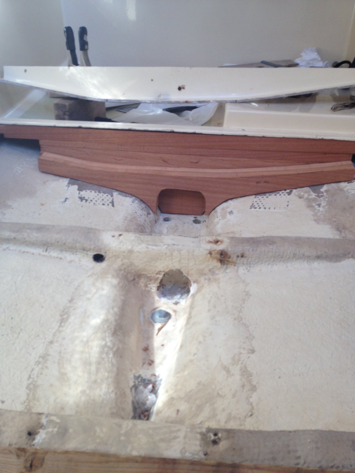

Floor beams at compression post shown individually and temporarily installed. Limber hole yet to be drilled. I will laminate the lower timbers together before installation.IMG_1532.JPG IMG_1533.JPG IMG_1534.JPG

Compression post floor timbers finally installed. A few details remain such as flanges for the floor to lay on etc. Then its on to the remaining beams replacement.

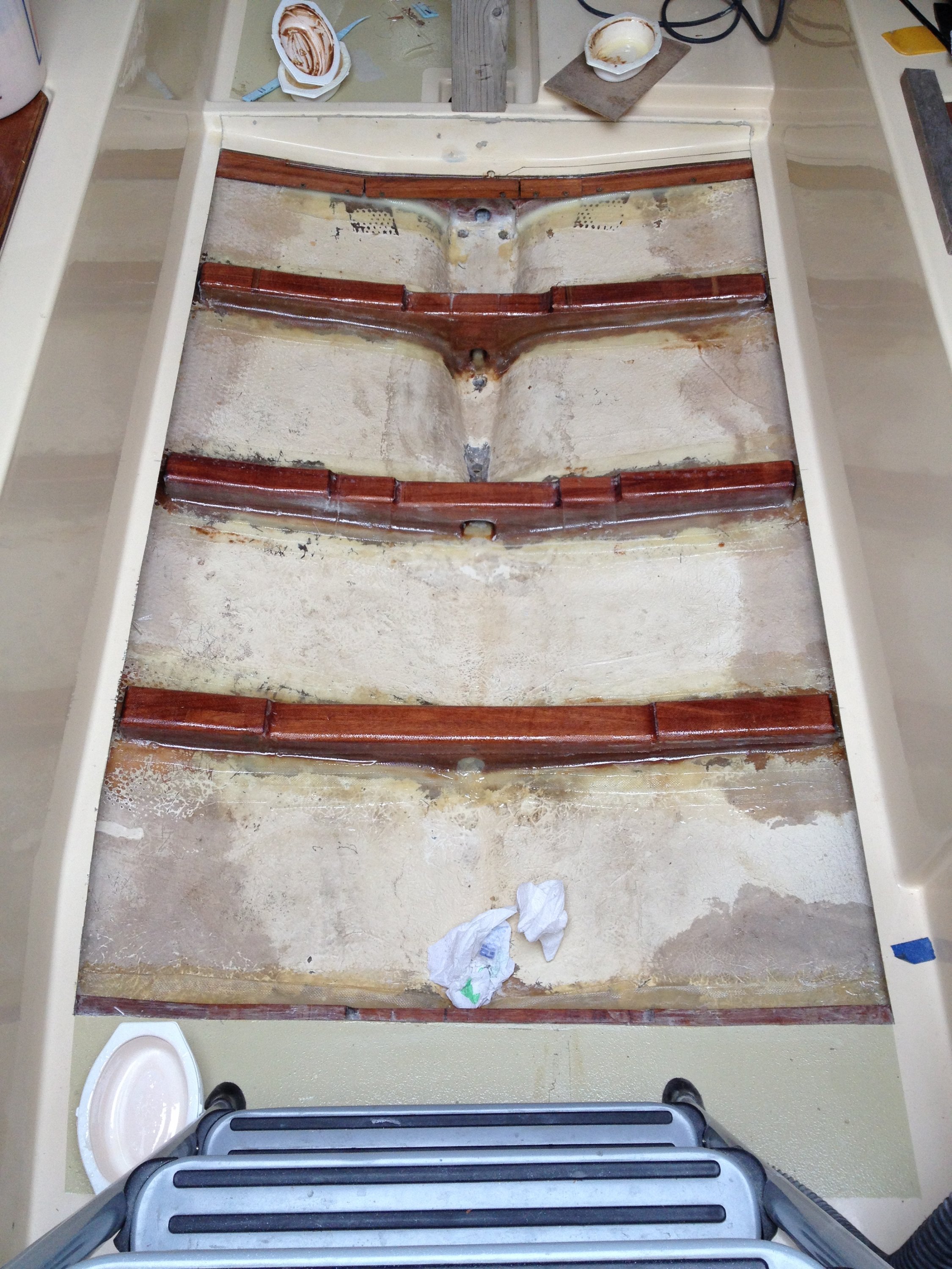

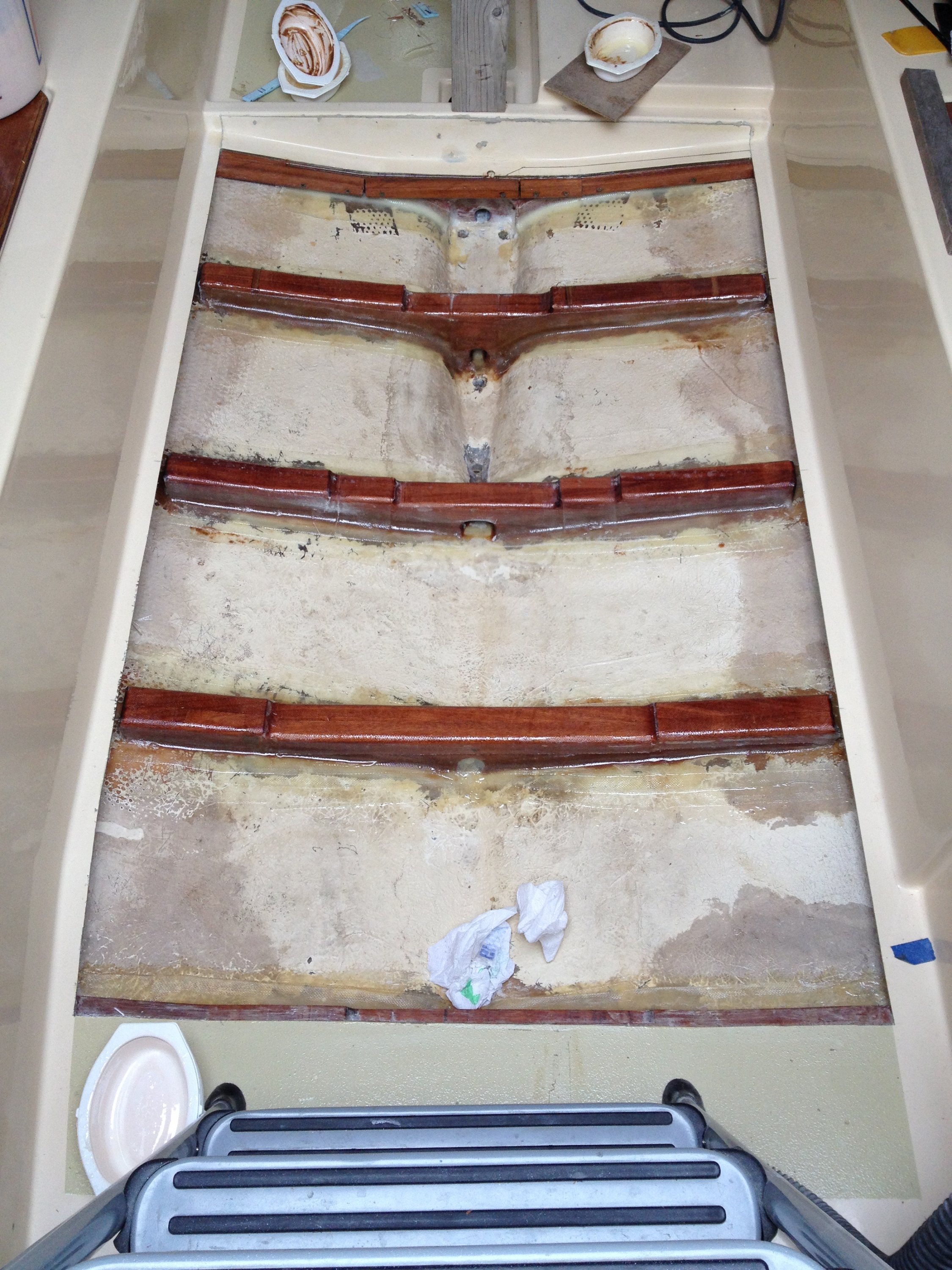

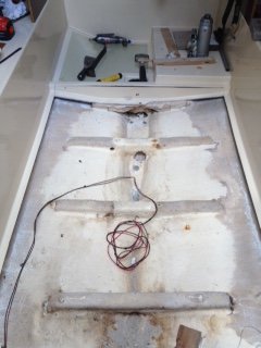

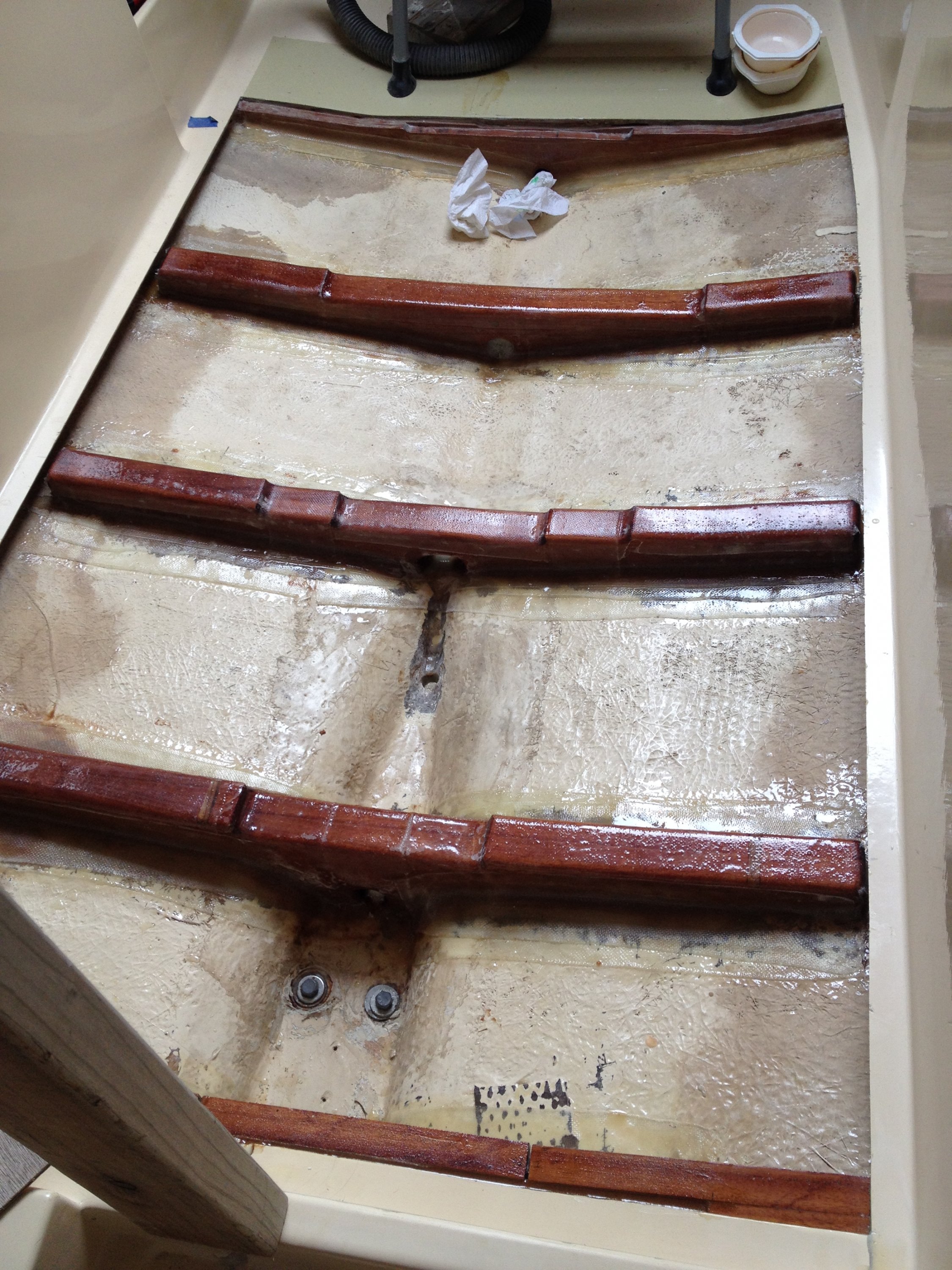

Update: 8/3/17
Today I finished glassing in the three remaining floor beams. Next steps will be to create a flange down the sides for the floor to lay on and paint the bilge before rebonding the floor. image.jpegimage.jpeg
