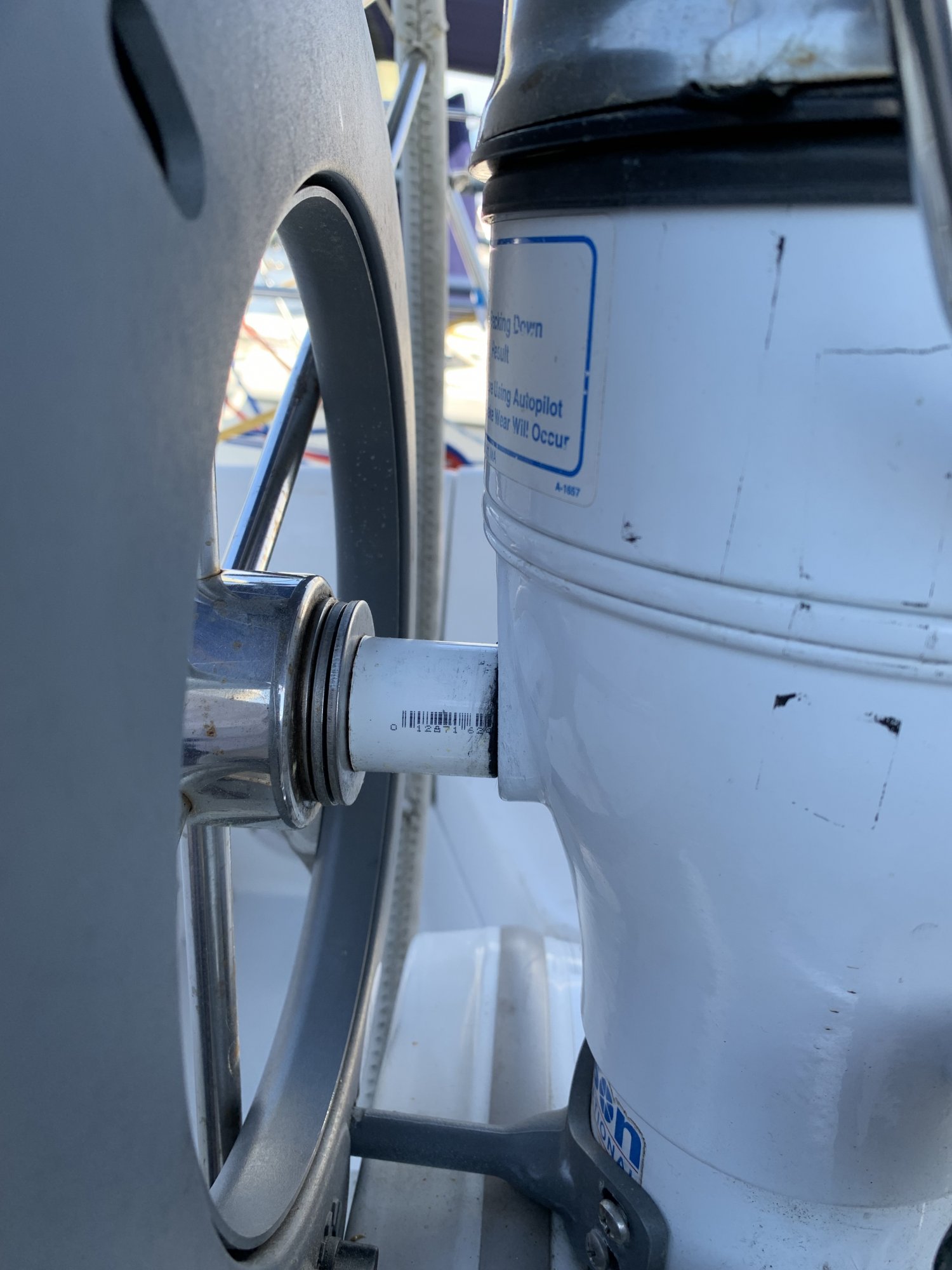

Obviously it is a Yanmar panel made for Catalina Yachts. The box stands out from the pedestal and interferes with the wheel and the wheel pilot. If this is the standard installation, it's obviously f#&^d up. That ugly notch that was cut out is to make room for the wheel pilot lever to function. (Also, the lever has been shortened to fit in this notch). The spacers are an obvious retrofit and the knob that holds the wheel nut in place barely has any thread to grab on to. In fact, if you don't routinely tighten it, the knob falls off. Sometimes, I come back to the boat after a week and the wind that makes the cover flutter causes friction that loosens the nut. I find it on the floor of the cockpit!

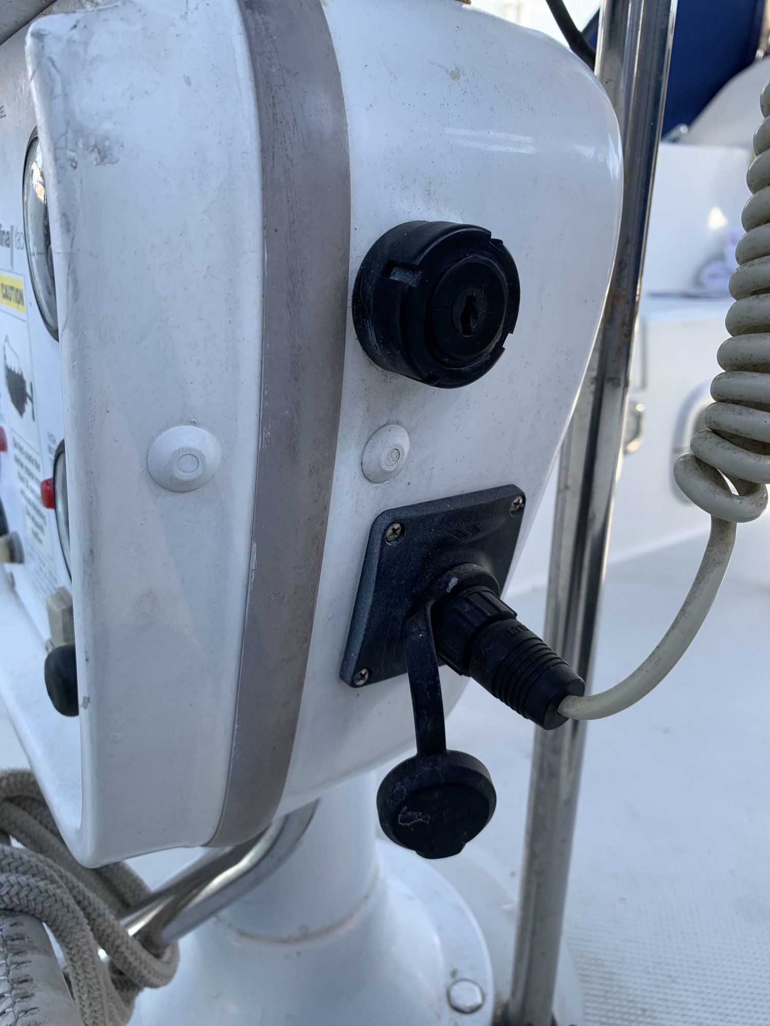

The problem is the part that sticks out on the left side of the gray band in the picture stands out so far it interferes with the wheel / wheel pilot. I don't even know how to remove it to take a look inside and I certainly can't find a panel dimension that matches the original.

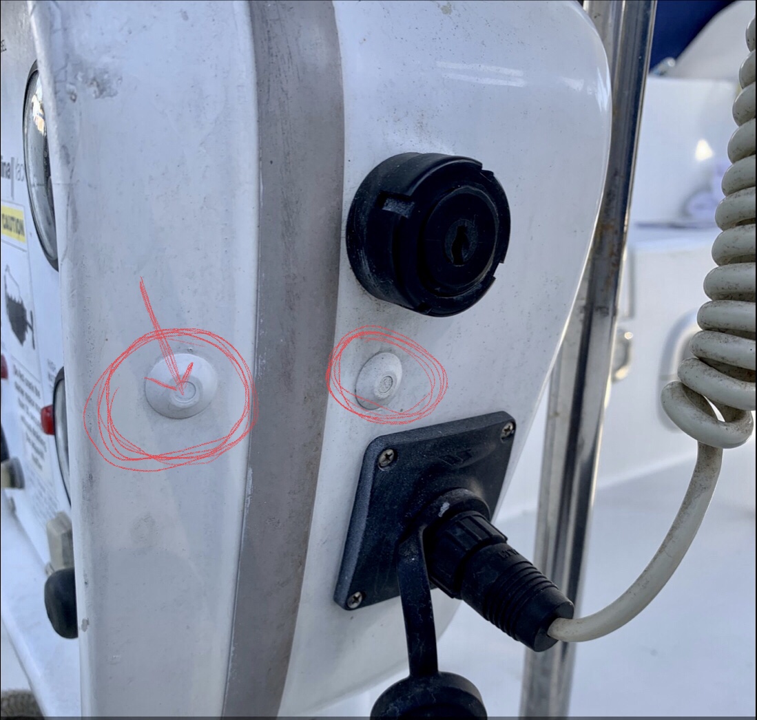

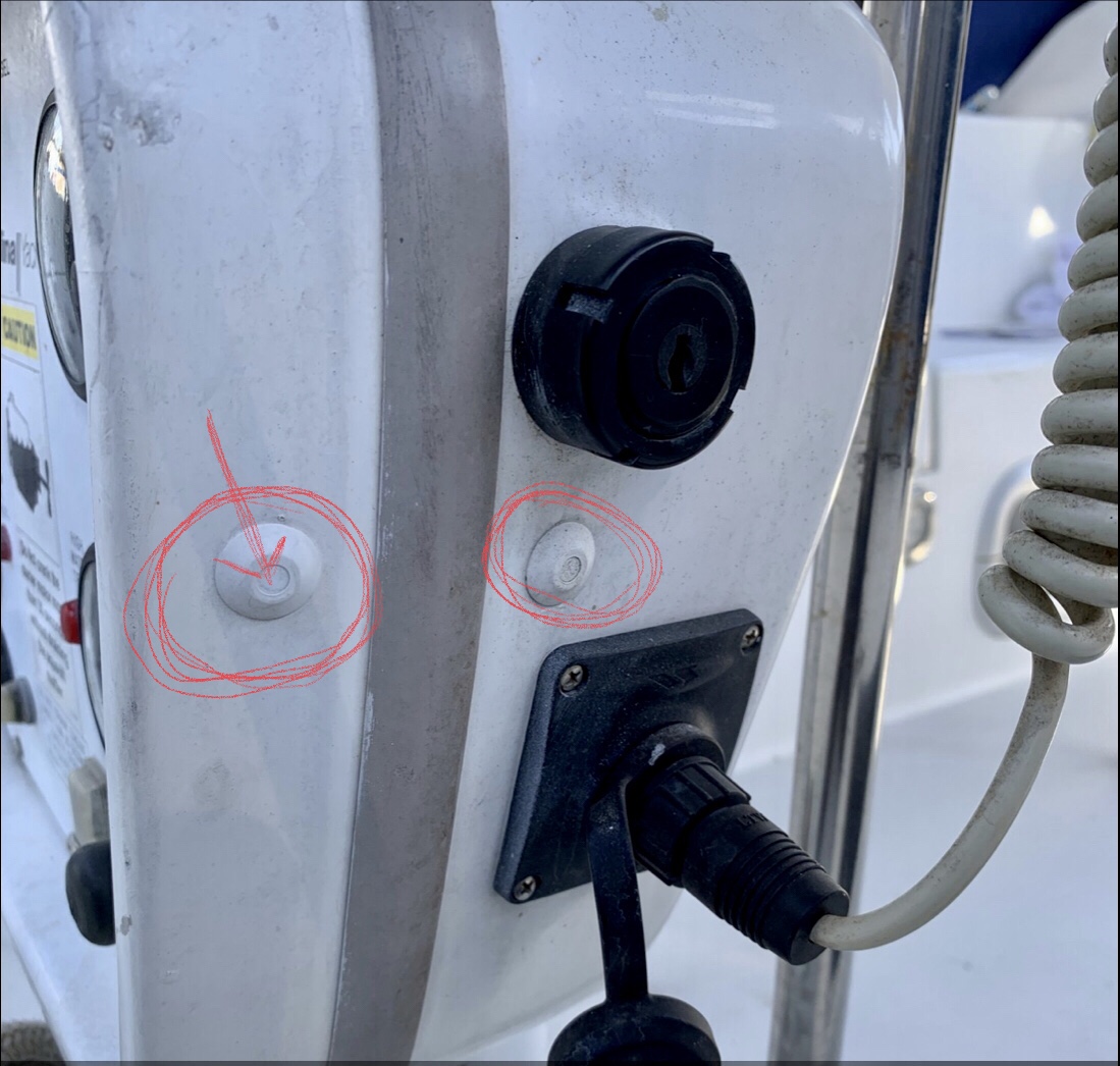

@Scott T-Bird To open your console you should be able to push in on the center of the buttons I circled in your pic. Where the arrow is pointing. Then you will be able to pull the plastic rivet out and that should allow your face plate to come off.

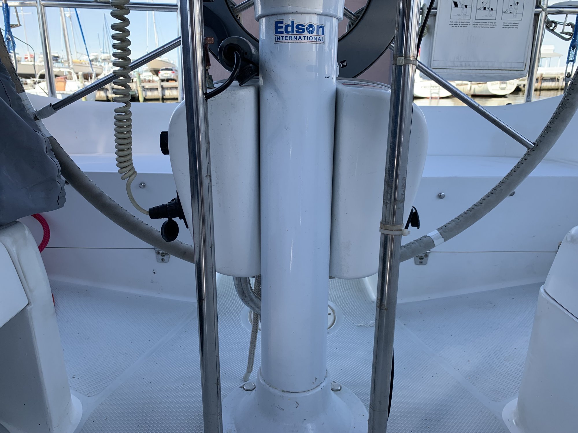

Hey Scott, Maybe time for a home built solution?
I'm thinking something that puts the gauges on both sides of the pedestal and goes deeper behind the pedestal. The front face plate can still be the full width side to side to join to the two sides.
Might be able to find two rectangular nav pods and mount them vertical on each side of the pedestal or vertically on the pedestal guard.
