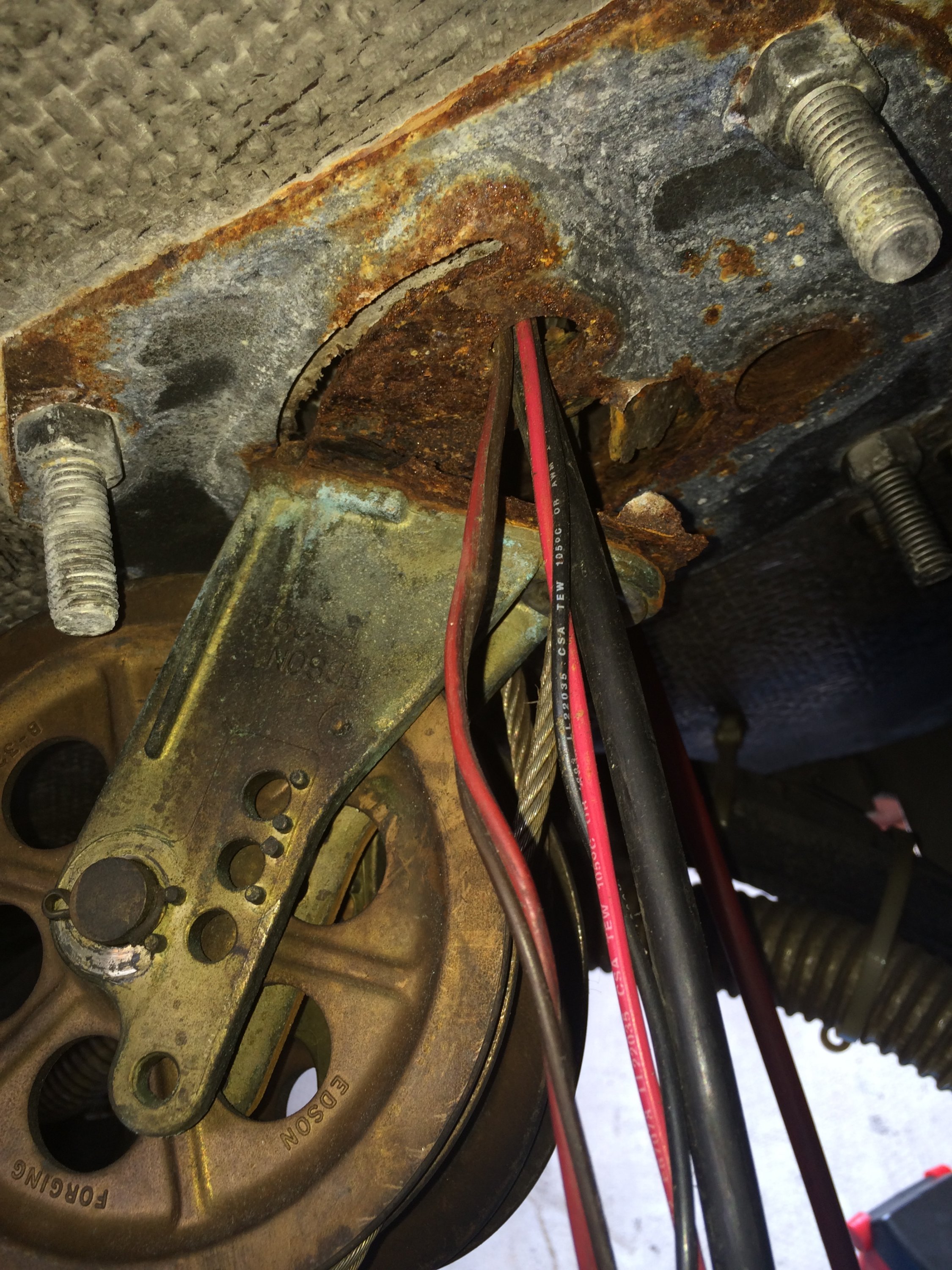

This is a repair that I made immediately after FH was commissioned this season... Once our dock master slipped our vessel, he notified us that our steerage was extremely difficult/stiff. Once aboard, I realized that we had no steerage at all. Upon inspection, which required crawling through the sail locker and up under the cockpit sole to sight the pulley that redirects the chain (vertical to the helm) to cable (horizontal to the rudder quadrant). The photo attached shows what I discovered. Without warning, the pulley let go. What transpired after that delayed our shakedown cruise by almost a month. Making a long story short- we DIYed it, had to remove and replace the chain and cable, drill out the pedestal bolts as these secured the base plate which is where the failure occurred. The Edson staff was extremely helpful throughout the whole repair process, answering every question we had during each call. Word of note here, the pedestal bolts were made of aluminum which it was suggested by Edson to replace with S.S. So if you don't know where or how to inspect your boat for potential repairs or routine maintenance, you will at some point get caught off guard. I do recall somewhere in a maintenance manual, to inspect this stuff, but I learned the hard way, and it could have happened at a much worse time.
If I can help any further, I have more photos.

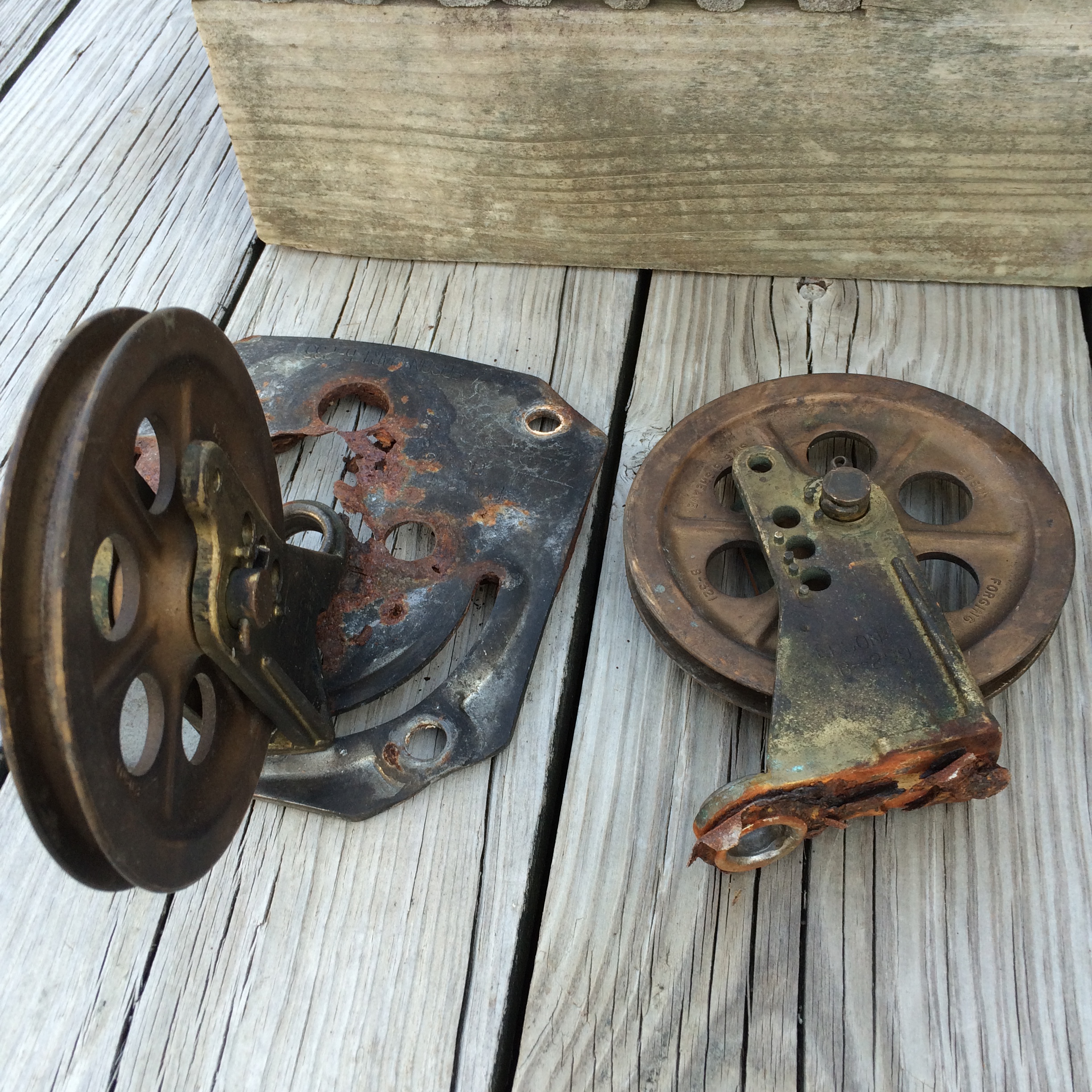

This is what I kinda found on my 79' Hunter C a while back. Not quite as bad but on it's was back to nature. I found one on Ebay that came out of the fresh water great lakes vs my Florida waters part. I have painted All bare metals with Par 15 as needed. My chain had been well greased and no corrosion had taken a foothold so I reinstalled it. Yes Edson suggested I replace it and they were Great to work with.

wish i had known...... i have a YS base here that i am going to have to get rid of...... it is in good shape ...if you know of any one that needs one tell them about me so i can dispose of it to do someone some good....(sorry i know that is just what you wanted to hear)
Thanks for the thought Woody. But I did get a good deal on the used Edson pedestal which should serve me well as parts are available,,, not cheap,,, but available.
