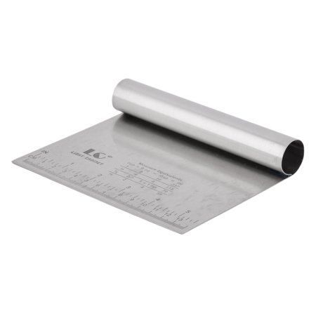

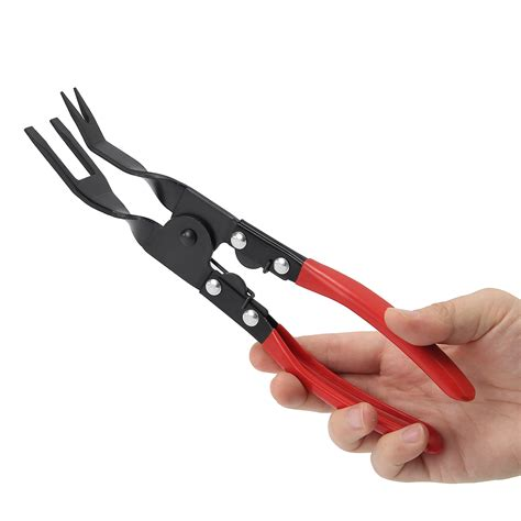

"a few odd tools I found essential are a dough scraper (available at dollar tree) and a automotive trim removal tool. Both can be used under a fitting to help pry or pull it up. I've been doing this project solo so getting fasteners off from one side only has been essential. The scraper has been useful in protecting my ancient gelcoat and if I push it against the threads of the screw it'll help pull it up while I unscrew it. I've also used a knife or a fingernail if there isn't enough room to get the scraper in there. The trim/panel tool of course can be used to pull a fitting upwards but I've also been using it to pull the head of the screw up while using an impact driver. As you can imagine this pulls the nut against the fiberglass and is usually enough friction to keep it from spinning. "
An electric impact gun with sockets, wobble extensions and adapters as well as vice grips and gorilla tape was essential. Gorilla tape and Bed-IT can be used to keep a fastener from spinning or keep it in place just long enough to thread the screw/bolt. You will lose fasteners. Do not try to save all of them as it will add a lot of extra time. Try to estimate the number and sizes of fasteners that need replacing and then assemble a kit. Bolt Barn and Bolt Depot have reasonably priced fittings. Since my boat is in fresh water I used zinc plated washers. Rust stains will tell me that there's a leak. For backing plates I would double up fender washers or for higher load areas I used Unistrut washers. They're very thick and will most likely outlast the boat.
