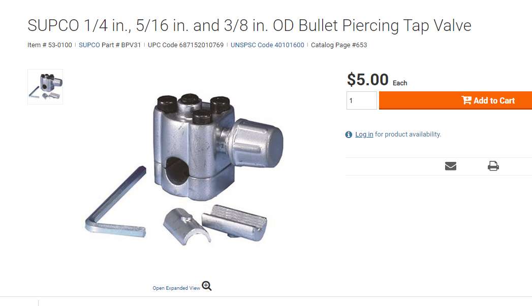

Have you checked the compressor windings for shorts or grounding, resistance? This is detailed on the Kollmann site.You can try adding refrigerant - Mine was R134-A - same as car A/C. Accurately measure LOW pressure line - (this is either the pigtail dead-ending up from the compressor) or locate the line from the evaporator (refrigerator) to the compressor. Measure the line accurately - may be metric tubing. and attach a piercing valve. The pic below is for concept only.
