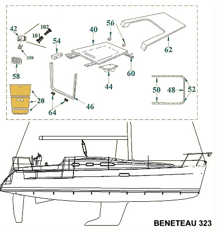

The top sliding lexan companionway on my 2008 Beneteau 323 is badly weathered and I am looking to replace it. I would like to hear from anybody who has experience with that job.

Yikes! That is almost a boat unit. I would definitely look for a local plastic supplier and fabricate your own.
I can't imagine that the existing hatch cover is so weather beaten that a little bit of work with a buffer and polishing compound would not salvage it.

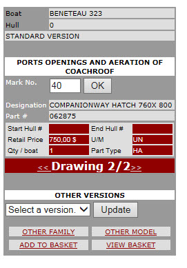

Thanks! The sliding component alone (item 40) is $750 and it looks to me like the easiest to fabricate myself starting from a blank 1/2" thick piece of acrylic. I would prefer to match the greenish tint on the hatches elsewhere on the boat but haven't been able to find that color yet.
