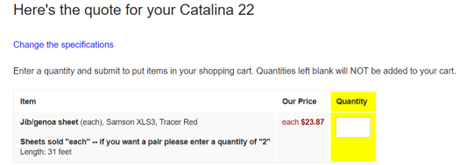

That length likely total for two or 27.5 ft each obtained that from a Catalina 22 owner on this forum. Catalinadirect says 40 ft of 3/8" Sheet, Jib, CP-22 (catalinadirect.com) and sailboat owner.com store below says 31 ft of 5/16" Running Rigging Calculator (sailboatowners.com). Given the wide discrepancy is why I always advocate measuring the maximum length required for all the sails.
