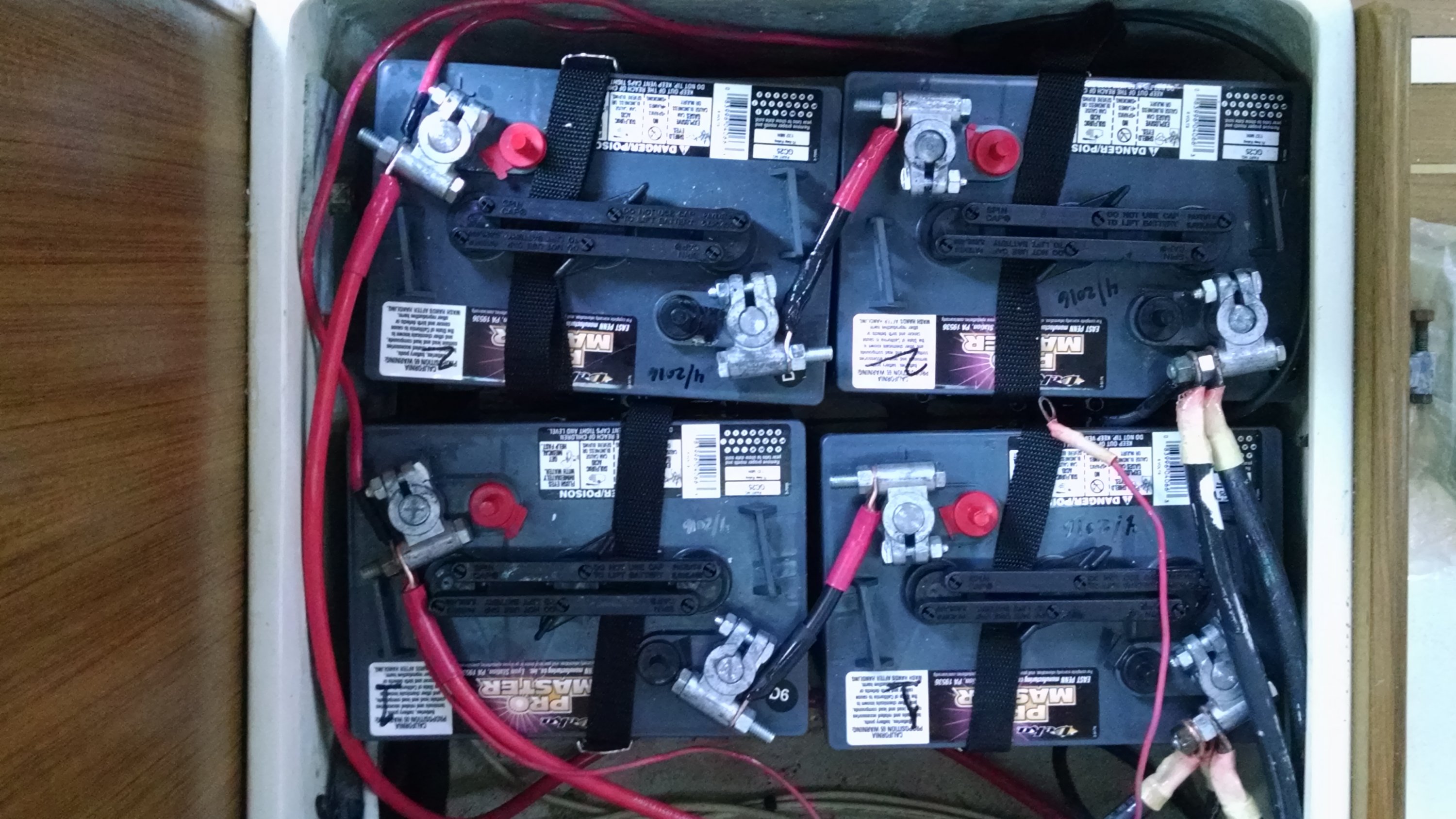

Catalina 36 Mk II Salem, MA
This spring we replaced the 2 old 4Ds in our 2003 Catalina 36 with 4 Deka GC25 golf cart batteries. At 235 amp hours, the correct charger size would be 47 amps (10%), but due to space constraints we installed a Charles 40 amp charger (after the OK from my battery guy). So far things are great: Batteries hold their charge, and recharge quickly on shore power or our Honda EU2000i generator. I can recommend this approach.
