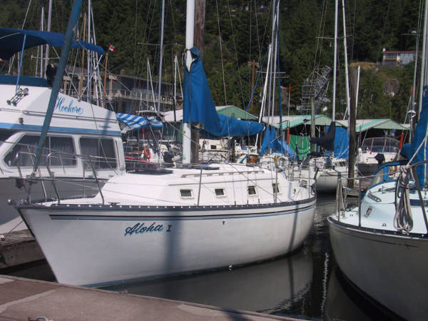

What an outstanding response!!! I am both surprised and appreciative at the same time. I never expected such a prompt and well rounded reply. Thanx a lot. Jane, (the Admiral), and I have a survey and sea trial scheduled for Thursday. We're very excited and look forward to getting to know some of you thru this site, and maybe even out on the briny. I've included a photo of the object of our desire for all to see. I'm sure i'll have more questions as we go, so i'll just say talk to you later...

May I put your picture on the Hunter 30 site I'm buiding?

Absolutely....We would be flattered...
We have already taken several pics and the title hasn't changed hands!!!! But she shall be ours and if you wish , you'll be able to watch the upgrading process, step by step. We did have her surveyed last week, and, just as predicted on this website, the compression post was badly corroded, and needs immediate attention (a definite negotiating chip in our favor). As well, the skeg needs to be re-sealed to the hull. Other than that, the issues are no more daunting than you would expect on a ship of her age. So we are quite excited and looking forward to enjoying her.
