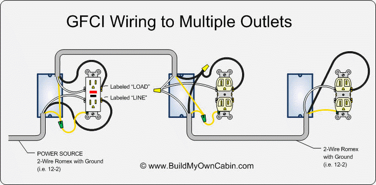

AC circuits are almost always wired in parallel. This allows the failure of one plug not to affect the rest of the plugs.
If you have a GFCI set up, the GFCI come first and the rest of the plugs are in parallel but in series to the GFCI.

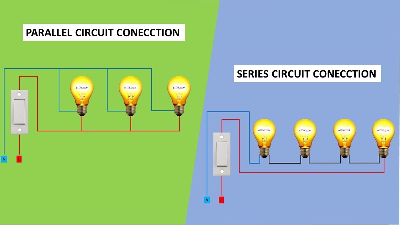

I've got to agree with @jssailem on this one but I'll go one further and say that outlets are ALWAYS connected in parallel, never in series. In series, none of the outlets would work until every outlet had a load plugged into it and then the resistance would be so high, nothing would work anyways.
With all due respect, I strongly suggest you review the theory of series and parallel wiring (AC or DC, house or boat) before you even think of getting into your own boat wiring. Once you understand the difference, hire a licenced electrician to do the work for you as this is not your specialty and electrical work is positively the "LAST" thing you want to screw up on a boat. The positively, certainly, absolutely, unquestionably "LAST" thing you want to screw up."
Except for the specific case @jssailem mentioned - all paralleled outlets downstream of a GFCI are wired in series with the GFCI.
@dhandzy - you don't need to replace all outlets with GFCI ones. You only need to replace the first outlet in any string of outlets with a GFCI, and that single GFCI provides fault protection to the entire line of outlets.
Or go further (and arguably simpler) by replacing the breaker on the main panel feeding the outlets with a RCD type of breaker. Then everything beyond that breaker has ground fault protection.

@Ralph Johnstone and @colemj - you're absolutely right about the parallel vs. serial. I was using the language too loosely and I caused confusion with that. I'm not changing the configuration from the existing setup: all outlets are being run in parallel with the standard 3-wire cables with line/load lines appropriately attached. What I'm changing is how they are fed from the source in the electrical panel. Sorry for the confusion.

My intention is to take the power in the panel into a bus bar that then powers two separate lines of outlets, feeding the starboard and port outlets each directly from the bus, just as @jssailem's diagram (reproduced below) shows. In my case, I will have two such 3-outlet lines, one on each side of the boat, where each of them has their power source (as shown on the left of the diagram below) being the bus bar I intend on installing in the panel. That bus bar would be powered by the current cable that today powers just that first outlet.

But maybe as others have said, just fit the first first outlet on the port and starboard outlet legs with a GFCI as shown in post #2. Whether you've got one GFCI only at the start of the starboard leg and one on the the port leg or one on each outlet, they'll do the job of sensing the different amps between hot and ground (~5 ma.) so just use the one. Cheaper.

Having a GFCI outlet protect downstream (parallel) outlets is an optional cost saving approach to GFCI protection.
If you’d like, each outlet could be a GFCI, with nothing connected to its load terminals. The daisy chaining would occur all on the line terminals. While this has the higher cost of all outlets being GFCI models, it also means that one tripping does not affect the others. Could be a consideration for those of us who run dehumidifiers and such in the winter.
If you do it as depicted in post #5 above, you save some money on the downstream outlets but create the ganged tripping scenario.
